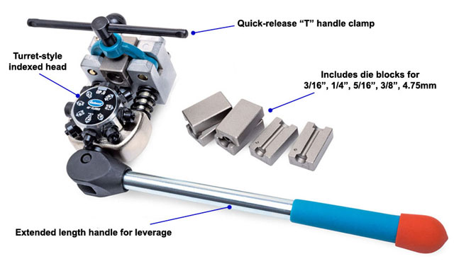

There is another option, make the lines yourself. It is not really difficult with the proper tools.
This is a great flaring tool from Eastwood and a couple others as well
A couple of bending tools, deburring tool and tube cutter and you are golden. Use wire hangers to get your forms and go for it!
