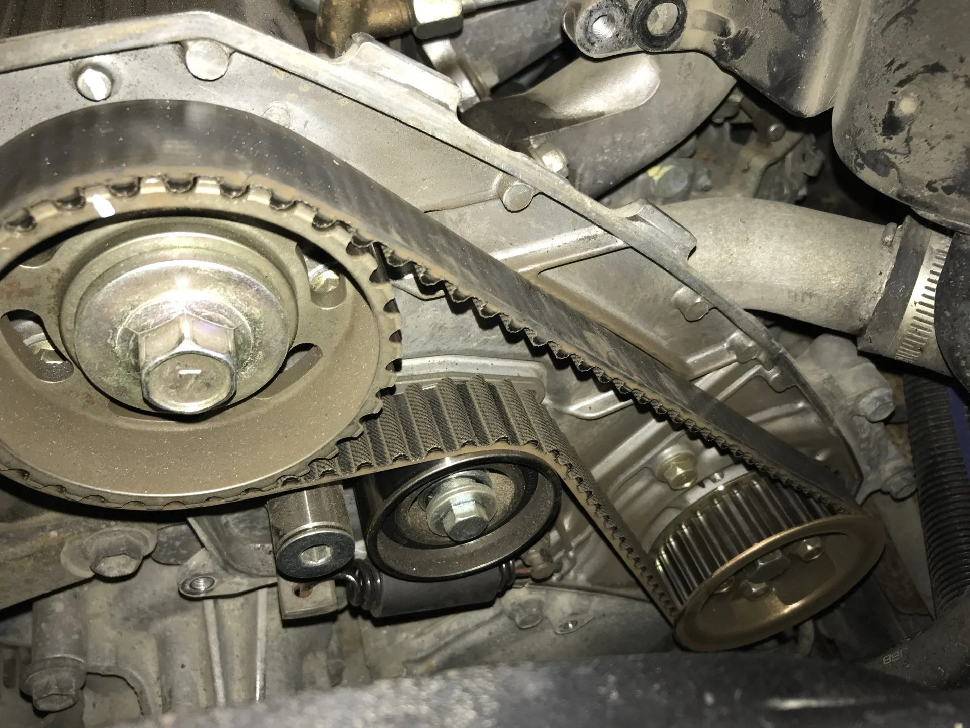

Here's the how to with parts list for the timing belt:
Only addition I would recommend is the turbo water hose coming off the radiator inlet pipe because it's really easy to get to.
This video was helpful:
Only weird thing is that post and the manual both call for removing IP pulley but there appears to be no reason for this...video leaves it untouched which is what I did.
My belt looked brand new and the water pump and tensioner seemed fine but I replaced everything anyway since I already had the parts.
There's a little button in the gauge cluster to reset the timing belt warning light (it's what the hole is for in the cover).
i made that timing belt thread and 100% agree after the fact you do not need to take that IP pulley off. it’s just what the manual told me
