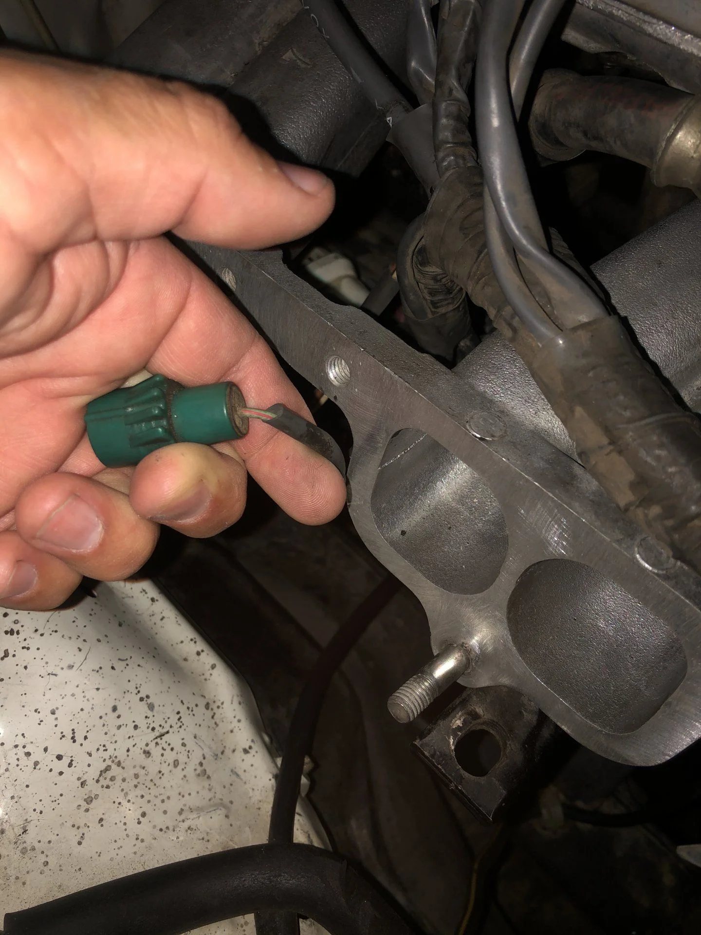

Where does this plug go? 1985 4runner 22re
Aug 18, 2014
194
1,209
Los Angeles
Cant find where this plugs into
Knock sendor?
Edit : went out to my 85. I dont see it. What color is the wire?

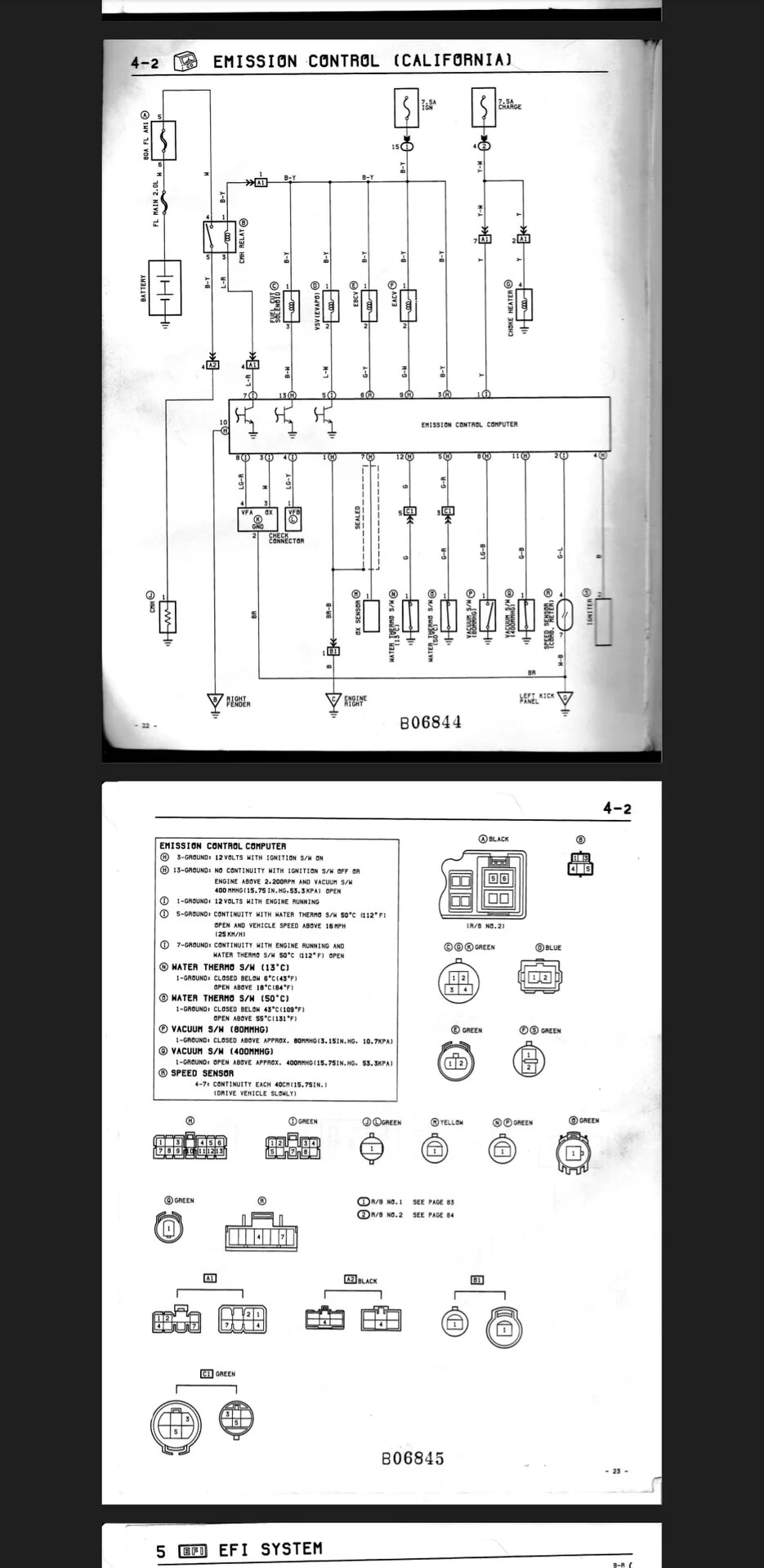

The only green plug i see in my 86 ewd says emissions plug.

knock sensor looks like the same exact plug but yellow. You can see it in the background. Sorta
mine looks like it might have been tied back onto itself based off the kink in the wire. Idk
Think its empty.

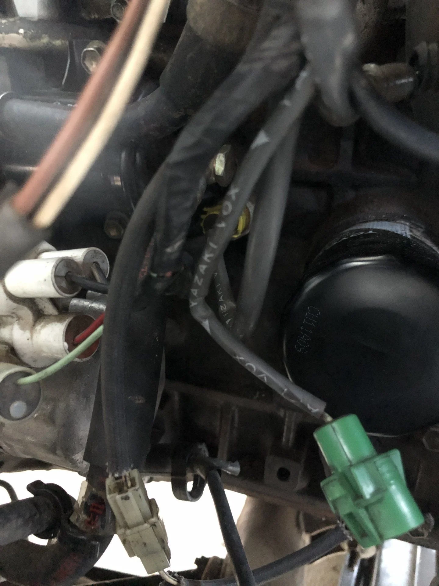

The only stuff under the manifold are, knock, oil, iac, starter. Trans stuff, but thats clearly not anything related.
Is wire green with red trace?
yeah it is green with a red lead.
I also got this mystery brown connection icant seem to find a home for.

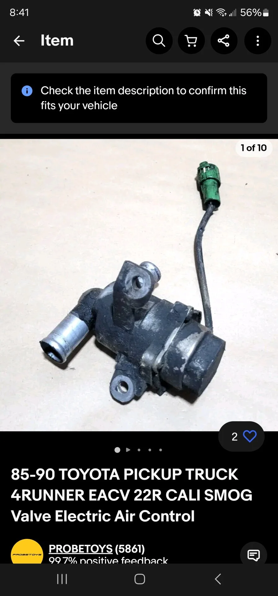

the plug and wire color match this water switch for emissions.
Mine already has 2 one up top and one below with different connectors, wonder if it's for a 22r seeing as mine is a 22re . It's weird, I thought it was for the egr sensor since mine is broken off but after buying one and looking around they all have a grey square plug.
