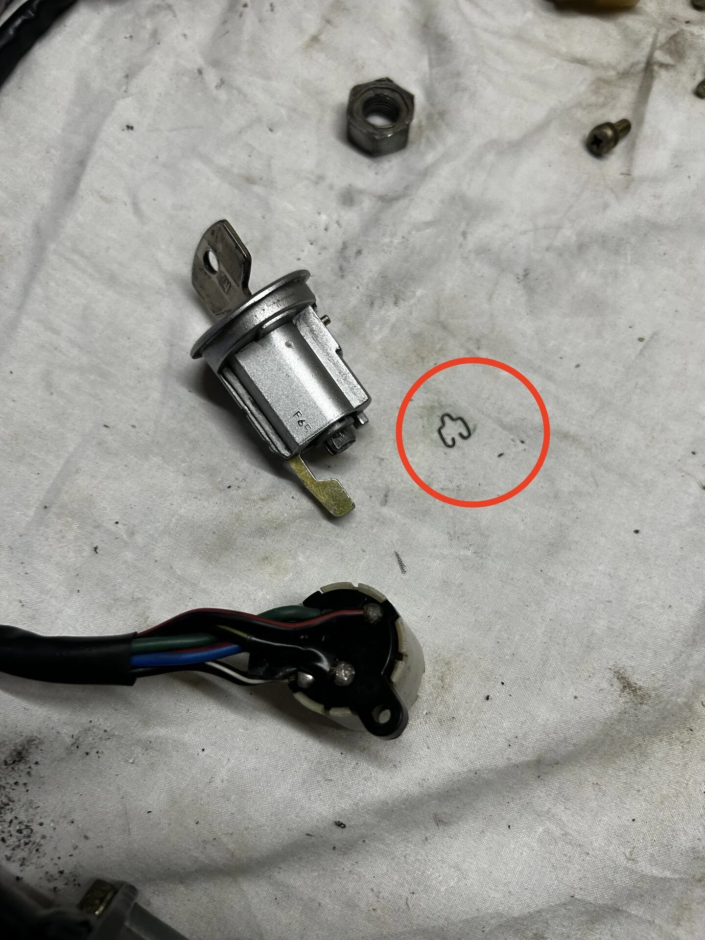

I use to make pictures of everything when taking all apart but here I missed one... It was stored in the back with the starter switch but I have no clue where it goes. Does anyone of you have an idea? BJ40 1977... Thanks!
goes in the column and hold the piece that goes in between the switch and into the key on the opposite side.I use to make pictures of everything when taking all apart but here I missed one... It was stored in the back with the starter switch but I have no clue where it goes. Does anyone of you have an idea? BJ40 1977... Thanks!
First of all thanks for answering! However I read it a few times but cant figure it out. What piece goes in between the switch and the key? Do you mean the electrical part of the switch?goes in the column and hold the piece that goes in between the switch and into the key on the opposite side.

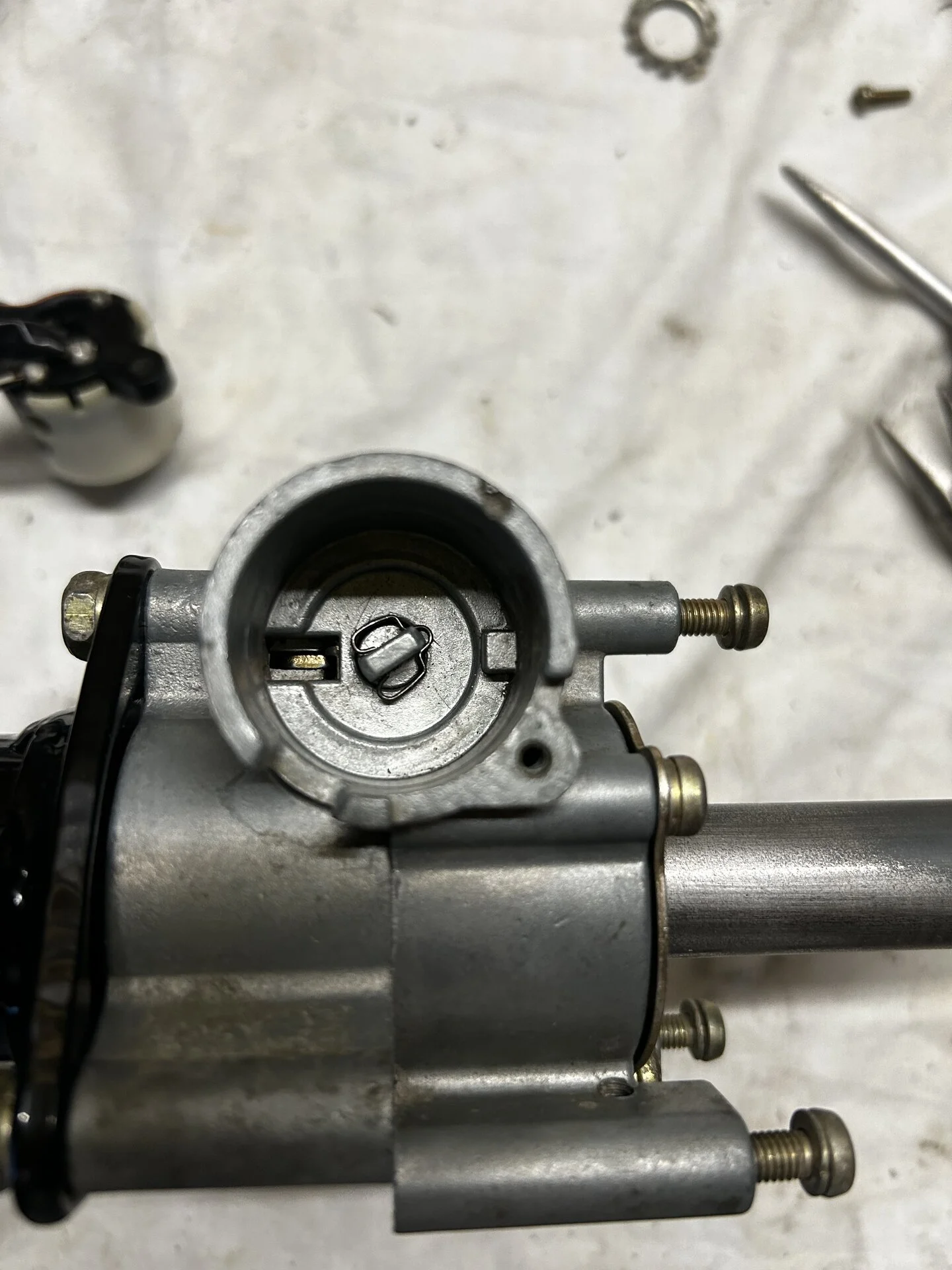

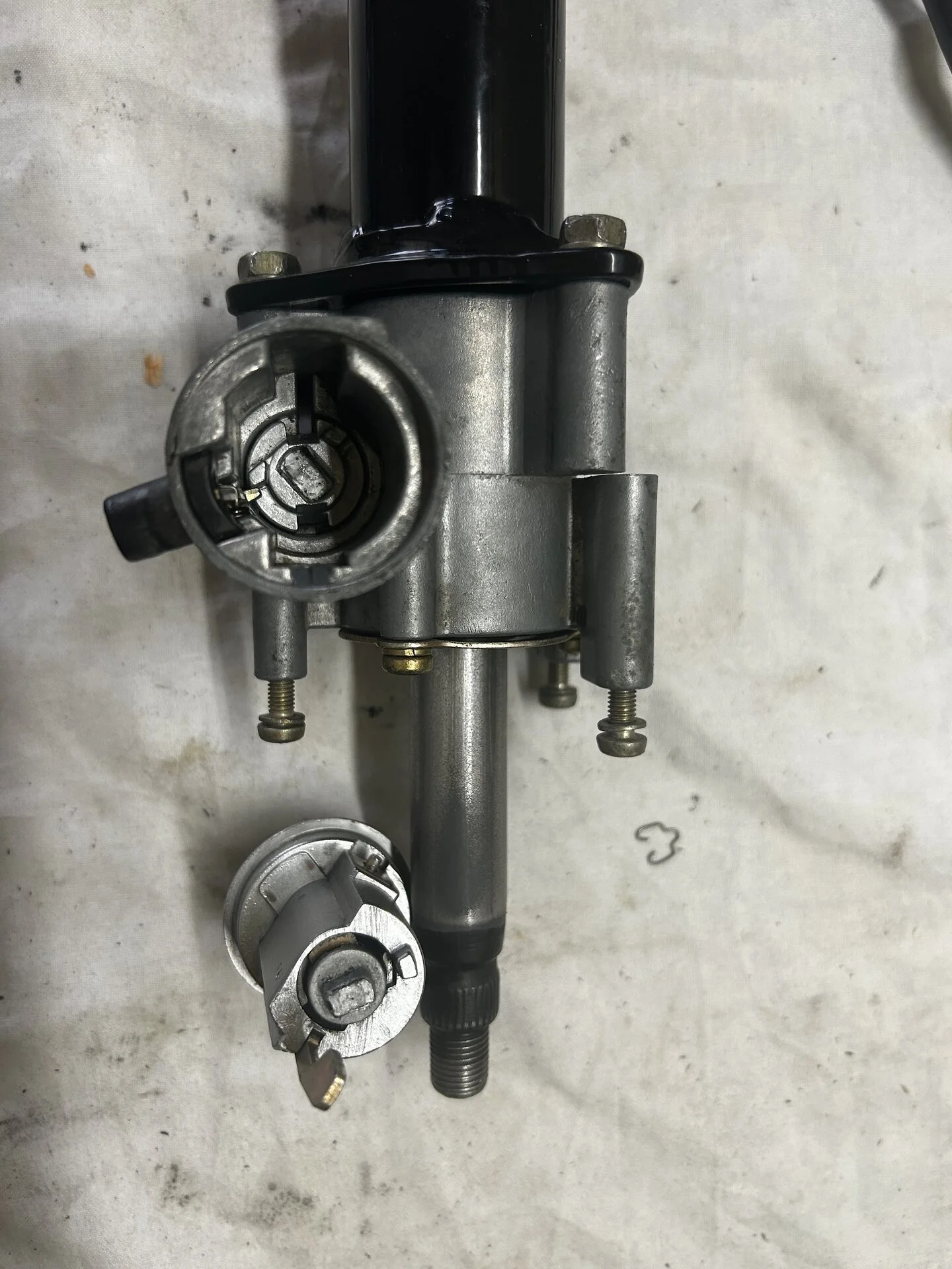

Yes, look in the other side of the column, goes on that center piece, on the other side. Wish I had a column apart to take a picture.Perhaps you could point it out?
So like this, can't be anything else...Yes, look in the other side of the column, goes on that center piece, on the other side. Wish I had a column apart to take a picture.
