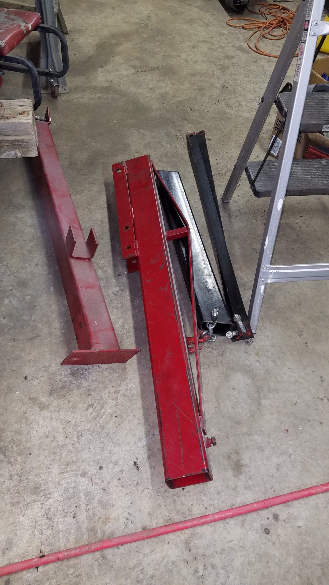

So no actual progress on the rig since last post. Instead I've been spending my time building a rotisserie. Started with a couple Harbor Freight engine stands and my old 3 ton engine hoist. The HF stands are too wimpy (IMO) to make the main parts of the rotisserie. However the engine pivot is pretty stout and I was able to use some of the stands to compliment the hoist bits.
There is still some final bits to make and gusseting to put in place, but the primary bits are there. The lift is being handled by two 2000 lb tongue jacks. That's the only part of the design that I'm not sure about. If they flex too much I'll scrap them and make some jacks out of threaded rod and a length of 2" and 1.5" schedule 40 pipe. But the CoG is going to be a lot higher than where the hanger is currently, so the stand is going to be retracted at least 6 inches, leaving about 4 inches of the inner tube exposed. So I'm hopeful it will be strong enough once the body is raised.

I would highly recommend linking both end of the rotisserie together to combat the middle of the truck pulling trying to flex downwards.
working on a project right now and had it on it’s own weight started to cause minor figment issues on longer panels due to minor sheet metal flex over a long span. Probably not as big of an issue on a roofed truck like a 60 (this is a convertible sports car) but you are going to be cutting a lot out for awhile.
Yep, that's the plan. I've got some 1" schedule 40 pipe that will be inserted in the ends of the undercarriage legs with pinch bolts to secure them in place.
