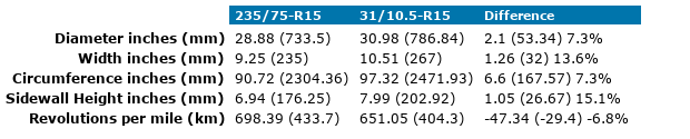

Is there a large performance benefit to 31s over the factory 235/75-15 sizing? I know on road is better with the smaller wheels, but maybe air down performance off road suffers? They make KO2s in both sizes.
Use the above link to check size comparisons. And keep in mind BFG AT's tend to run a little smaller than advertised sizes (for example, a 31" tire will be a little bigger than 30" or something like that)
When going larger, you'll want to keep your gear ratio in mind. My buddy with a stock FJ60 prefers 29" or 30" tires with the stock FJ60 ratio, whereas with 4.11 ratio as factory on my FJ62, 31" seems to be a pretty good size.
I wouldn't necessarily say smaller tire "air down" performance suffers off-road, but as @klinetime574 pointed out, the smaller diameter does affect the clearance for everything: axle tube to bumper, and from my experience, the rear overhang on the wagons is the real issue.

Ah, the the final drive is different on the FJ62 as opposed to the FJ60. I guess that explains why I’ve seen some folks stay stock sizes and some bump to 31” like mine with minimal issues.
