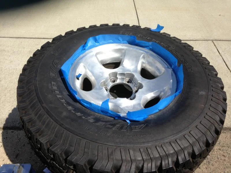

3. After I stripped the paint and clear i used Xylo (Xylene) to wipe the surface clean to degrease it. Clean the corners that the stripping wheel could not reach. Leaving old paint chips will cause issues later on. Tape or use index card around the wheel edge.

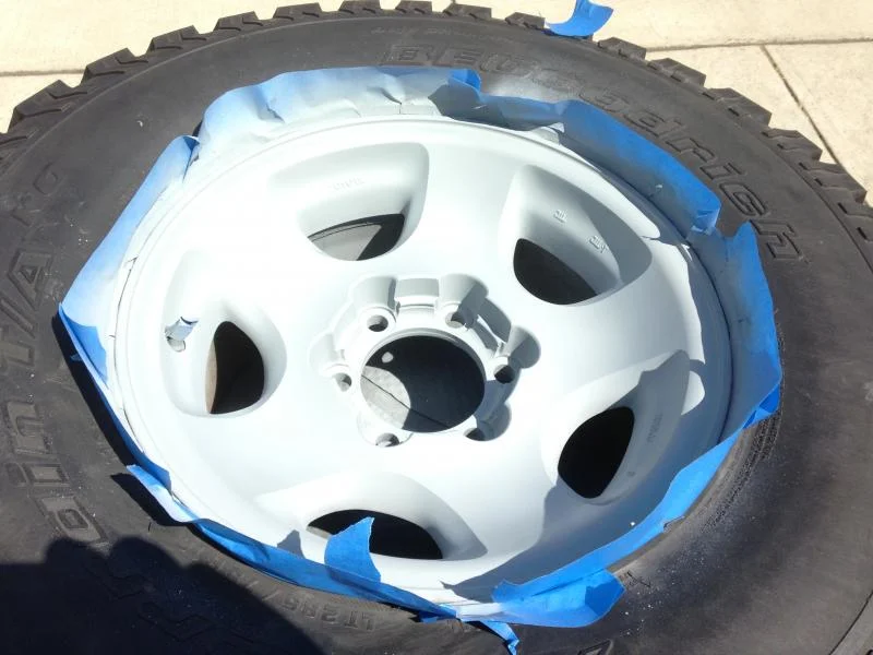

4. Prine, I used 2 coats of sandable filler primer. It's by Rustoleum. Don't use heavy coats. Use light firs coat and medium light 2nd coat. It is very important that you let the primer dry at least 2 hours. This hardens the filler/primer to a nice sandable surface. After sanding with 3M red or grey pads you can use a tack cloth to remove the dust. Don't hose off.

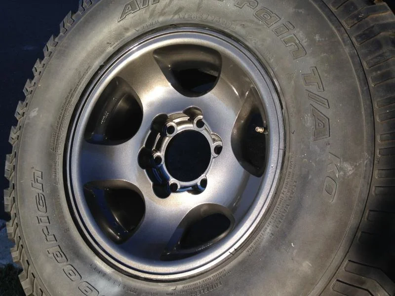

5. Topcoat - I used Dupli-Color High Performance Wheel Paint in Graphite. This stuff is amazing. apply a light coat wait ten minutes and a second coat wait 10 minutes then a final medium coat of paint. Then Clear coat if desired.
6. Clear Coat - I decided to clear coat the wheels as the top coat and clear didn't have too much of a difference in glossiness but it was noticeable and i think will help cleaning the wheels. Use the same wait time as above for the clear coat.

Pic 3 - prepping for primer
Pic 4 - Primed wheel

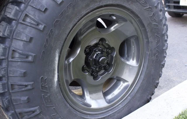

Pic 5 and 6 - final result
Pic 7 - Installed and on truck, painted the hub gloss black for a nice contrast.
