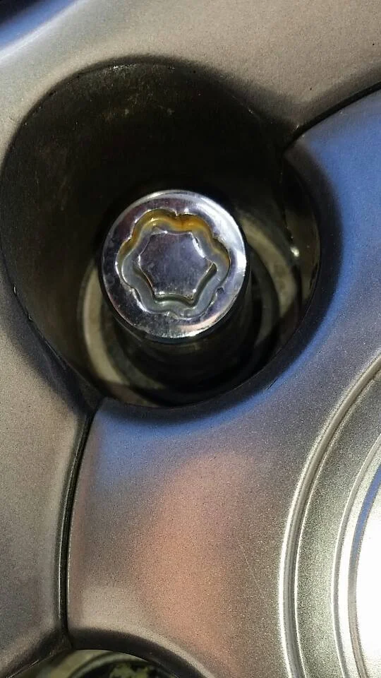

When i bought My GX ... after getting home i realized two things
1) no owners manuals
2) there are locking lugs on my wheels and I have no key to remove them
... I can buy new manuals no problem
But is there anyway to find out what locking key i need to get the wheel locks off ... its an OEm part as im sure many of you know but there are dozens of patterns ...
is there any info i can find on my vehicle to figure out what lugs i have or do i just need to visit a dealer and see if they have one that matches? ...
Im sure some mechanic probly stole mine for his tool box at one some point...
PS ... I know the tricks to get them off without the tool ... I just like the Fact that its an OEM part that belongs with my vehicle ... just as if a tool was missing from my OEM tool kit ... i would find the matching tool to complete it ... cuz im weird like that ... but im not loosing any sleep over the issue
The factory wheel lock is made by McGard and you can't get a duplicate key unless you have the code that comes with the packaging as a sticker. Look in the owners manual for this sticker or some affix it to the inside of the glove box. You can probably order a replacement at the stealership for cost.

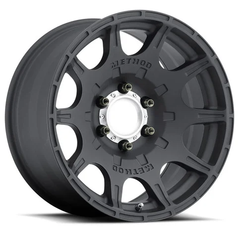

Orion ... thank you sir thats awesome of you! I'll probly be taking you up on that offer ... I do have set method wheels coming so now I'm thinking they may not work on them lol
Ha...yeah, I think you'll need new lug nuts for those wheels.
I'm happy to send 'em if the OEM lug nuts will work, but I think you'll need acorn-style lug nuts. I use the Gorilla splined lugs.
Post pics once you get them on the truck...!
- Brian
yeah i think your right ... I had the splined lugs on my last truck ... im gonna start a Build Thread once I start bolting things on
Yup I run Methods, you need aftermarket acorn lugs for those wheels, the oem ones wont work.

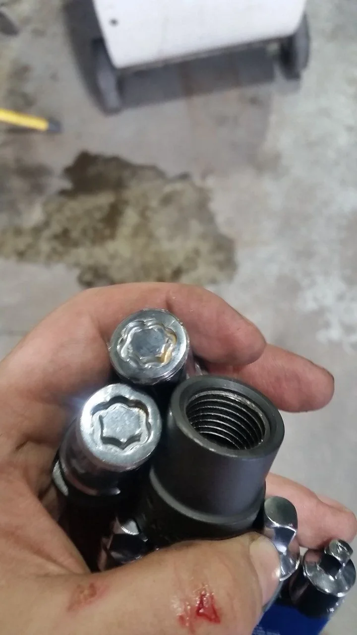

Thanks BlackUSK56 ...That is what I did to get the rear off ... but knocking out the lug wasnt happening ... I actually used a 19mm 12-point (couldnt remove the lug) & and a 20mm Hex (also still stuck) ... havent done the front yet bc I ran out of donor sockets lol ... and i didnt use a deep socket i used standard so maybe thats why its hard to get out ....

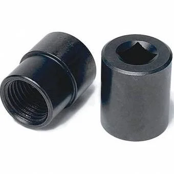

UPDATE:
GOT'EM ! ... this tool worked great wish i would have had it a week ago ...
So the verdict is if you loose your key and don't know what your code is .. and the mechanic shop dont have the special tool... go to auto parts store and spend 10 bucks ... buying a replacement socket that you ruined by hammering on cost about $4 ... and You will need an impact to get it to bite
