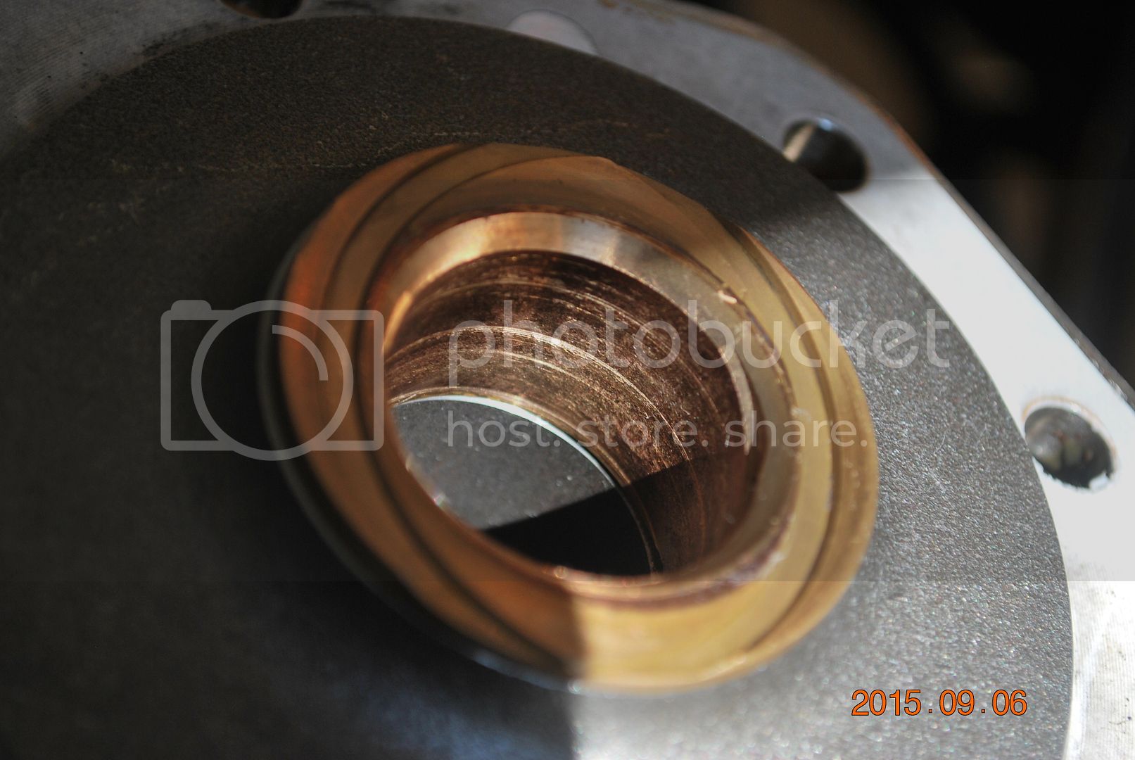

Check that the spindle and bronze bushing were sufficiently greased...happened to me after a rebuild.
This bushing? Isn't it pressed into the inside of the spindle? I don't recall and separate bushing from either side when I was rebuilding
Yes to pressed bushing, I believe you can buy them separately if needed though - seems spindles were ~$200 ea 5yrs ago. Real Yota ones.

Figured I'd take a picture for a accurate idea. Is this enough for the knuckle? And I took the spindle off, bronze bushing was dry so I put some grease on it. Cleaned and regreased outter bearing. I think I'm gonna just put it back together and see how it does. Btw, I'm using valvoline moly for the bird & knuckles. And Valvoline multi-purpose for the wheel bearings
That has maybe half the moly grease that it needs. If it were at the correct level, the bushing would self pack.

Both knuckles are majorly under greased than. Hard to tell exactly how much I'm putting in since I'm using a 14 oz tube in a grease gun filling through the plug on the top.
Both birfs are majorly under greased than. Hard to tell exactly how much I'm putting in since I'm using a 14 oz tube in a grease gun filling through the plug on the top.
Remove the plug, clear the skin of grease from the opening, look into the hole, the spindle bushing, most of the ABS ring should be covered with grease. When low, this isn't a one time deal, check, add some drive for a 100mi or so to allow the grease to settle, check and possibly add, repeat, until the level is correct. Should be ~1/2-3/4 full.
As it ages, can often get an good idea of grease level by glancing at the balls. The wipers weep grease, then push it into a line on the balls. So where the knuckles are full of grease will make a thicker line of grease, almost none above. This one is way low, should be leaving a line to the top of the axle.
Yes...grease the s*** out of that bronze bushing and the axle that slides through it. Not sure if this is your problem, but it sure cured the grinding/whirring sound mine was making. Mine had small grooves in it when I pulled it.
