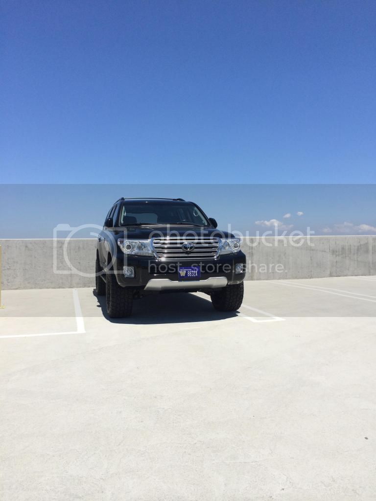

Just for reference, here is a pic of my OE 18" Tundra wheels on my truck:
Resurrecting an old thread. @MScruiser, I found a set of these wheels locally. Any issues mounting them to your rig? How is the offset? Thanks!
No issues. Plug and play.
