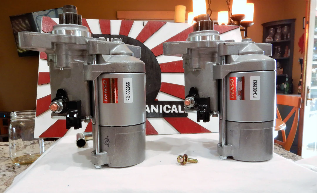

The solenoid on my 96 is getting buggy. It occasionally will pause and then start. I've been ignoring it for a while, but I had my first full-on no start situation last week. It was a hot day, and it was heat soaked from a long drive. I hosed the whole thing with contact cleaner (not for the designated purpose, but for the evaporative cooling), and it fired right up, but I figured it was probably time to deal with it.
Since I know there was a 2.2kw option, I thought I might see if I could find one. Since RockAuto shows the Pure Energy rebuilt 2.2kw, I figured I'd try it, tear it down for a thorough inspection and re-rebuild if necessary (the parts still seem to be available). Well, the website says it's the 2.2kw starter, but it appears to be the 2.0, and NOT the 2.2 version. I looked carefully at that picture that someone here took forever ago, and there's no real question. What they sent me is physically the same size as my existing 2.0 unit, doesn't have that nose on the shaft and the gear has ten teeth.
80-series-starter-comparison-1-4kw-2-0kw-2-2kw-webp.3278160
Look, I'm sure the 2.0 is fine, but I was hoping to get my hands on the larger one, and I'm aggravated at RockAuto for falsely labeling it as what it isn't. I'm probably going to send it back on principle, simply because they didn't send me what I ordered. So, does anyone have a source for a rebuildable core, or is it just a matter of stumbling on one in a junkyard?
