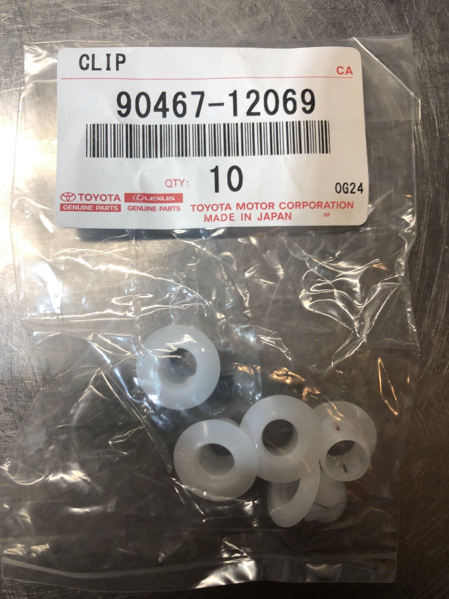

90467-12069 - If you can remove one without breaking it, it's a miracle. I keep a bunch around just for that reason
If you can find the correct inner diameter sleeve to fit over the part that protrudes into the engine bay you can sometimes depress the tangs without breaking them. But yes they are brittle but cheap so I just keep some sitting in the small parts inventory along side the oil drain plug gaskets.

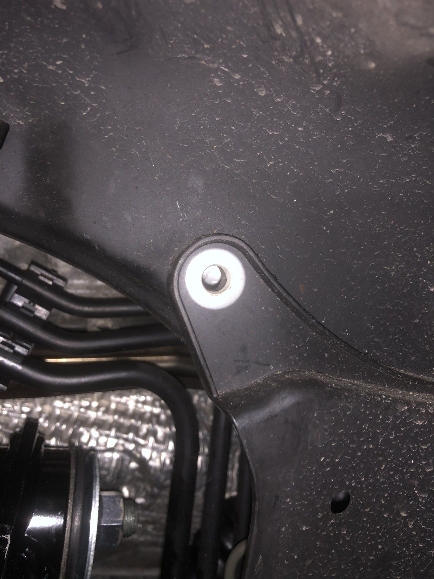

An example of the fastener as installed:

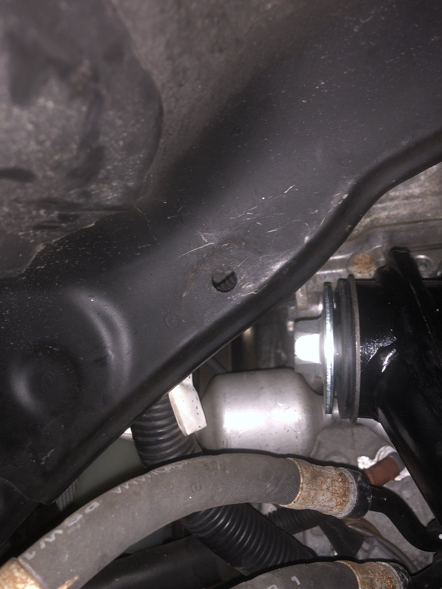

The hole it mounts into (~10mm):
This part will get trimmed before it goes back on to make clearance for the reservoir hose.

@CharlieS they are some really good clips, probably my second favorite of all Toyota plastic clips. I reach up behind the splash guard and can squeeze the tabs, and they come out just so easy and gentle. Still, I keep a big bag of them around the shop because if I ever see a 200 come through here that had suspension already done, it usually is missing some clips (or the whole slash shield). So I just add what is needed to make it right, too easy.

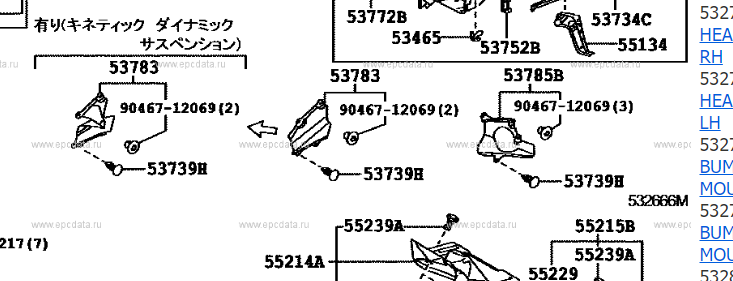

What are the part numbers for the actual splash shields?
It's these, I think. This is from epc-data.com. I'm actually missing one on my driver's side, but I can't tell from the online images which one I need. If anyone has a few pics of their driver's side inner fender please post so I can work out if I need 53783 or 53785B as I'm too cheap to buy both :p
I’m pretty sure those are the same. 90467-12069 is what you’re looking for.
The following numbers are for a 13 cruiser, but most years should be similar.
Driver side in front of the spring perch: 53782-60040
Driver side behind: 53784-60080
Passenger side front: 53781-60020
Passenger side rear: 53783-60090
Note that the front left part is shaped different between LC and LX to make room for KDSS parts. The number for a LX there is 53782-60020
For the record most toyota numbers will be ten digits, possibly 12 or 13 for things like interior trim parts with multiple color options.

Thanks @bloc. Looks like 53784-60080 is what I need for my '13.
