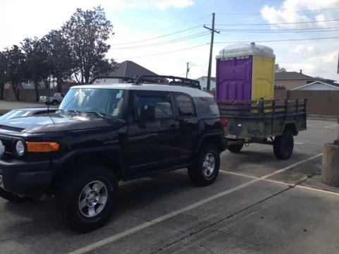

the two 12v outlets are installed just not wired up yet. Will work on that tonight as I work on getting the trailer hooked up for the parade.
