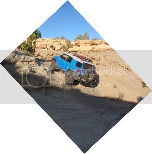

I know exactly what I did and when to blow mine - going up Wipeout Hill off of the Sevenmile Rim trail near Moab, with the rear diff locked and I hopped the rear end when I gave it too much throttle on a super steep section.

Here's a photo of the run up Wipeout Hill that did mine in:

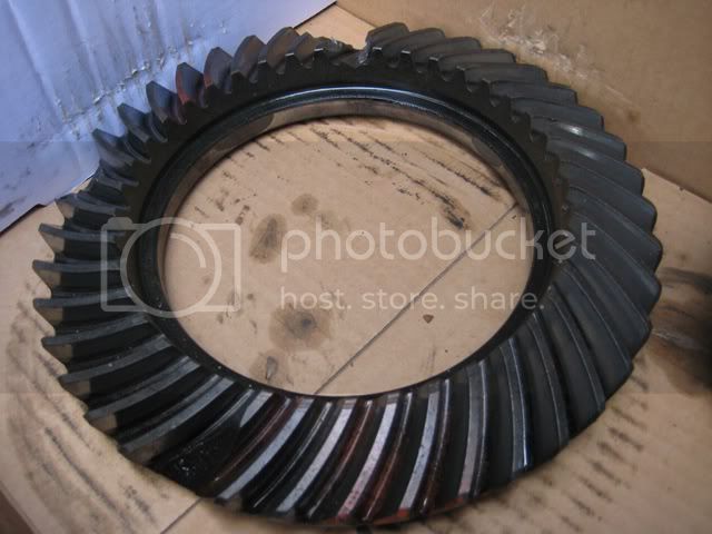

It started making noise right away, but amazingly, I wheeled another couple of days around Moab (with a group) and drove it home more than 1,000 miles! Drove it to the dealer and back when I got home; finally tore it down and found this:
5-6 broken teeth in three different places! It was amazing that it drove as long as it did. It was pretty noisy by the time I stopped driving it.
