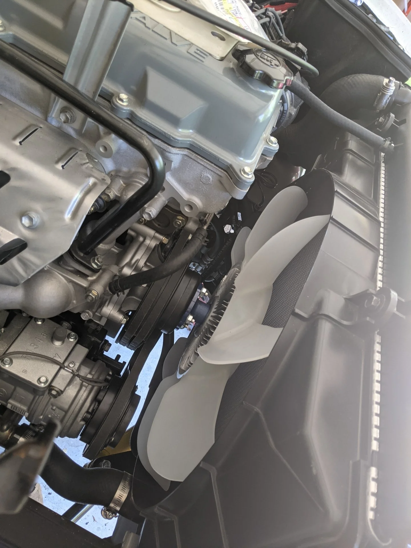

On the list of "everything" to replace, you put fan blades. Do they wear out over time? Do you mean just replacing with OEM fan blade?
Was looking at the clearance between the shroud and the fan, and there is a full inch of radius, so is there an upgraded fan blade that I could pop onto my blue modded clutch that is either more radius or steeper angle of attack on the blades, either/or resulting in more airflow?
Thanks in advance for the help, as a search of Mud wasn't leading anywhere till I found your list.
^^^ Fan itself can easily be brittlized, it is ~25 yrs old & if you toss a blade, no bueno.

I picked up a new Denso fan from Rock Auto believe it or not...
