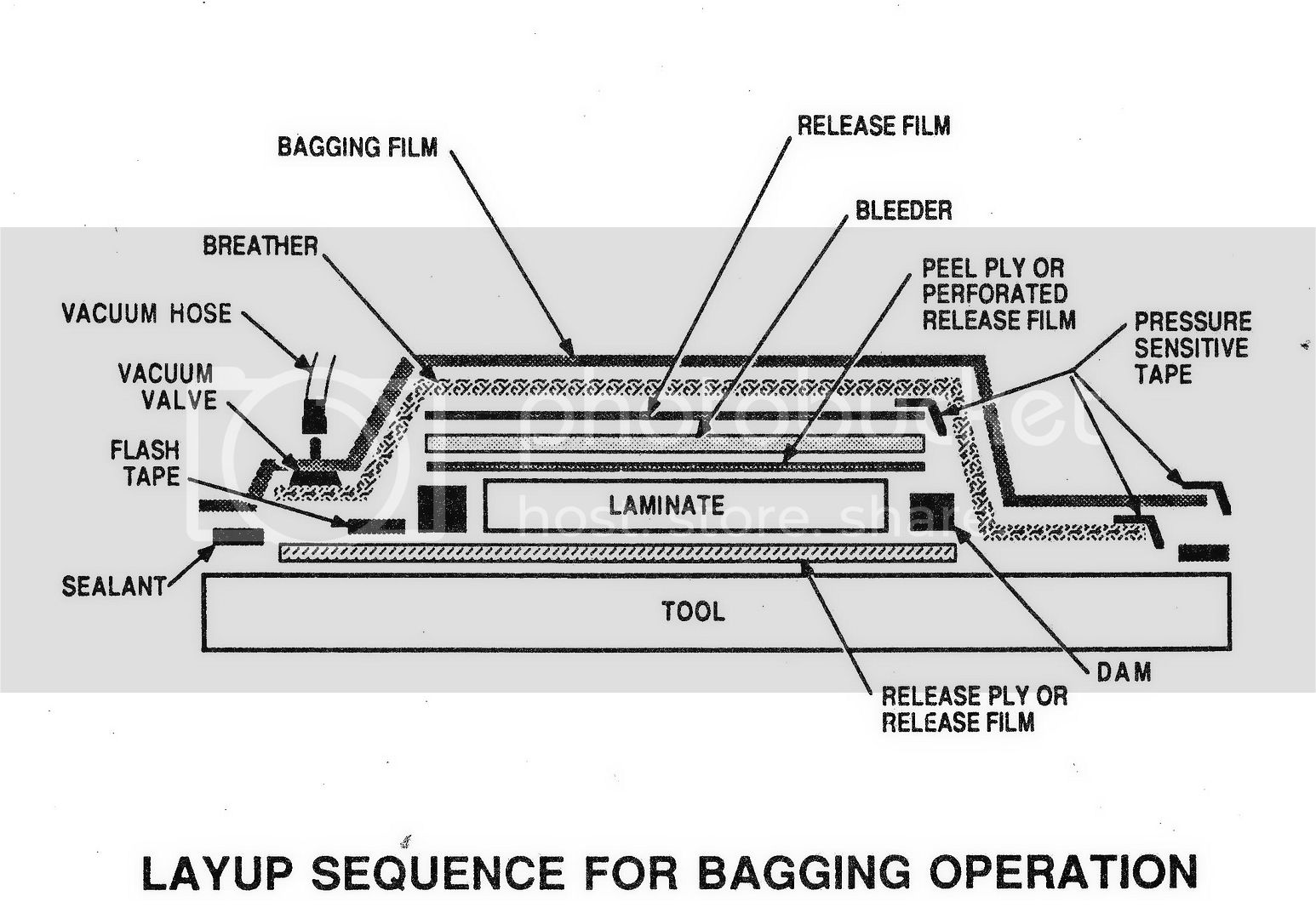

Here is a pic that might help clear the confusion.
Sorry so big. You use special 3M tape to seal a piece of plastic bag over the top of the dash cap and old dash with the wet rtv between the two. You can get a vac attachment that locks through the plastic bag air tight then just pull a vacumm on the bag it will pull the new cap tightly to the old and let rtv cure before removal. Your dash will have a perfect even bond. I use this method at work on composites all the time. Well its just an idea, maybe more work that its worth. :beer:
