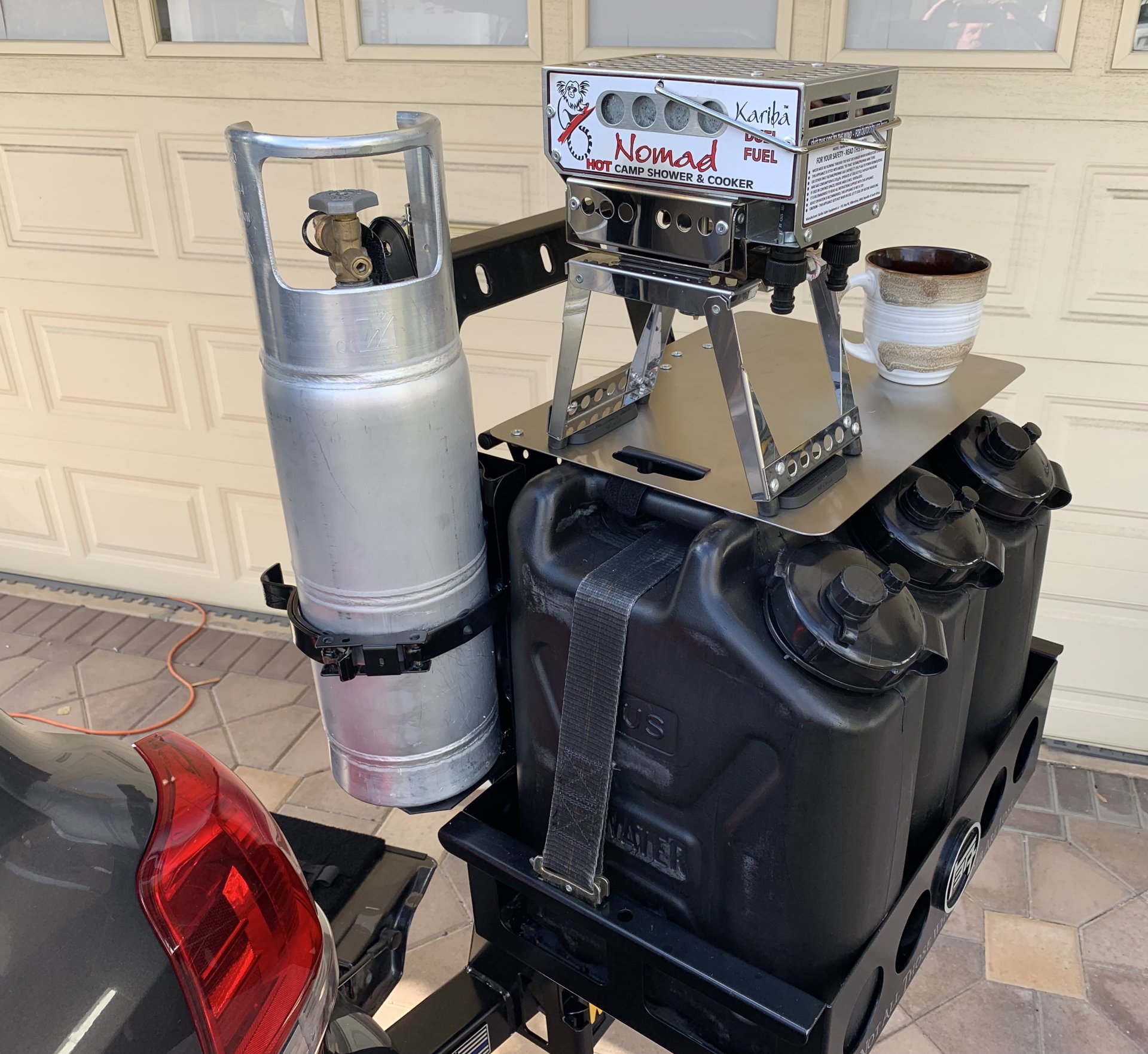

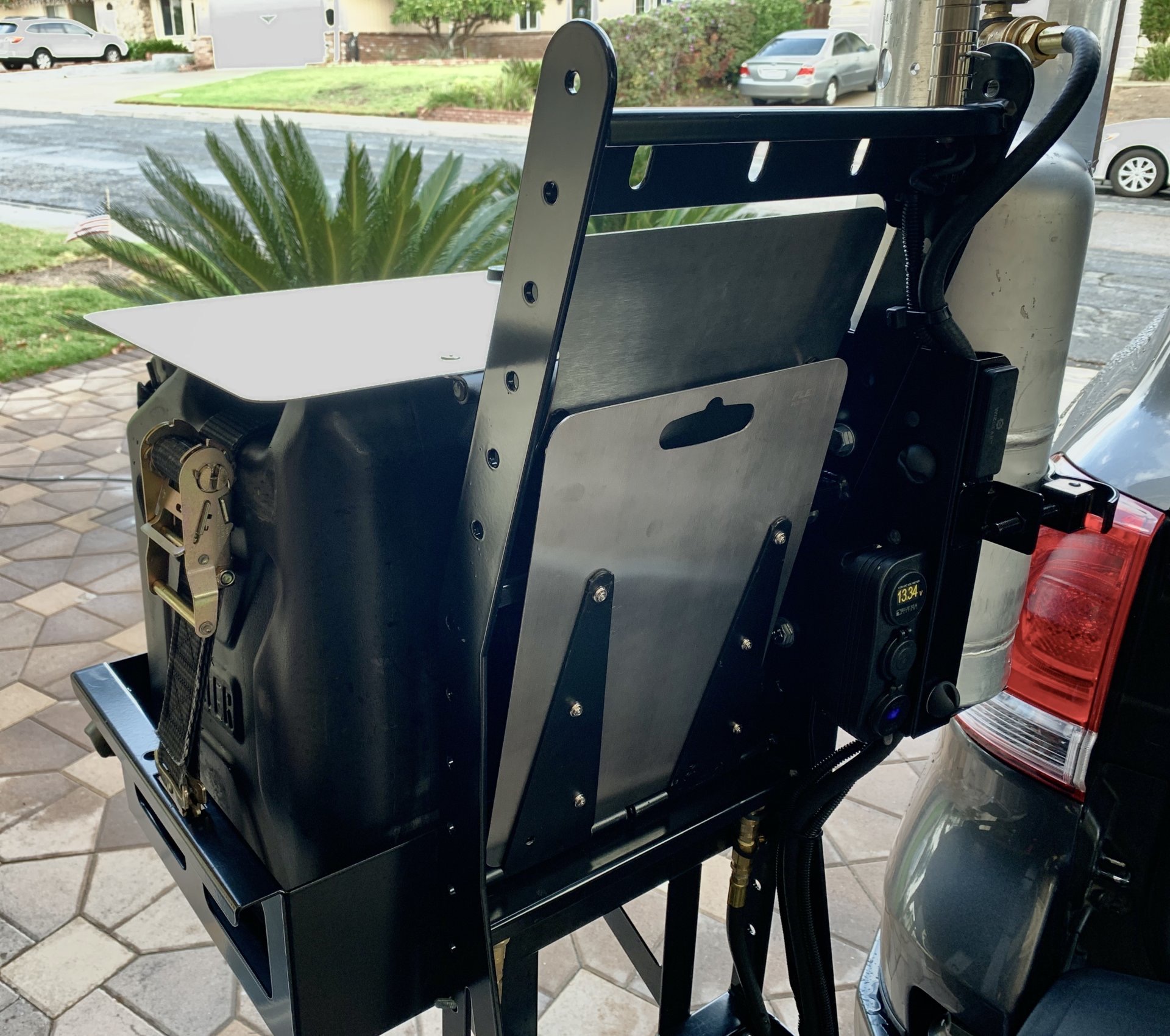

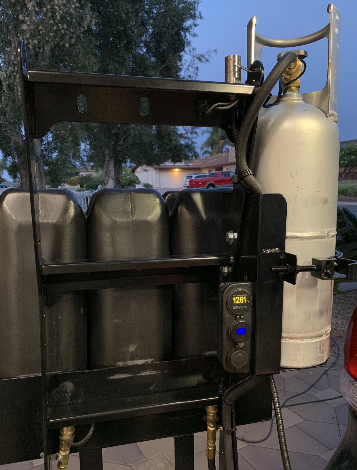

Here’s some of what I did with mine…
—All of which depend on the ladder structure.
** I have an Aux tank too. These are for *water.*
Some more…

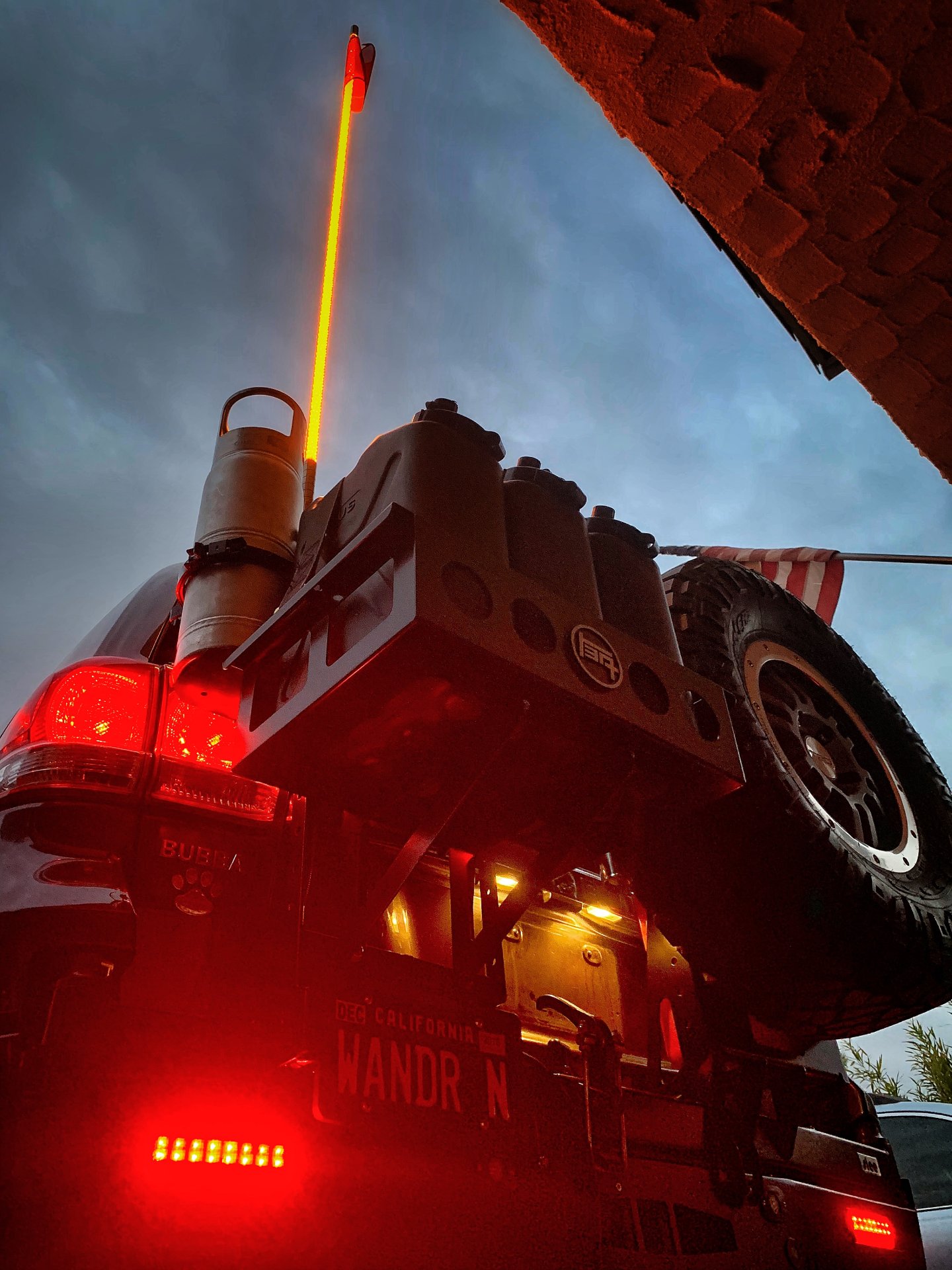

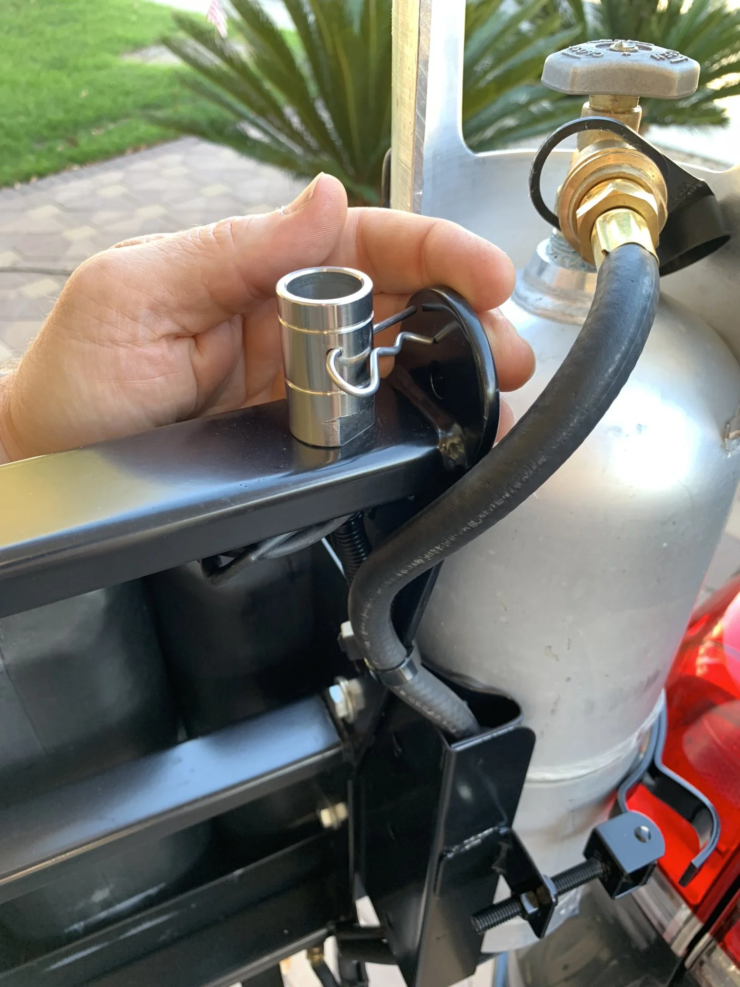

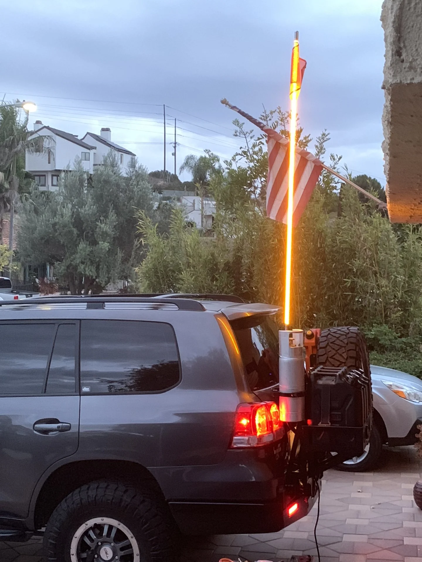

Can’t see the mount here, but my desert dunes lighted pole mounts to the top of the Slee ladder.
Here you can see the pole mount, and the propane qyick release setup (where I connect it to the tank)…

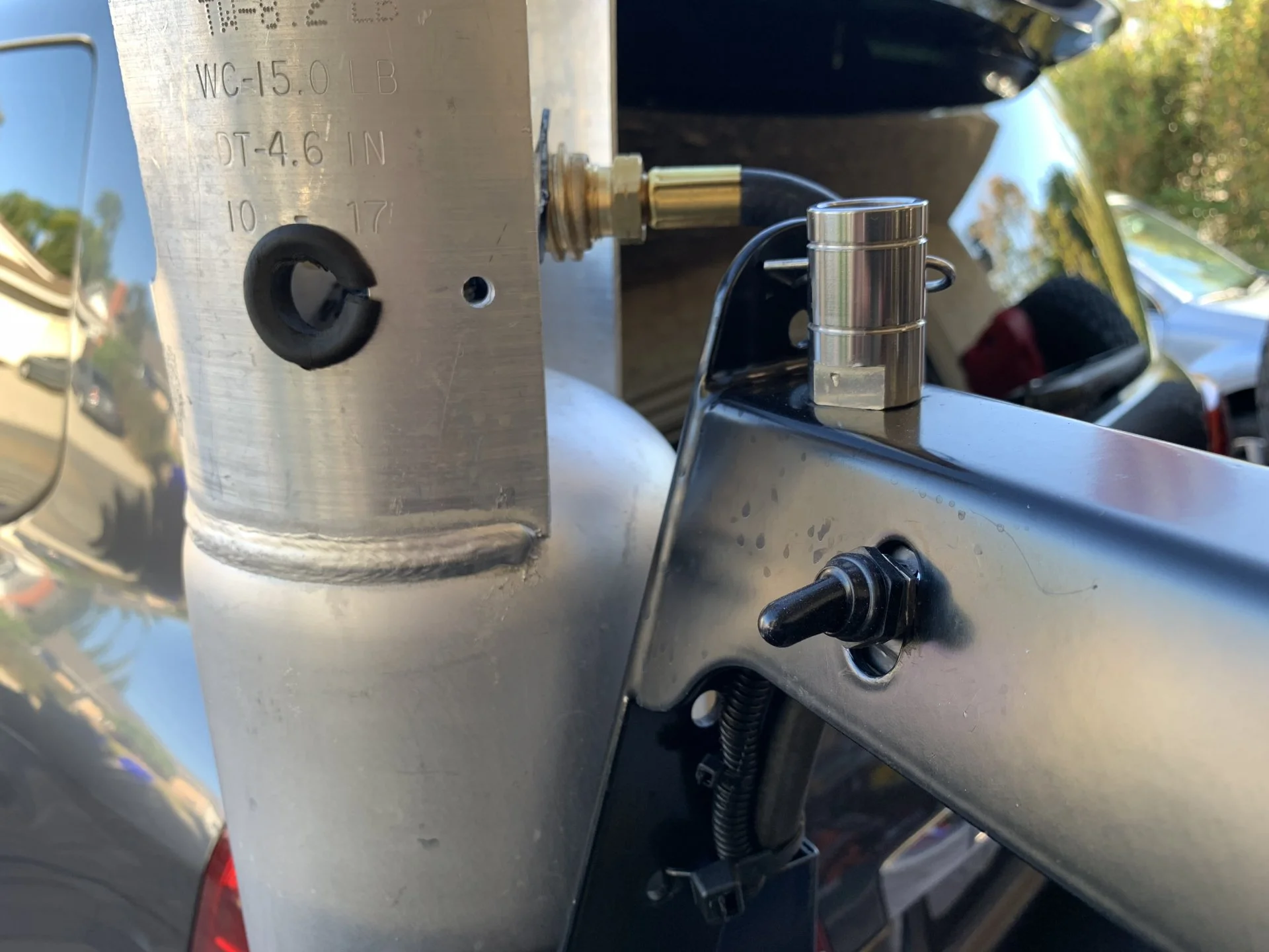

Here you can see the power switch for my Buggy Whip quick-mount on the too rung…
More on propane quick release for water heater and stove use:
Here’s another of the Buggy Whip… If you hit busy dunes after dark, this is extremely helpful. Most desert buggies here are running at least one. Scary without them:
Anyway… As you can see… Its not just a ladder. Its really a platform for customization.
Buggy Whip.
Not cheap, but very well made.
All different lengths, colors, and mount iptions.

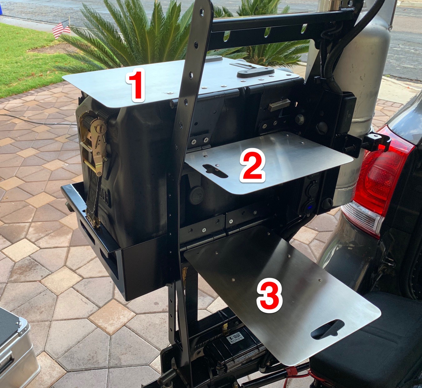

I take it those three trays are a custom fab?
Thanks, Markuson!
I knew you had the three jerry cans, but forgot about the other items you added.
Great ideas.

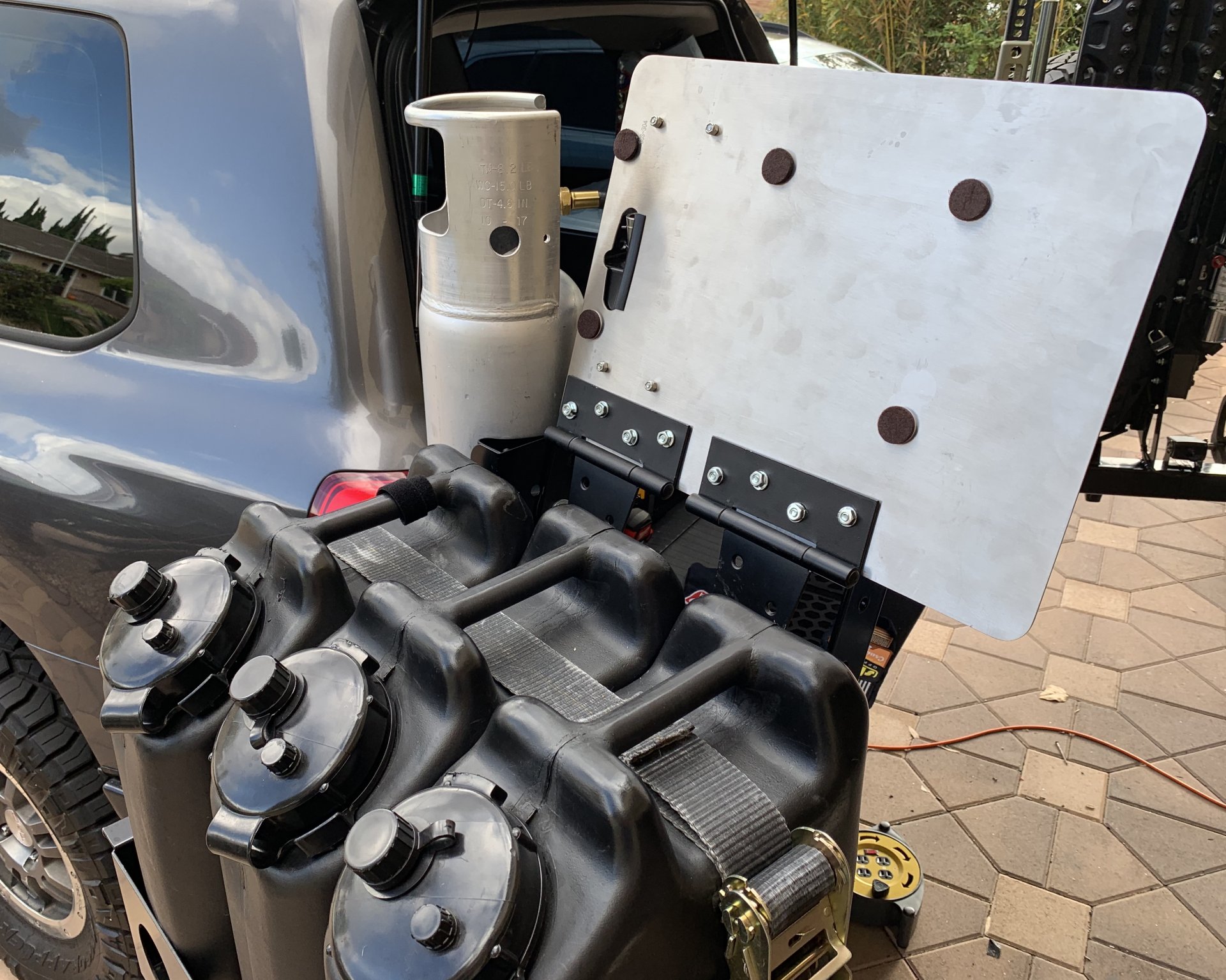

I concocted those shelves & work really quite well. In camp, they clear the hatch when deplloyed so no need to fold up. They stay folded up via gun magnets, and stay in place on crazy without a latch etc. so just flip up and secure.
Very nicely executed - I like the switch panel... How did you execute the wiring past the pivot at the bottom?
I ran wires inside a tube just like the one Slee runs to power the license plate light…then down…and then up the bib below the left/rear panel underneath.

That’s a fantastic setup. I love the amount of flat surfaces. You never realize how much stuff you need sit down until you need to sit it down in a muddy situation
Ya, when you use drawers in back…it’s nice to have a place to set things other than the tailgate, since open drawers need that clear. Great for food etc while accessing…and just in general. Also usable with hatch full closed dtc.

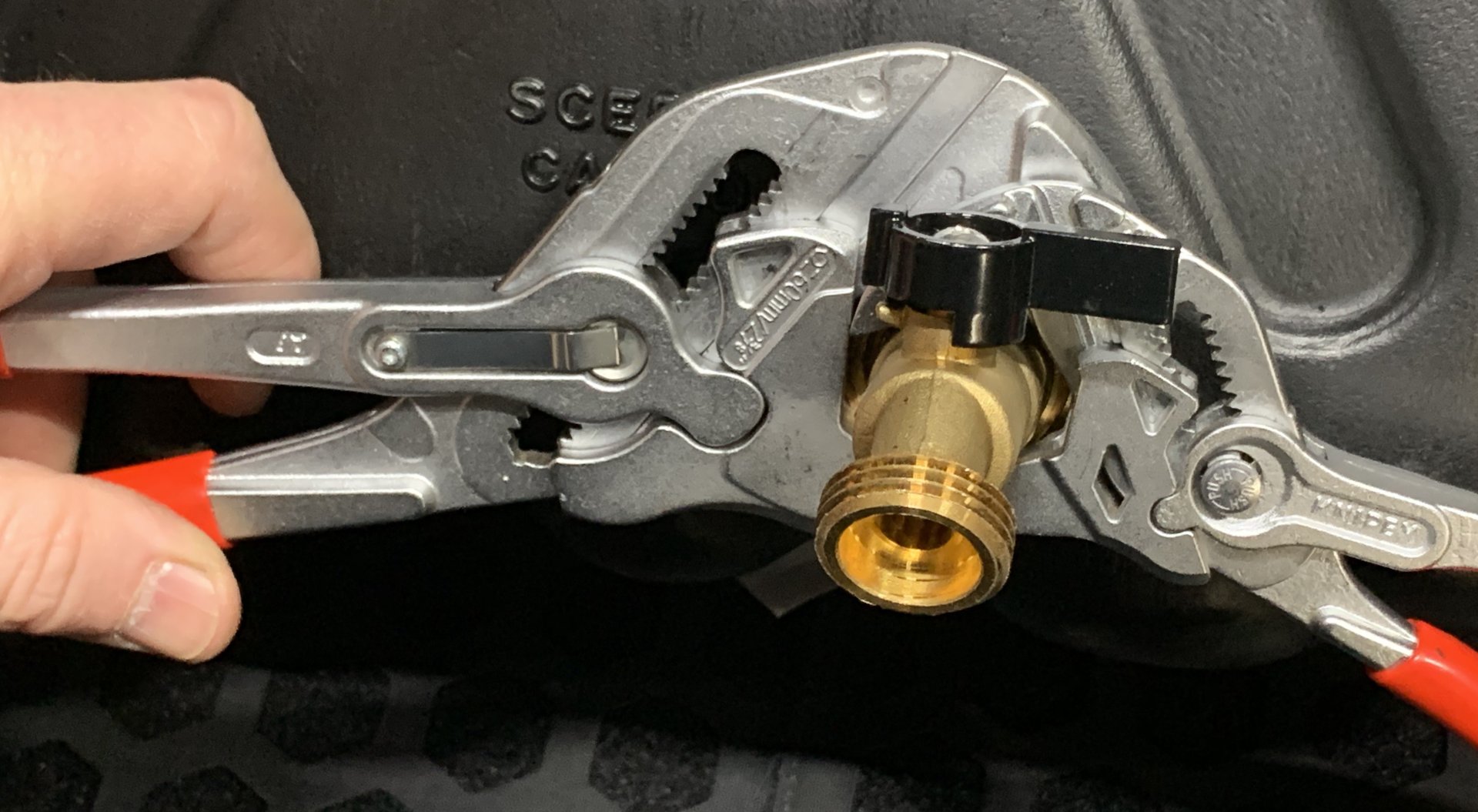

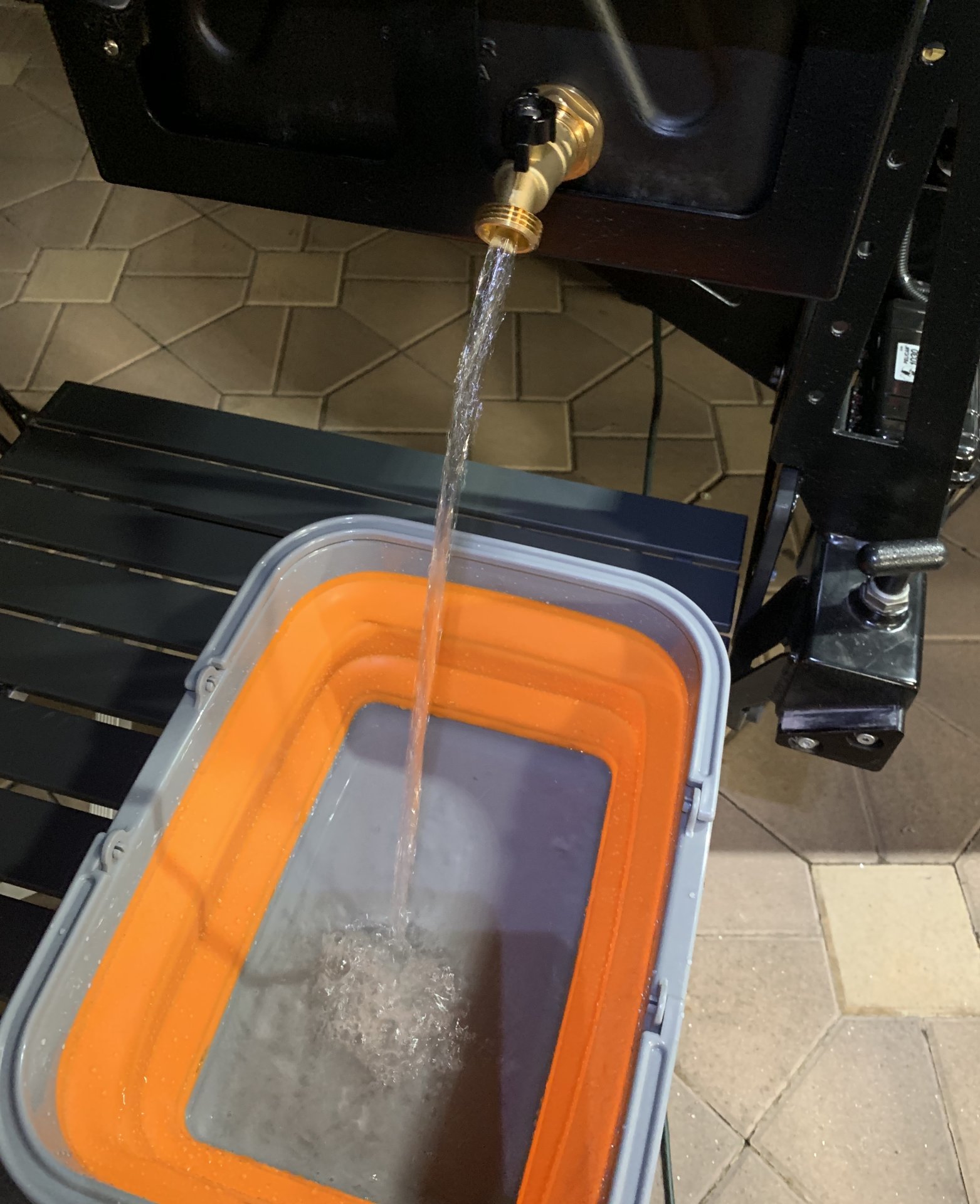

Other uses come in handy though…like an easy wash station at a work site. Before my dog was killed a couple yesrs ago..we used it to wash salt water off after local beaches. Works a charm with the faucet I added. Highly recommend the faucet tweak. No pumps required. Gravity works well. Easy to regulate flow.

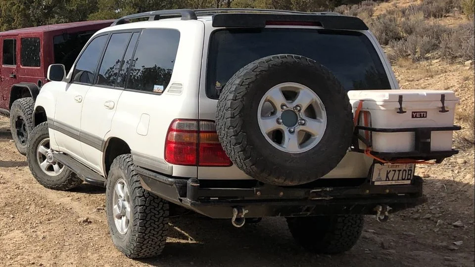

This is the 4x4Labs 100 Series version and one of the ways I used the back end. I bought this YETI because it fit perfectly in the 3 jerry can baskets. When I am not going on long trips where I need fuel or water, I would carry this.
Now that this rig is sold and I've got the LC200 with Slee's rear with the dual arms and ladder with basket, I don't see why it wouldn't fit in it also. I'll get a photo of that one of these days and post it up.
