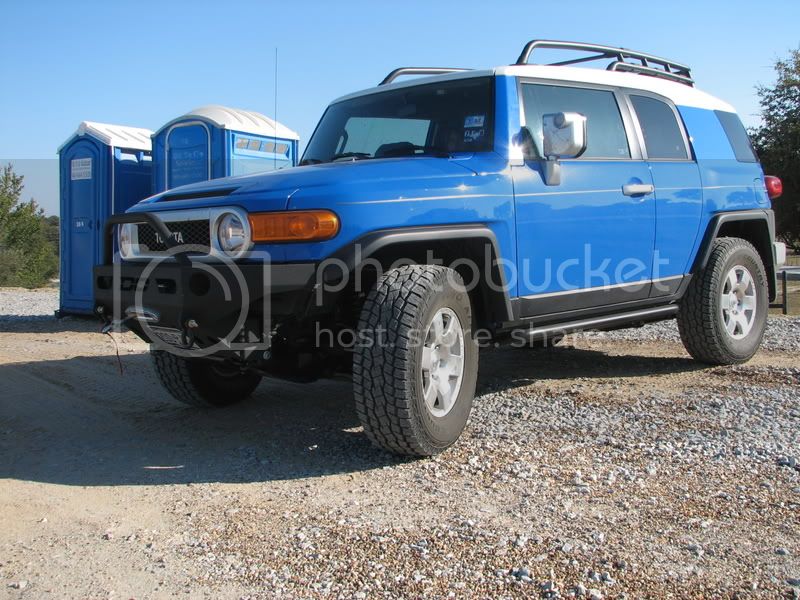

Mine are stock sized, and with my new OME lift, they still look good.
With lift one.
Without lift or ARB bumper.
Good high detailed pics, but 3.1 MB each.
