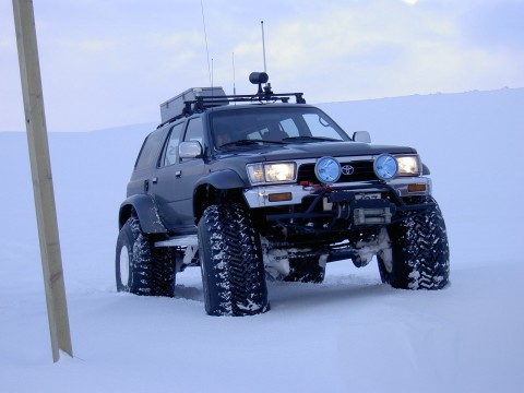

I've always had a thing for 44's.......
Yeah..... 31's are good for a weekend wheeler.........
