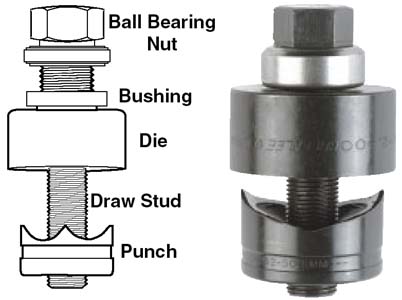

how does a greelee punch work?

Drill a small hole, the die goes on one side the punch on the other. Then you thread a bolt through the hole and tighten it down until the punch cuts the bigger hole out. It's the cleanest way I know to cut sheet metal.
Sometimes they distort the metal.
I would rather holesaw or unibit. + I like the noise
ken
IH8holesaws on metal
Unibits work okay.
For smaller holes a hand reamer works well.

Thanks for the links Alia. Sounds like the E-Ham guys like to use the Greenlee punch.:grinpimp:
I found one at Graybar but it was the electricians punch, which is for 3/4" ID conduit. To big for an NMO.
