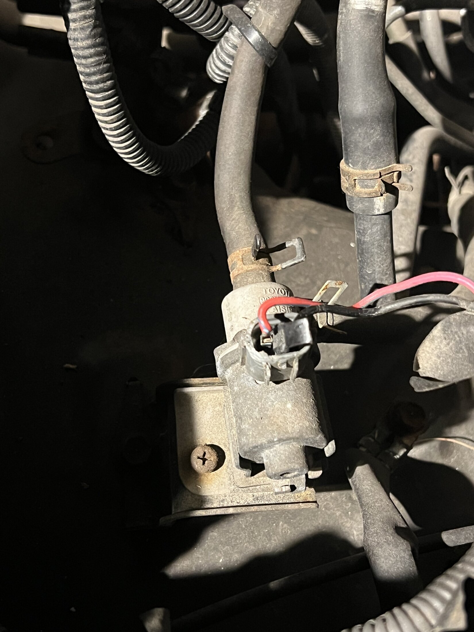

Need help in determining a part number. The vapor recovery valve is squealing every morning when I start my truck and also threw a CEL last week. I've entered the part number molded into the valve body into three different online oem parts sites with no luck.
Any help would be appreciated.

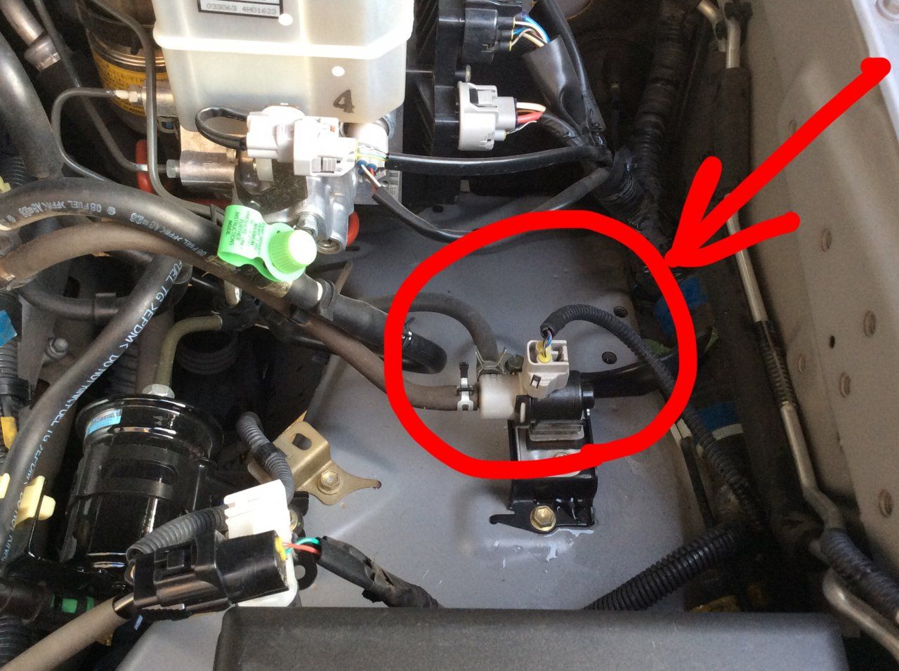

If the part shown is indeed 90910-12264, then it might be the wrong part for the LC.... which could explain the squealing. Correct part number 'might' be
25860-50100 or 25860-50150 but can't really tell since the OP doesn't list the year LC/LX in his signature.
2005 LC. 153k miles. Had the truck since Oct 2012. I looked at the valve again and it has 90910-12261 molded into it.
Noticed an "air pump" sound (Darth Vader breathing fast) only when going up a mountain pass a few times. The squealing started a few months ago when the truck was started after sitting for many hours here in Flatland Dallas. I've had it throw a code 0455 about 6 months ago and only concluded it was a lose fuel filler cap. The filler cap was new, so maybe a stiff o-ring?
Last week it threw code 0447. I suspect the VRV, since it's squealing like a pig. Cleared the code and has been good for last 800 miles.
BTW, I've visually checked all the connections and lines all the way from the charcoal cannister in the rear all the way up to the engine. Nothing was loose or looked like it was replaced or damaged. I haven't done the diagnostic check with a vacuum gauge as spelled out in the FSM.
I figure I could replace the $50 VSV since it is easy to access. Beyond that, I will do the diagnostic per the FSM before replacing more parts.

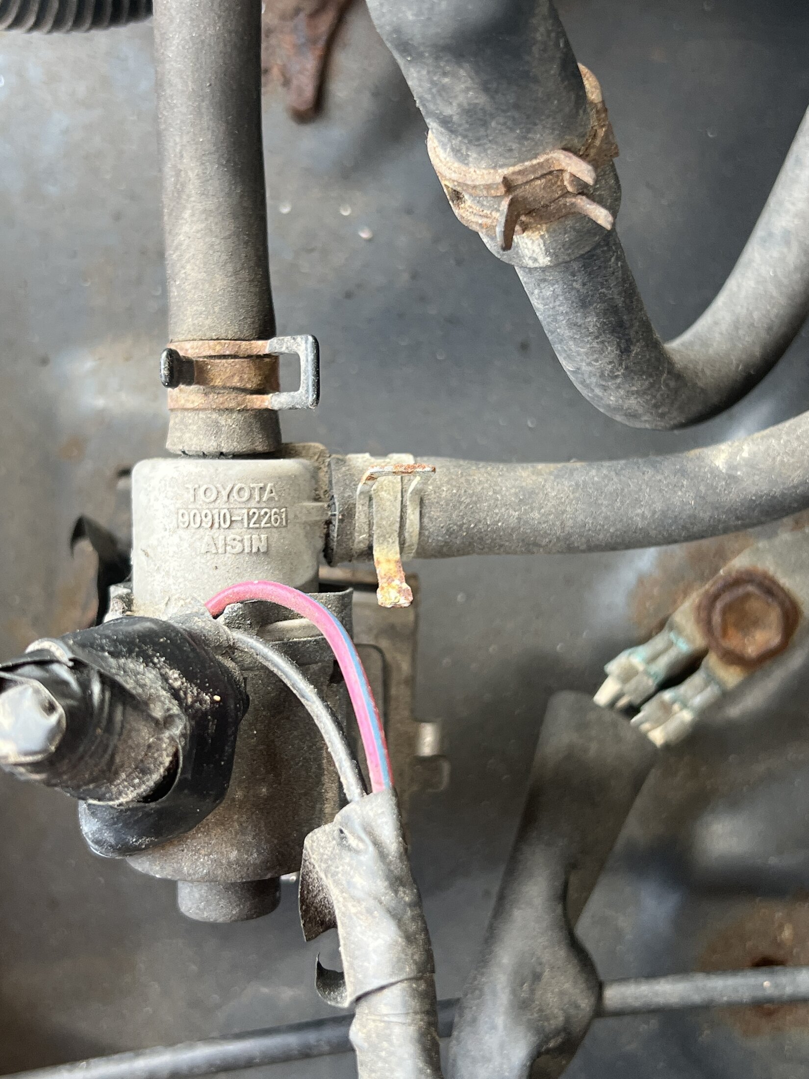

Anyone know the part number for the clip that attaches to the canister purge valve? I removed the black electrical tape, and may have found why I keep throwing codes.
New aftermarket valve is ordered, just need the other connector end

They ended up canceling my second order, citing out of stock. So I just went to the local salvage yard and pulled one off a Sequoia. Seems to have fixed the issue.
