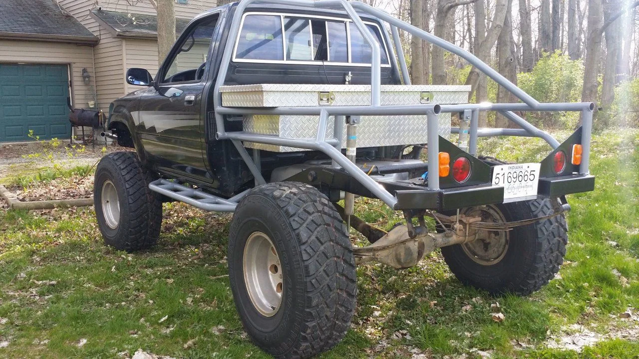

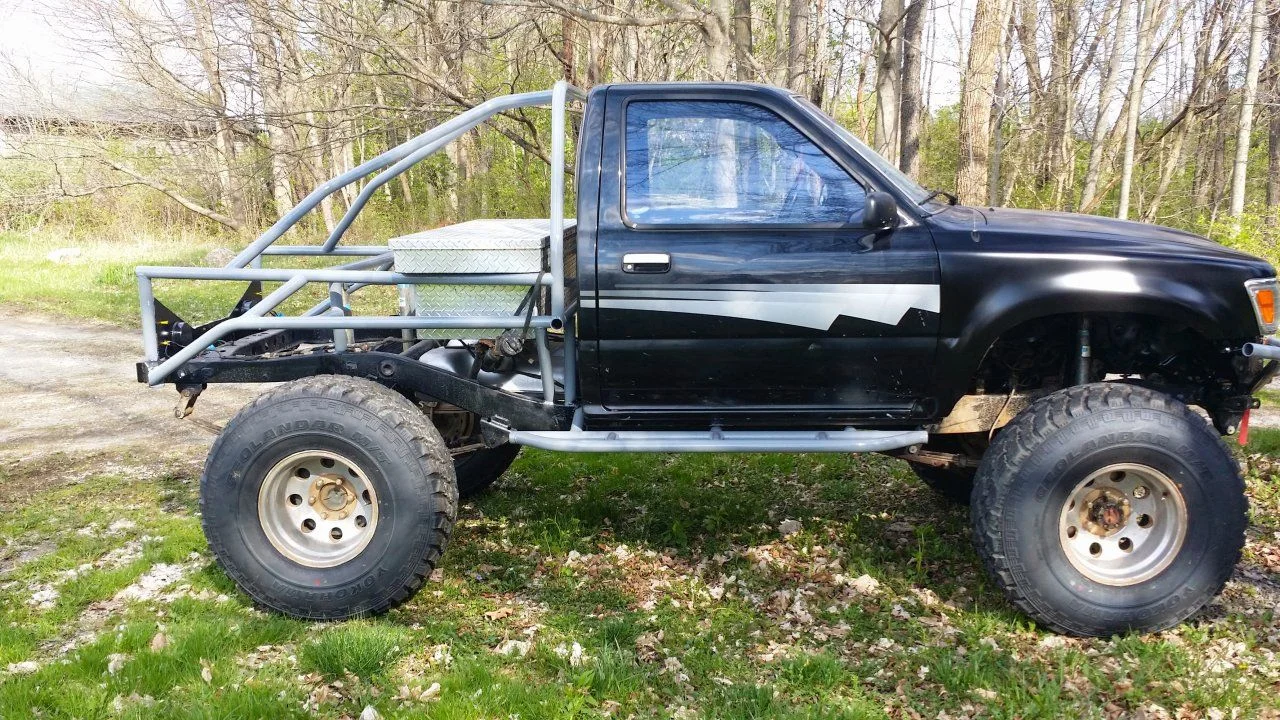

almost done (for now). But good enough to give a shake down!
And everything worked very well! I am well pleased!
Now to do some more details and put a bed floor in it and ready for PYS!
I decided to do a tube bed instead of an exocage. But still plan to do an exocage for the cab as $$ permits
SWEET!!!! Can't wait to see it in action. Don't forget to make the doors removable, all the cool kids are doing it.
As the passenger on Saturday, I can say I am way impressed with you have put together in short order and how well it worked on its first run!!!!

I need to get hustling, using your time table, i only have two days left to get an SAS done on the taco!
Couldn't have done it without help from my friends in the form of labor, loaner tools and free parts!
But I must confess I don't fxxx around. I spent every minute I had available wrenching on it.
Thank you to everyone that gave in one form or another! Much appreciated!!!!!
