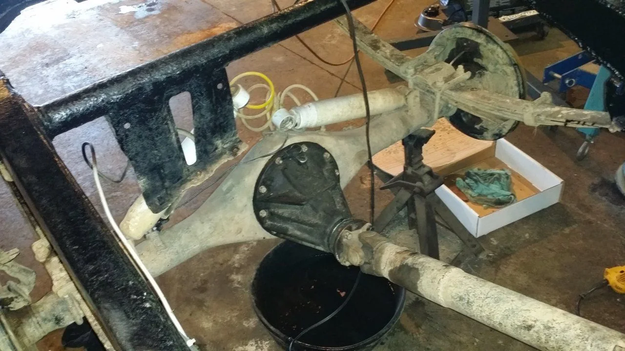

This is a v6 3rd, locked, & 4.88 gears! Installed & ready to go. Got the front locker installed in the 3rd member, but not in the axle housing yet.

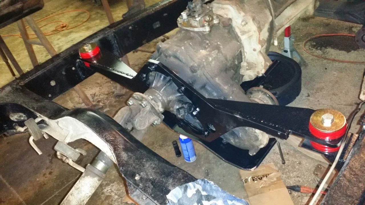

Here's that dead sexy cross member

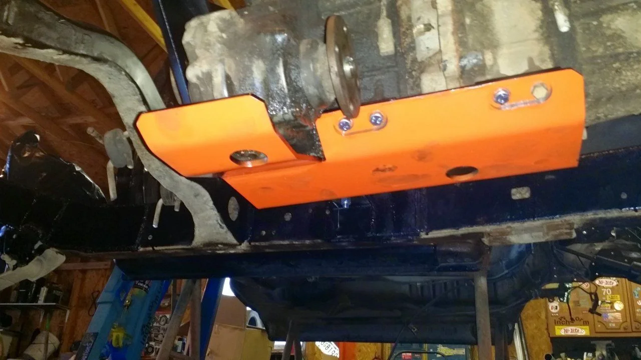

And the skid plate (ignore the greasy hand prints)
