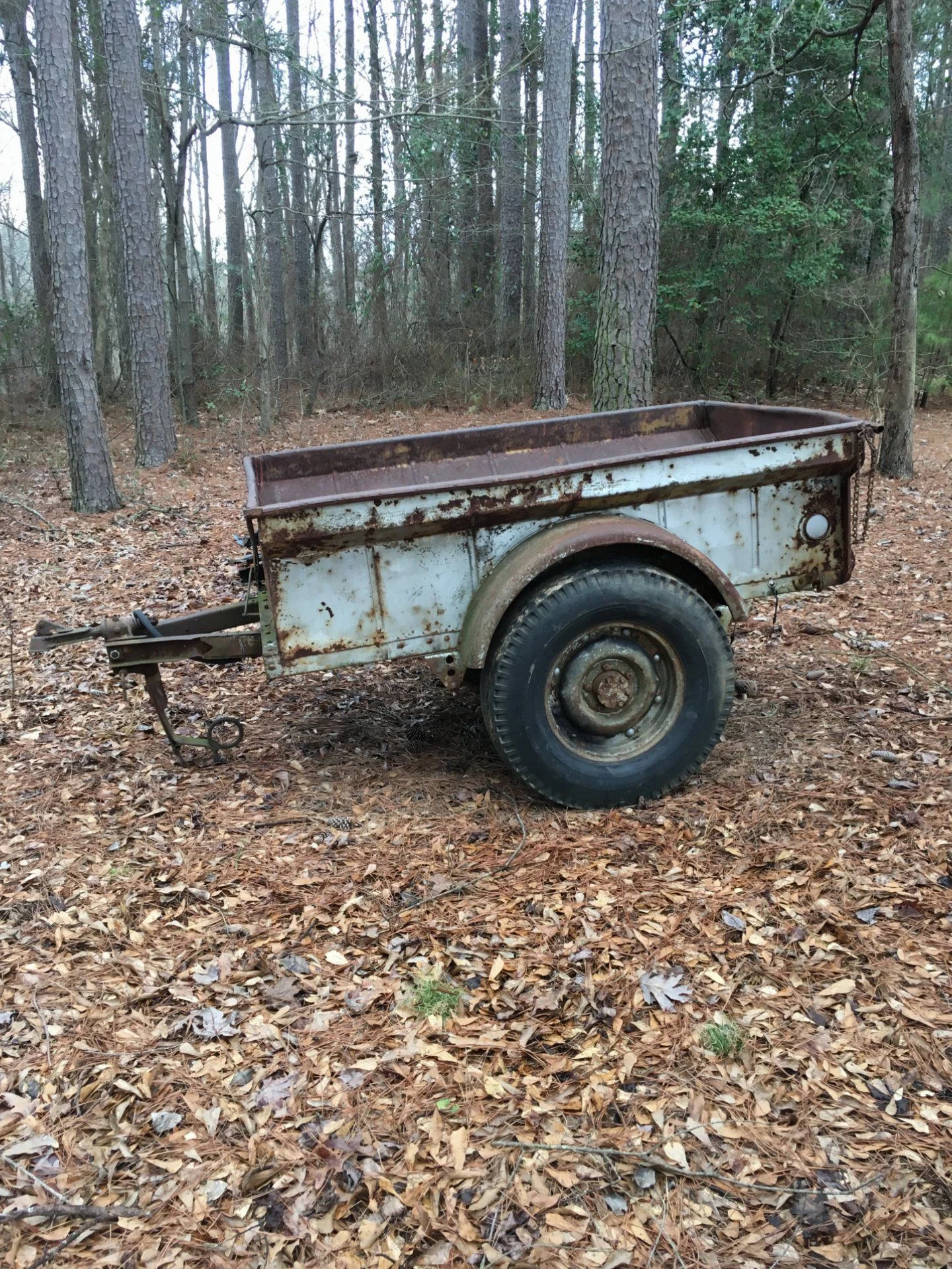

Not a mod, but an addition.
Going #EAF Lance!
Holy COW!
That thing is NICEEE! That would look sweet behind my 80 with a shovel attached to the side and my Ozark Trails Dome Tent (8-10 person...no big deal) on top of it strapped down with one of them nets. Axle even looks like a full floater!

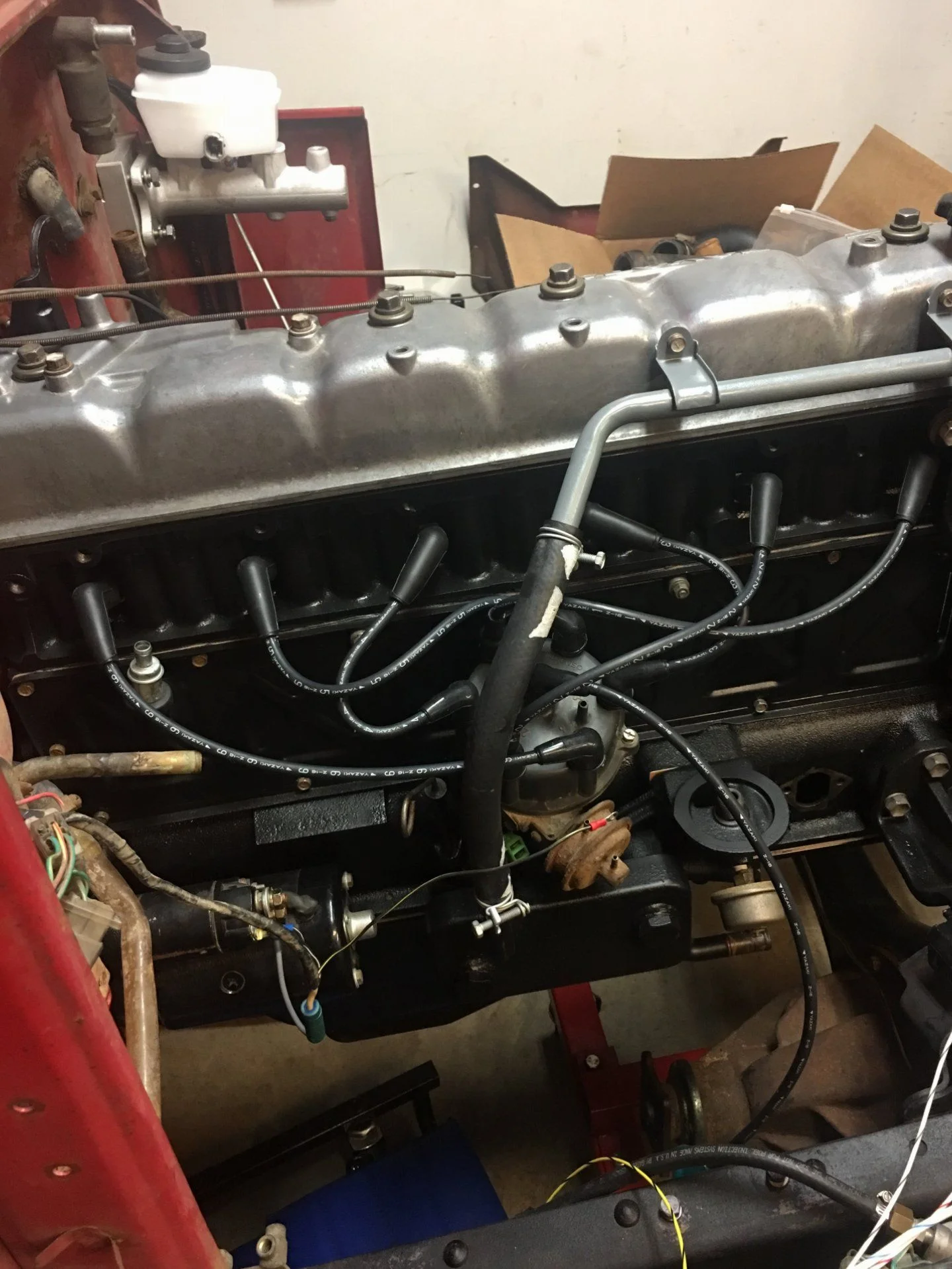

You running 93 in that thang Mark?
Looks like you need to replace that crusty ass distributor or at least shoot some Kyrlons on it.
You bout ready for that Saginaw box?
I meant to de-rust that vacuum advance attachment before I put things back together. It's going to end up bugging me enough to tape it off and paint it.
