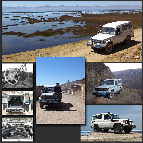

Same as Rosco, specifically a HZJ75LV-MR with an aftermarket turbo. :)
Damn, I should never post pics like that without a hanky close by. :D
