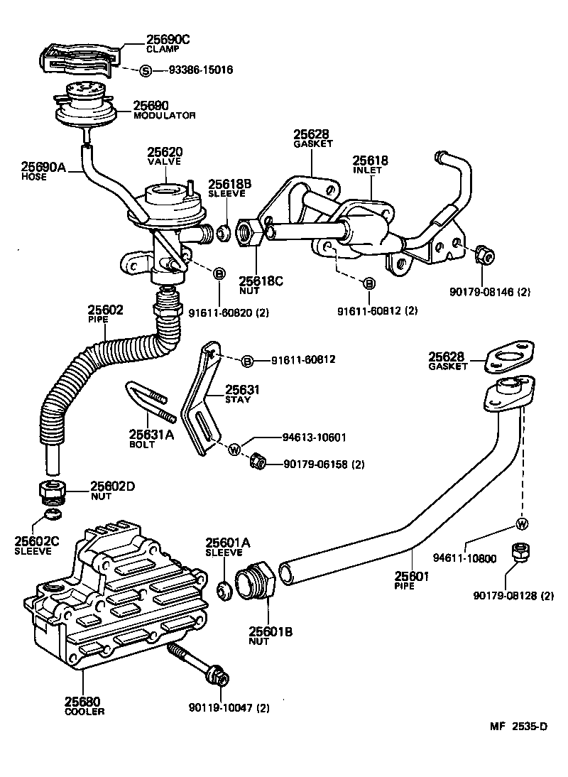

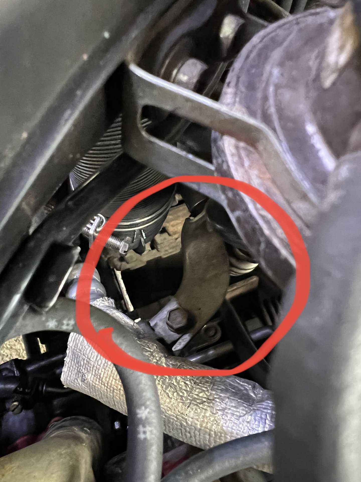

Randomly saw thi bracket being unused. Any ideas?
Toyota calls it a “stay”. You can see it on the drawing. It holds a little u-bolt that clamped around the EGR flex pipe.
I can tell you from experience that the EGR flex pipe u-bolt with that associated stay isn’t necessary. It was overkill — even if the cruiser only drives on rough dirt roads.

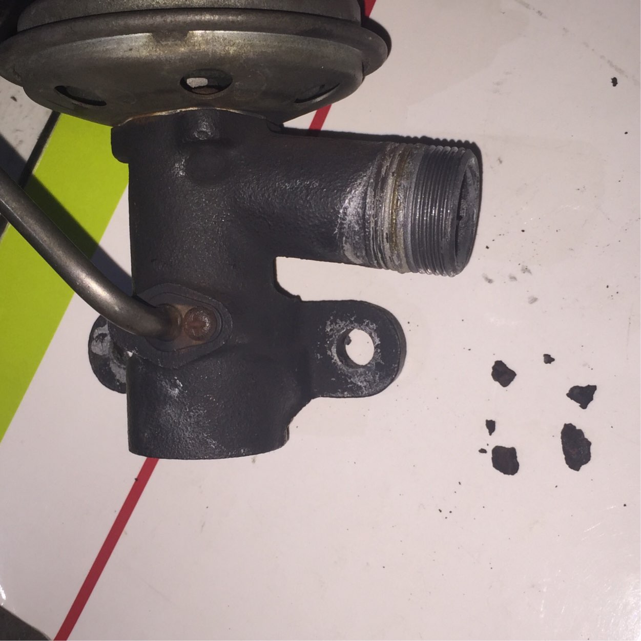

@OSS I have the EGR off of my blue 60 right now. I got it open - only broke 1 bolt! - and found all kinds of rock hard carbon/rust chips in side. Note the bracket, too. Bracket doesn't seem super necessary to me given how inflexible the "flexible" EGR hose is.
Holy crap!
That rock pile is inside every single EGR cooler - spitting pebbles up into the engine every once in a while.

I emptied it out and chiseled out more loose stuff, then wiped it down with brake cleaner and a wire brush. I don’t know what to do now … paint it? Like that will last with 1000*F+++ heat and spraying on a terrible surface. Close it up and run it?
I painted mine with POR manifold paint. Couldn't hurt, but I had some leftover.
How’s that holding up? Probably haven’t taken it apart to check, eh? I wouldn't either.
Yeah that’s all you can do. No paint is going to last long inside.
Now that you’ve opened it up - maybe open it up every year to inspect it and chip out more rust.
Another fun item to add to the yearly maintenance list!!!! I better stock up on anti seize.
Nah, I did it like 15 years ago, now. I did have to remove the assy once, about 3 years ago when I broke the J-pipe stud, and I just looked inside through the threaded holes, and it seemed clean but sooty.
