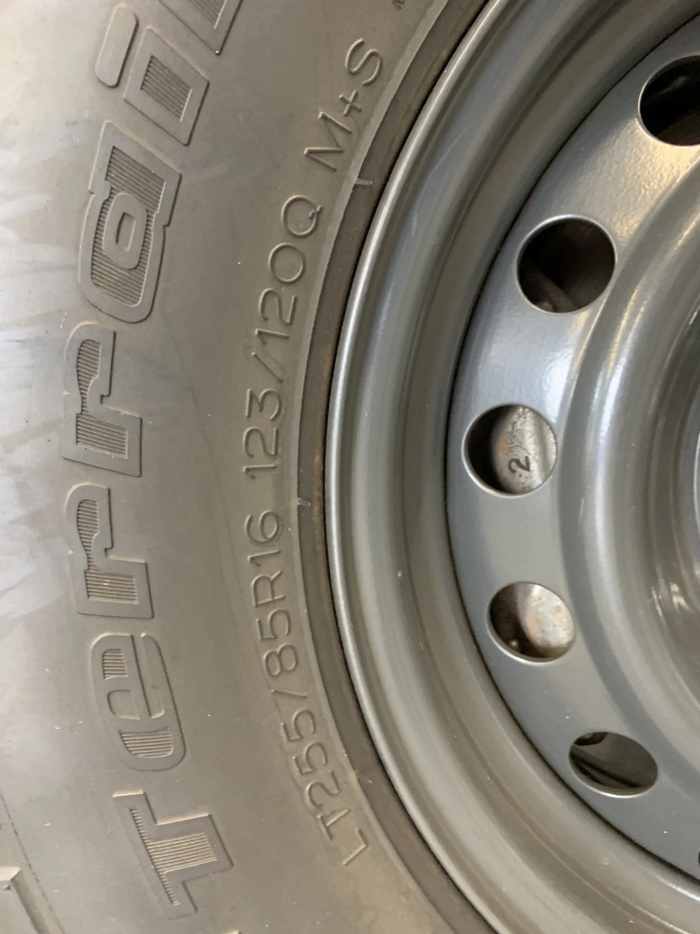

I had forgotten about the 255/85/16, that is a great tire size from a lot of standpoints. I was very tempted to go with the 255 over the 235, but cost and gearing made me think better of it. If I had a slightly lower 5th ratio they would be perfect. There is also a 255/80/17 that is essentially the same size tire for a 17 inch rim, but I don't know much about availability for those.
All the appeal of the 255/85 evaporates when you realize that they are supported by only a few manufacturers and are usually special order (not in stock).
235/85 or 265/75 are very available tire size in a wide variety of models and made by many manufacturers.
I had 7.50R16, 265/75, 255/85 and 285/75. My favorite are the 255/85 but if I had HZJ78 and travel in different countries, I would opt first for 235/85, then 265/75. The 7.50R16 are way too narrow.
