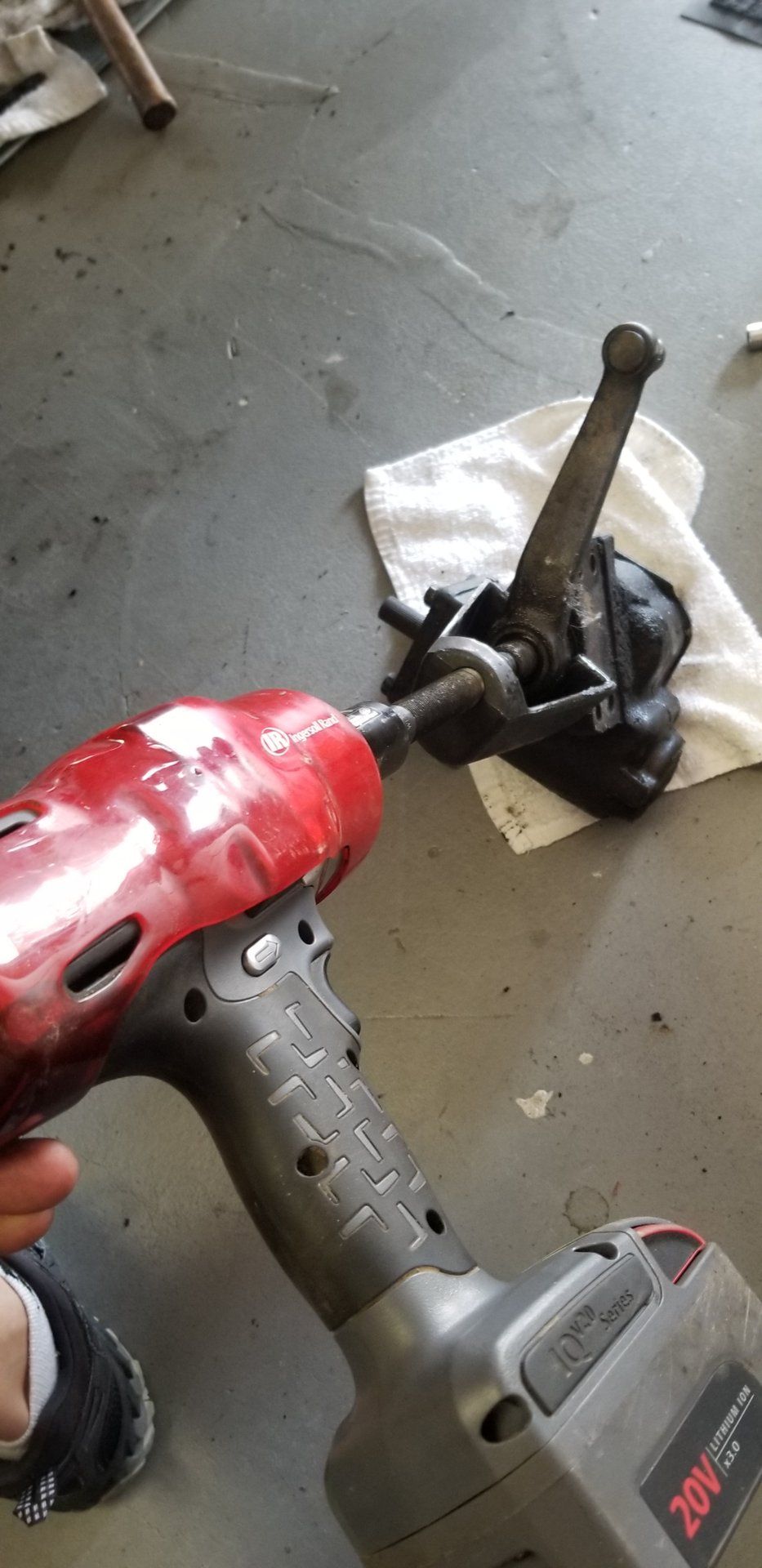

Working on rebuilding a spare sm465 I've been moving around for like 9 years. It was surprisingly in good shape minus some rust on the input shaft where the seal rides. Ordered a new shaft and some other small parts plus a full rebuild kit.
I'll drill and tap the output shaft to work with my Orion before reassembling. Once this one is ready I'll swap it out with the one in my truck at the moment...which is leaking out the front shaft.

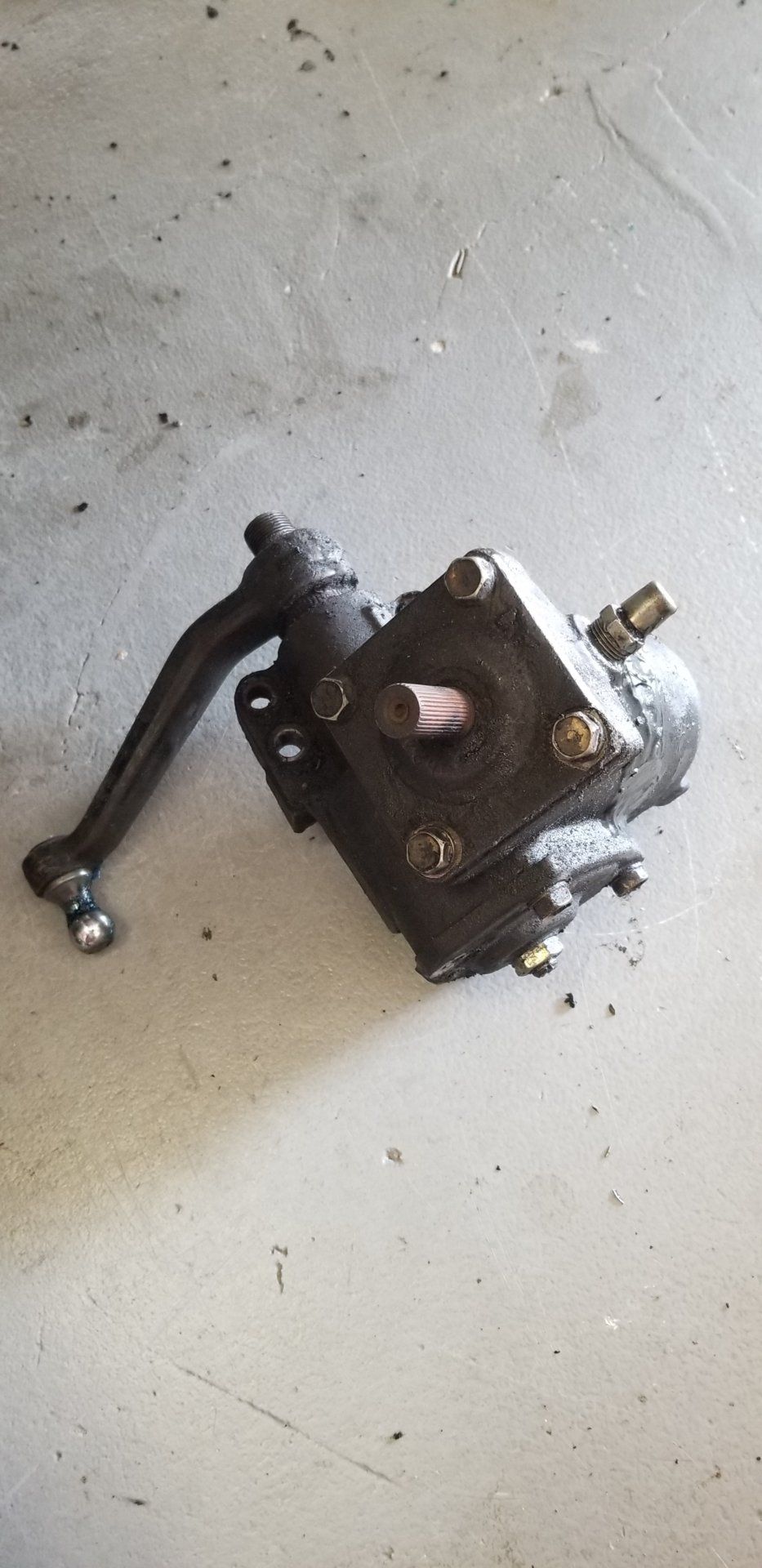

Case painted after cleaning/blasting. I'll wait a couple days for the Rustoleum Appliance Epoxy paint (I love this stuff, it's great) to cure and parts to arrive. Wash the case with soap and water to remove any residual glass beads and then it's assembly time!
Quick question on the painting of something like this: do you mask off the machined surfaces prior to painting? Is that how you accomplish that, or is there some other technique?
Yes. My process...which is just one way.
1. Scrape off crud.
2. Scrub and scrap in the parts washer until all grease and most dirt is removed.
3. Wire wheel machined surfaces.
4. Mask off machined surfaces and plug holes (trying to limit the amount of blasting media gets inside the case).
5. Blast case.
6. Remove tape and wipe down case with degreaser.
7. Re-mask machined surfaces.
8. Prime/paint.
9. Remove masking.
10. Once paint is cured then wash case with soap and water, blowing dry with compressed air (don't want any residual blasting media left inside the case that would mix with gear oil and potentially cause premature bearing / gear wear).
I imagine the machined surfaces on the exterior of the case could be painted if wanted.
