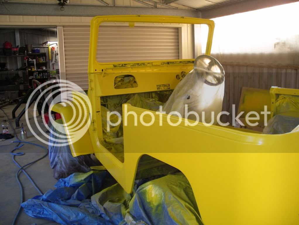

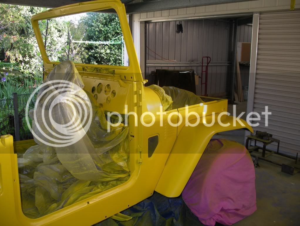

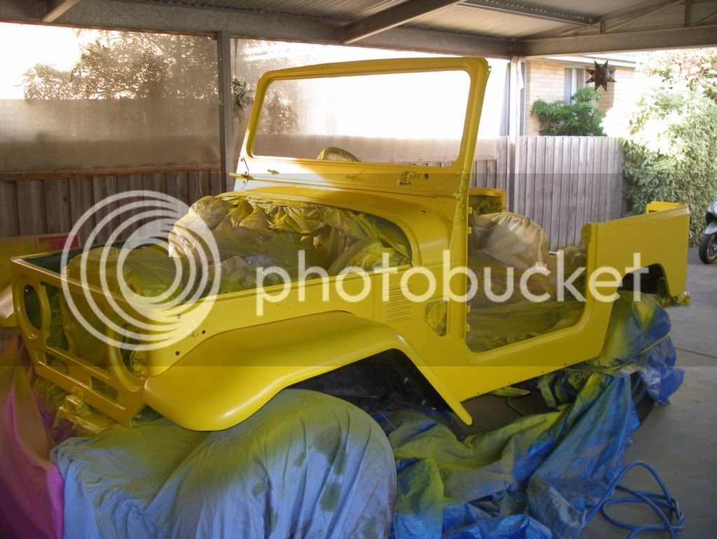

Painted my cruiser today. First fine day in about 4 months! Got the whole thing primed and painted in a day so was pretty chuffed. Need to buff for a shine but happy with the outcome. Also made up custom dash yesterday. PO had hacked the dash for some gauges and what really annoyed me was the gauge holes weren't even, they were lopsided. So I had to make the sad decision to cut the dash out and replace with a timber one. Bogged and sanded sides so that it blends in nicely with the original dash. Custom gauges being shipped as we speak.
