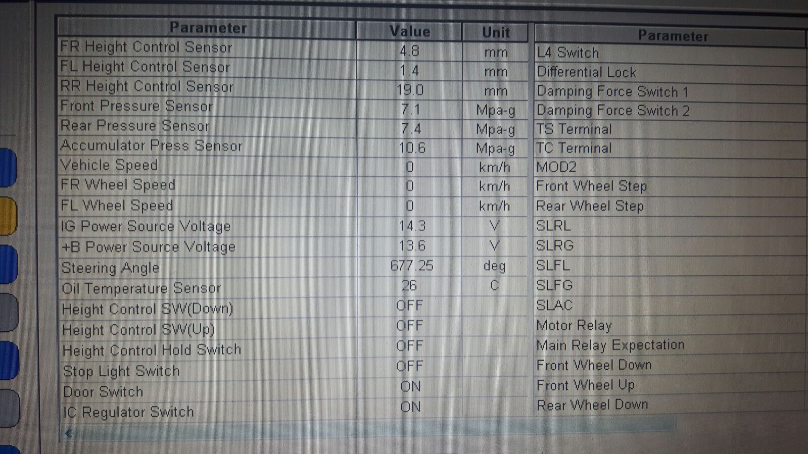

Yesterday I adjusted my front AHC neutral pressures.
In a few days I will buy a winch, so I used a few batteries to simulate the "winch".
With the "winch" in place the front pressure is now 7.1Mpa-g:
I also saw there was something wrong with my steering angle sensor, but that is for another time.
Without the "winch" my front pressure is about 6.5Mpa-g.
Measurement with no person in the car. I had to do 10 turns each side.
I will probably do this again when the winch is in place, easy job that does not take much time.
I'll probably flush the system too.

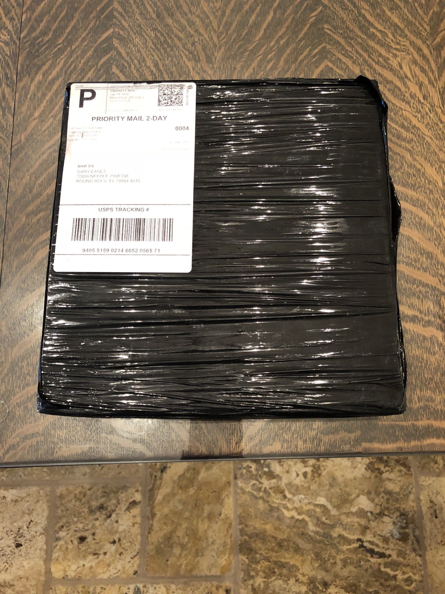

Found this packing job hysterical. My female neighbor chuckled. I didn’t make things better when I said it was just a breather kit. Darn you Amazon and your discrete packaging!

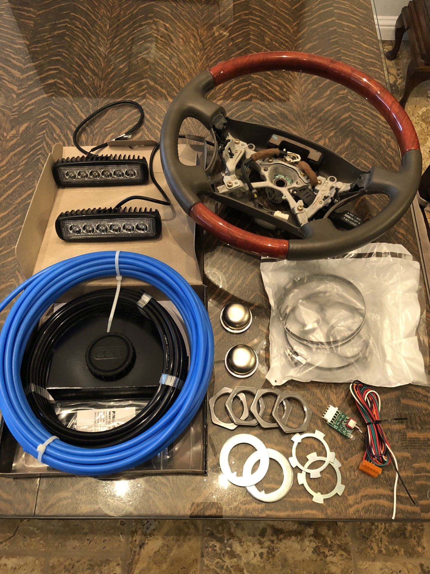

Looks like I’ve got a busy little weekend planned....

Is that the steering wheel available on ebay?
This is an OEM Lexus wheel for 98-00 J100s. The previous owner provided it when he sold it to me back in March. He had bought it back in 2003 and never put it on. I'm replacing the all-leather steering wheel on my LX that is in absolutely perfect condition. Figured I'd try the wood.
