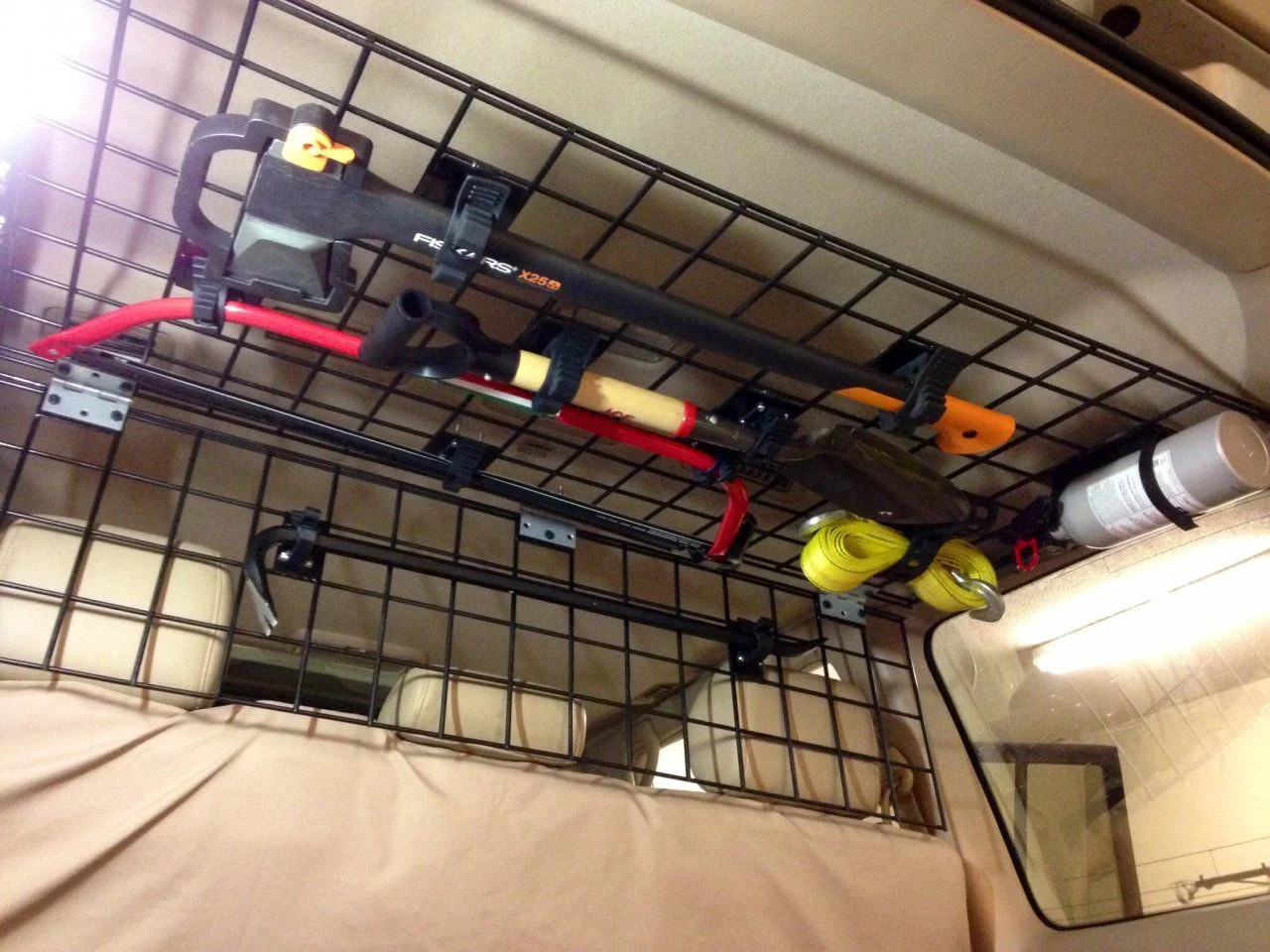

Finally got everything I wanted installed on the interior cargo rack. May pick up a few bungee cords tomorrow because honestly when are bungee cords not appropriate?? I've already put the axe and shovel to use and I'm sure they will all come in handy during the winter when I have to deal with fallen trees.

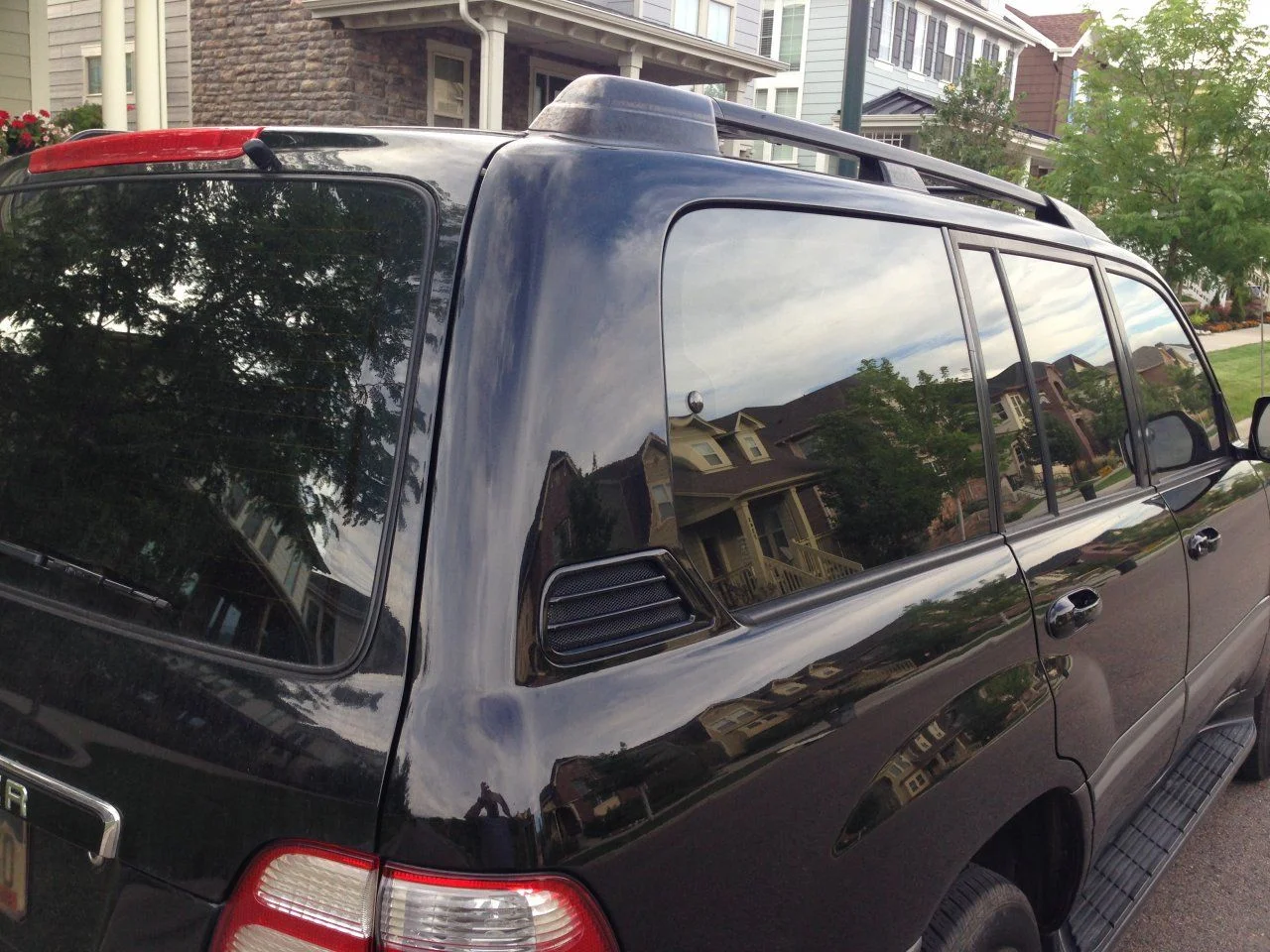

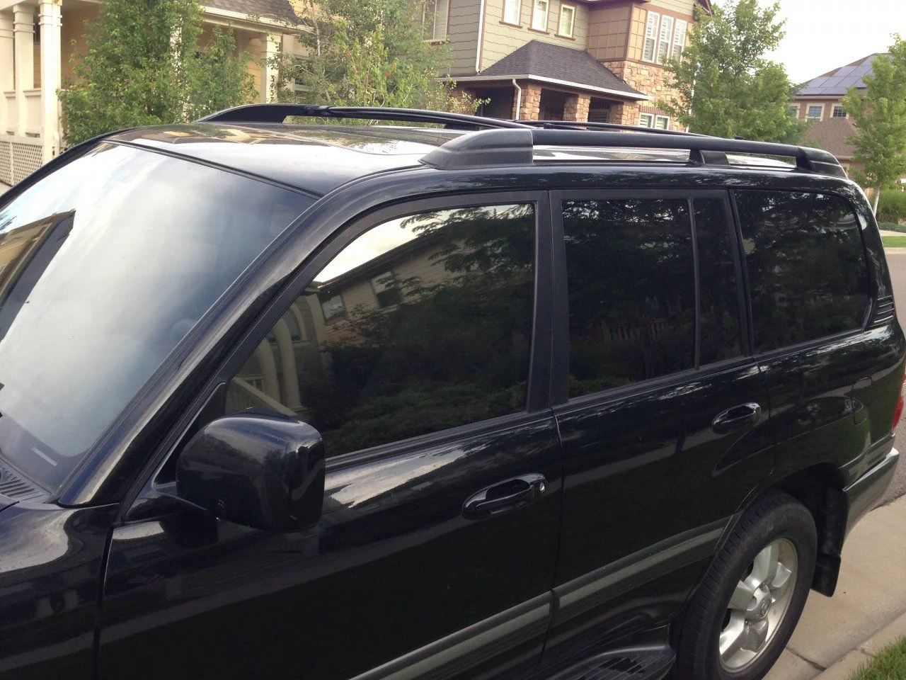

Got the car tinted .. and it looks awesome!

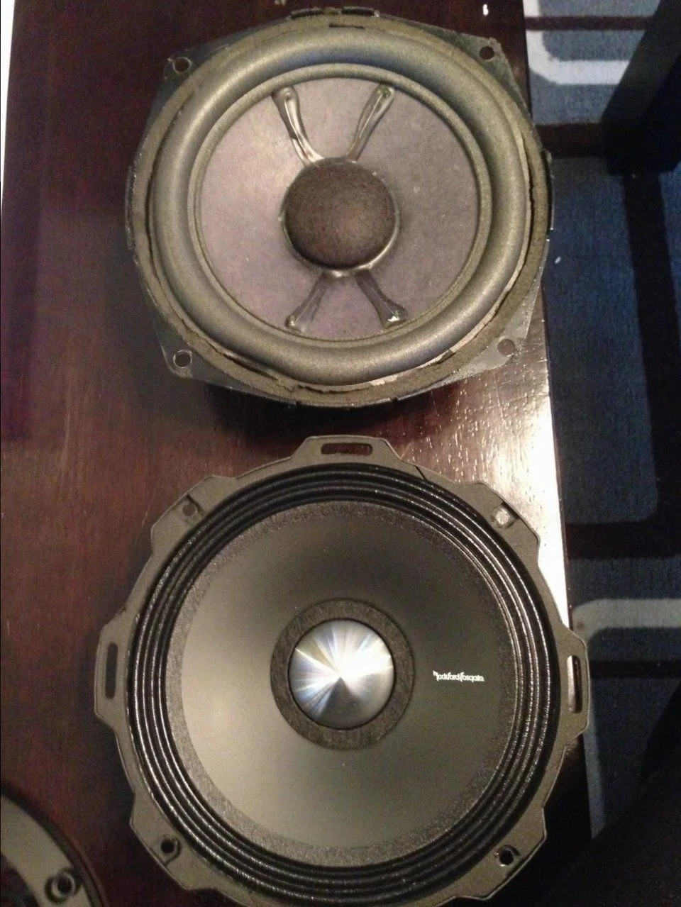

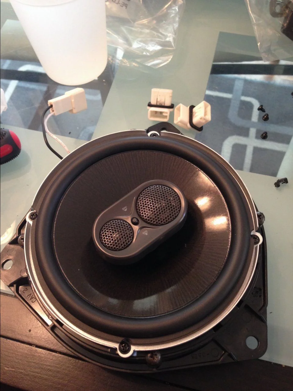

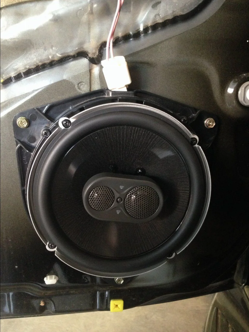

And updated the front speakers to new 3-way JBLs ... the sound is sweeeeet!
And the subwoofer also got changed to a nice little Rockford Fosgate .. ;-)

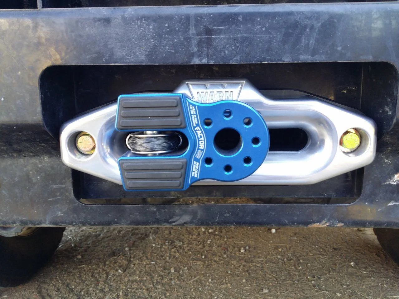

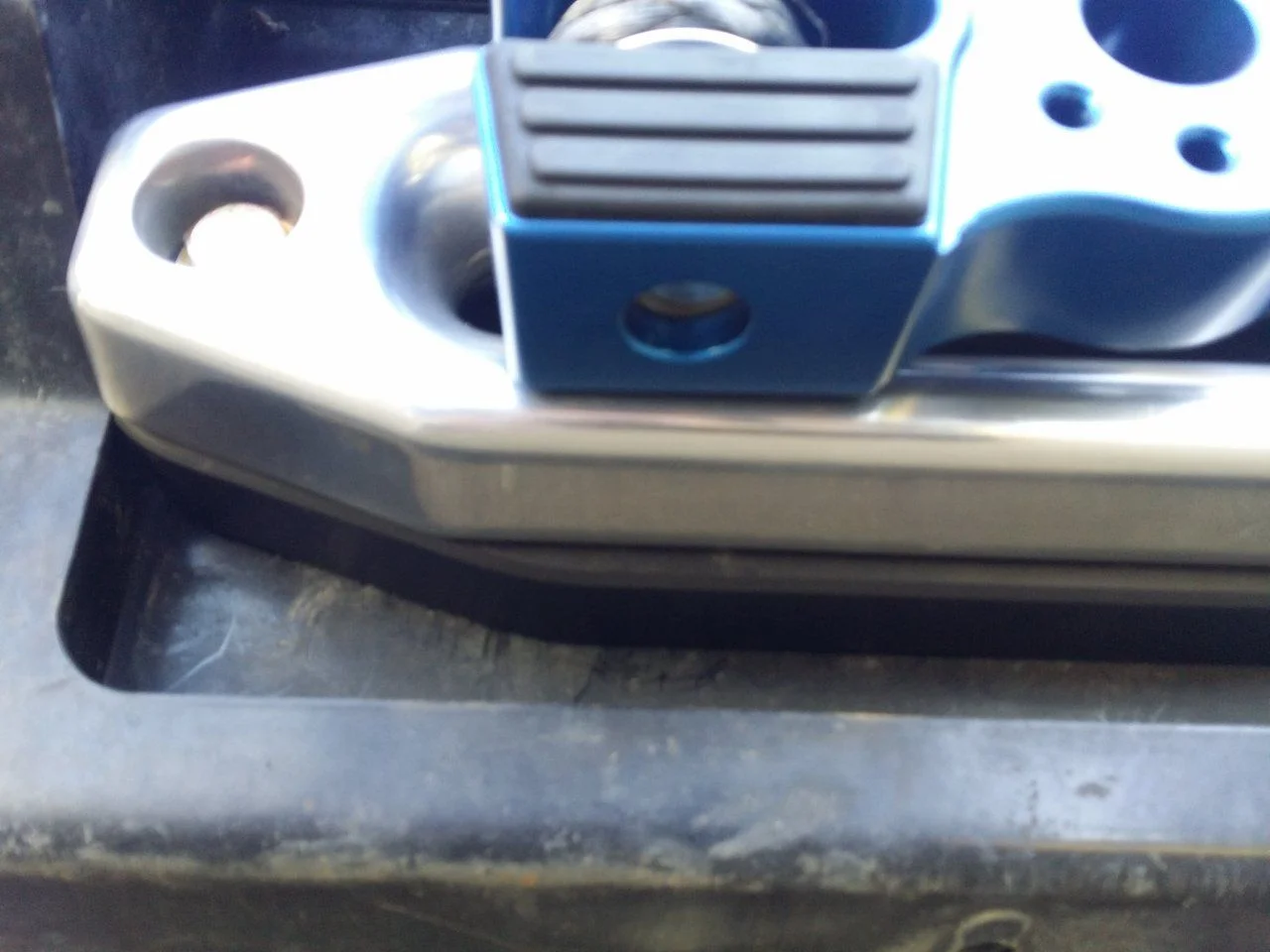

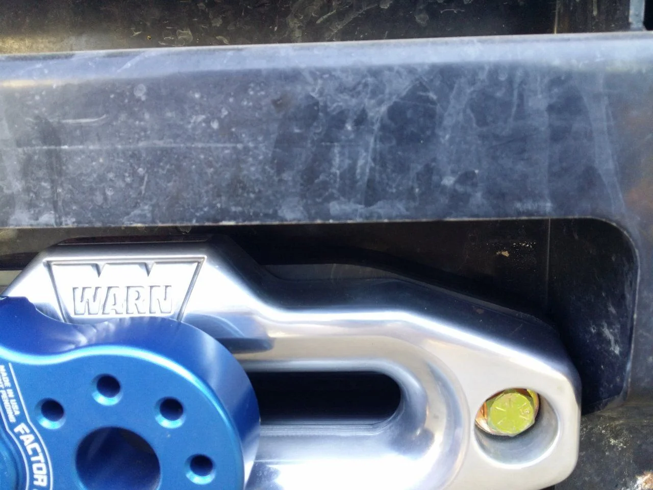

I installed a second hawse fairlead to act as a spacer between the bumper and the fairlead, because the recess meant for the roller fairlead has too sharp of edges for synthetic rope for certain pull angles. I used a 1.5" Delrin fairlead behind a 1.5" Warn aluminum one. (I still have my wasted unused Slee which I will post in the classified section. (It's the nicest of the bunch, but too shallow for the Ironman bumper.)
I'd prefer a single 3.5" one, but can't find anybody who makes one. What has anyone else with an Ironman front bumper or the ARB is was "inspired" by done when switching to synthetic rope?
I see mixed feelings about using the roller fairlead with delrin rollers. But might be the best compromise for your set-up.
I thought about that option as well, but I damaged my orginal roller fairlead at CM 2014 so i went the hawse route. I could also just stick another Delrin one behind the one that is there and the bumper. It's good enough for now as I don't winch much, but I will get it spaced properly before the next major trip where I may need to. (Hopefully I don't regret waiting.)

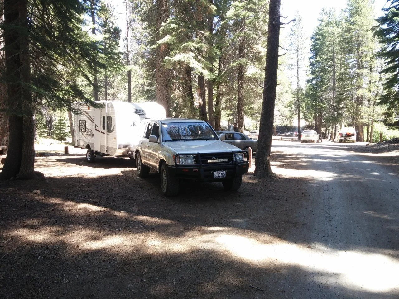

Went camping... Towed our Jayco jaylite, it's not as tow happy as my cummins , but towed trailer no prob...

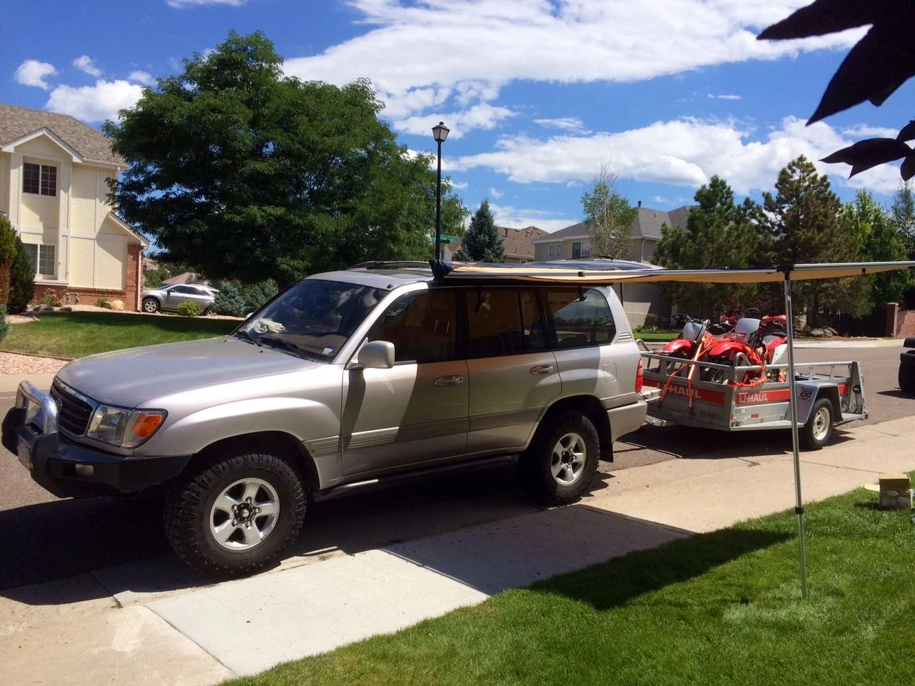

I could have sworn I took some, but looking back at my phone it looks like I forgot! I'll snap some tonight though. I just used the factory cross bars and drilled two holes to mount the brackets through. It was surprisingly extremely sturdy, and I tested it about 2 hours after I installed it with a 5+ hour road trip some of which was offroad. I also at first didn't want to mount it on the driver's side due to potential wind noise, but it was a total non issue.

Where did you find the back seat cover? I need one those for my newest four legged friend
...via IH8MUD app
@GaFJC They are Cabela's brand and I got them off their website about 4yrs ago. I can't find the exact style on there anymore but the next best thing is their TrailGear Series that come with a few extra pockets for storage. I love them though, they're great for protecting the leather since they are water resistant and they prevent any animal from ripping the seats with their nails. They even hold up against the occasional accident my dog used to leave in the back when she was a pup:D
