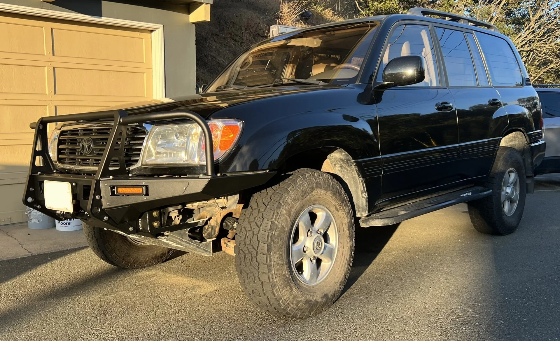

Installed it last night.

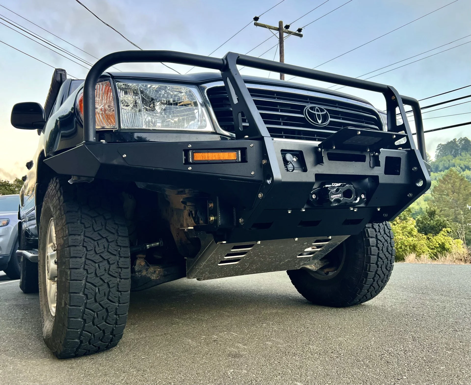

Finished wiring up the winch inside the center section of the new bumper and then got it all installed. Super pleased with how it looks. Just a few more adjustments and it will be all set.
That Dissent bumper looks amazing! It's so temping with the sale they're running this weekend. How easy is it to remove the bull bar? Can it be done without uninstalling a bunch of parts? And I noticed you're running Diode Dynamics lights instead of the Rigids I normally see. Did you have to modify the bumper to mount the Diode Dynamic lights?
Thanks! Yea I am super happy with it. The bull bar can be removed and installed with the bumper assembled, just need to pull the light plates off to access the captive nut plates for the far edge bolts.
The DD lights are great. They are almost exactly the same size as the rigid ones just cheaper. I used an extra washer on each side of the mount, but it probably didn’t require it, I just like to over-engineer stuff.

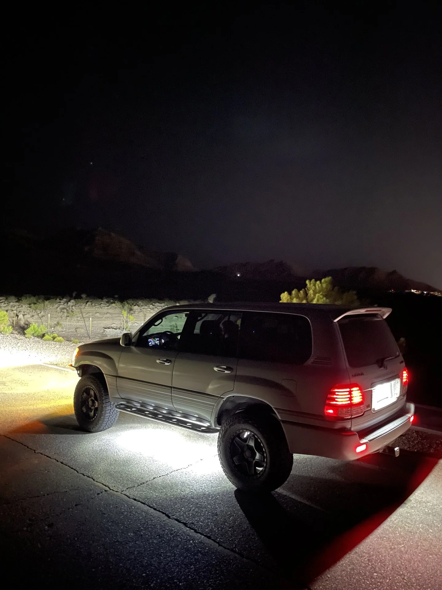

Took her out last night to aim those 6” rigid sae fogs and DD spots.
