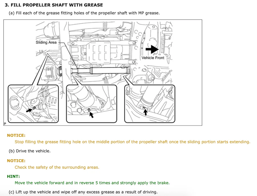

Sucks. I guess since this conversation keeps coming up, I will just say that any front prop shaft is pushing on a t-case in a "twisting motion" while it pushes rearward. If you over fill the rear prop shaft, it will push in line with the entire driveline, so it would be much harder to crush the rear of a t-case inward. But pushing the front prop shaft output on the t-case backward, well... much easier to crack something. With an IFS truck, compression of the front prop shaft is obviously much less than on a solid axle truck.
I'm not advocating to grease shafts until they blow grease out of them, I personally pump grease until I see it move a millimeter, then I stop and i've never blown a prop shaft ever. Which is also how the Toyota FSM, and Toyota Certification Program states it the proper way.

Getting ready to lube the drive shaft and other chassis components so I read the FSM and searched the forum and found this thread. Good info. I've always believed, based on what I have been told that it is possible to over grease a drive shaft and potentially something could break or get damaged if over done. I also know that no grease is no good either. So even after reading this thread, how much grease is too much is not crystal clear to me. Based on what the FSM says, and knowing that there are 1000s of 4x4 vehicles that get greased or not greased at quick lubes and dealerships where technicians may or may not know what they are doing yet examples of damage seem to be few (not zero), IMO the range between not enough and too much is very large. If precision was necessary, the FSM would be more specific.
So, my plan is to hit the u-joints with one pump and the middle one with a couple pumps in the middle looking for movement on the sliding part (like the FSM says). Then drive it and look for grease sling and clean up.
It does make sense to me to drop the prop shafts, remove the zerks and use a pry bar to compress them to clear the old grease and make sure you don't have to much new grease but I would guess that this is almost never done and most of the time, its OK. Who (besides @Taco2Cruiser) does this or verifies their mechanics do? I'm sure there are a few.

You'll need more than 1 pump in the spiders. There is really no risk in overgreasing them other than making a mess, as they don't compress during normal use. Keep pumping until you see clean grease coming out of the seals after the old/dark stuff. Then wipe it as clean as you can. I use a screwdriver and medical-gloved finger to get most of it off.
For the yoke.. I'm about as OCD as they come and see no need to pull the shafts and compress them, personally. Your mention of millions of prop shafts running around just fine without this step supports my method, at least in my head. I'm pretty sure this method will get me to the 400k mile target that I have for mine.
I agree. Go nuts on the spiders, and be patient for the prop movement.
I was watching the prop like a hawk while I was pumping, but then it moved a lot at once. I would mark the current location of the prop with blue tape and then do 2-3 pumps of the grease gun - then wait several seconds before you continue (or even a minute if you’re really ocd).
If your up for it is the way to go especially if you have higher miles (120k+) or questionable service records. But if you are actually greasing the prop on a regular interval, not beating it like some or constantly submerging it in water it's a touch of overkill to remove the shaft every time you grease it. Unless you want some alone time in the garage.
I wouldn't get too OCD about overfilling it. Just pump till it moves a bit. If nothing happens for a while and then it jumps 1/2"-3/4" don't sweat it. It will be fine. Now if you pump pump and pump and grease starts coming out of the slip junction your going to have a problem. You really have to put a lot in and not use common sense to over do it.
