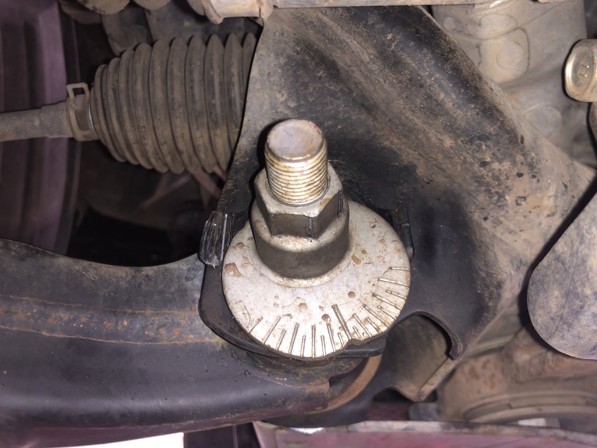

They did say the adjustable panhard bar was great and allowed them to get it perfect in the rear. They pointed out that the last place that tried to allign it broke one of the frame tabs for the lca cams and it will have to be welded back. Anyone had that happen? (See pic)

Regarding the alignment cam tabs, they are known weak points. Marlin Crawler sells weld-in reinforcements for the cam tabs and LCA mounts for around $130. Next time I pull of a LCA for something I am going to add in those reinforcements, as the overall LCA mounting in the 120 and 150 platform seems kind of weak, the reinforcements are cheap, and look to be an easy install job.

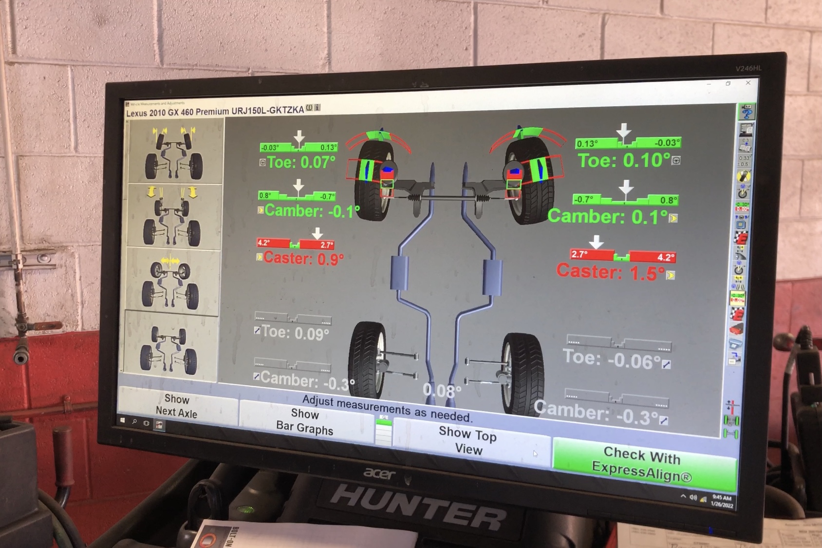

Do you know what the specification for your GX are for toe, camber and caster? I don't know off the top of my head if those are good numbers your showing.
The range onscreen is set for the gx. If you notice, the center is not 0 in any axis. The large numbers are how far out it is. So my caster is .9 and 1.5 out. The rest is within .1 degree.
Was that the first shop? Or the final one? I would think that at less than 1° it would be pretty twitchy at speed. Get it on the I-10 at 80mph and take your hands off the wheel. Does it track straight, or immediately want to drift?
Second shop. Don't have the first handy. Got a shoot in scottsdale tomorrow so Ill see how it handles on the freeway.
