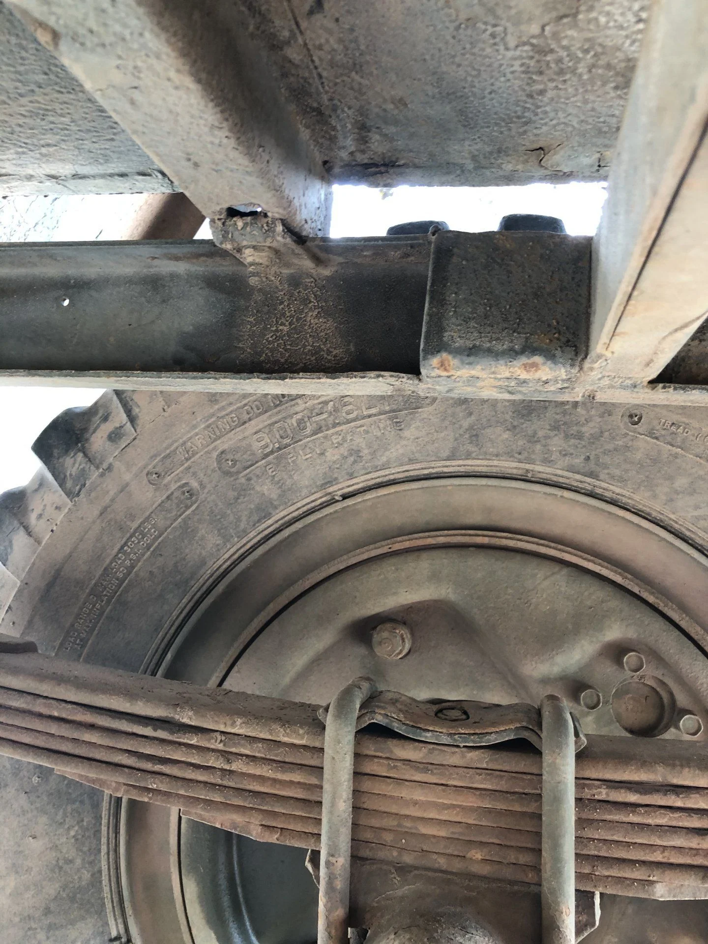

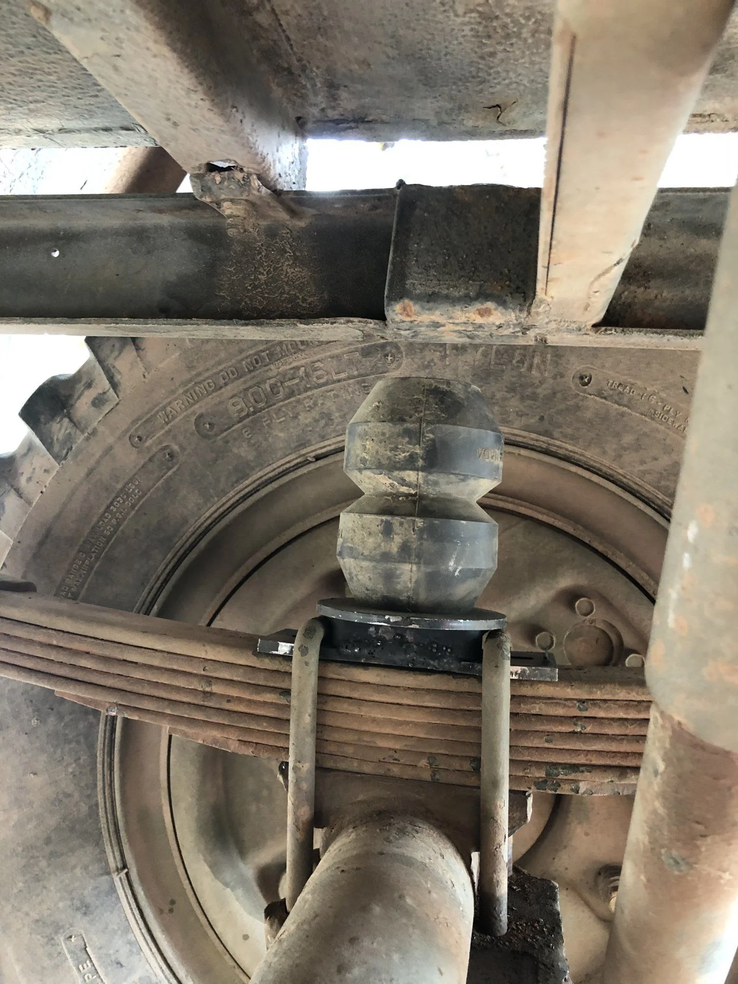

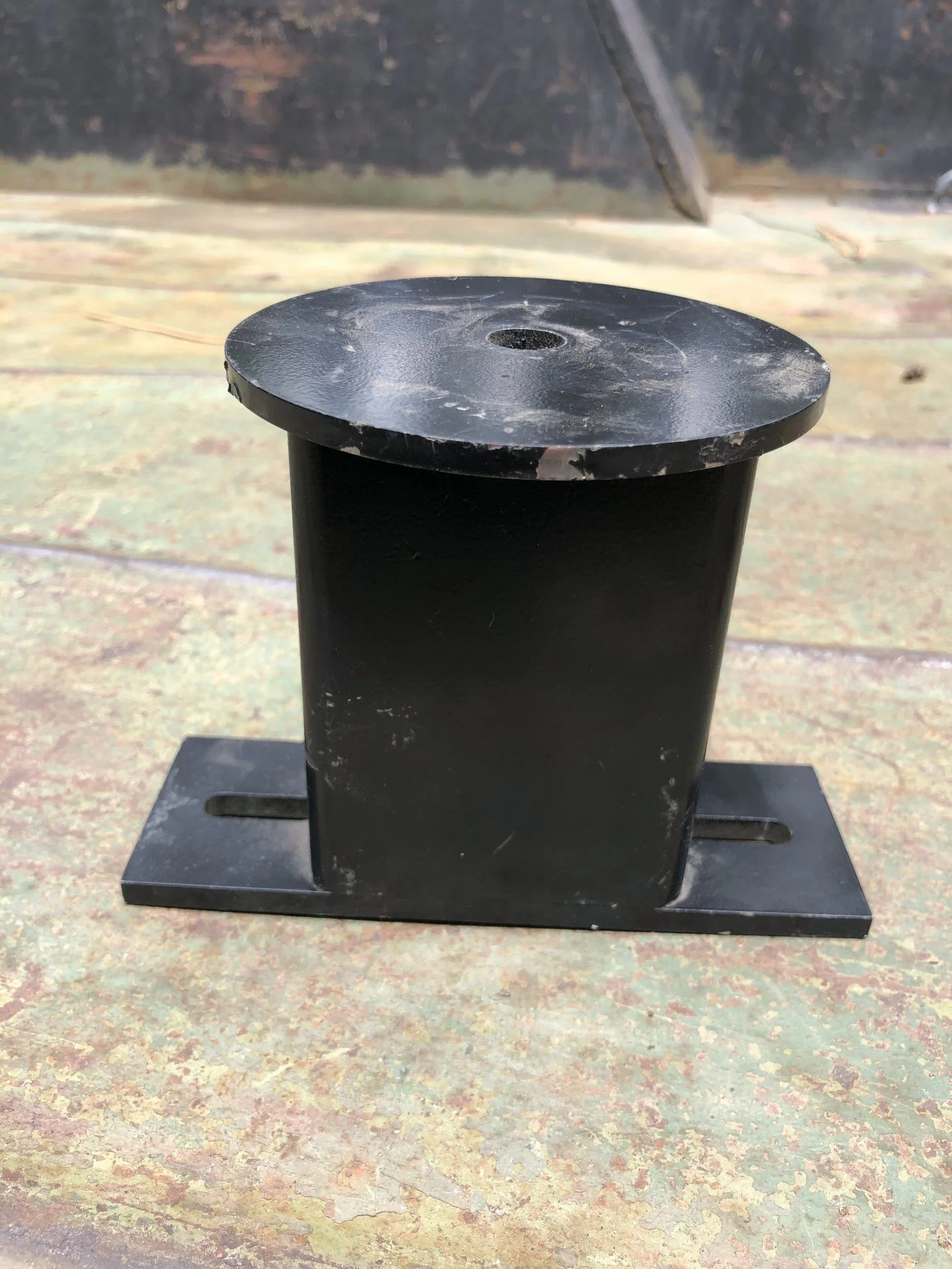

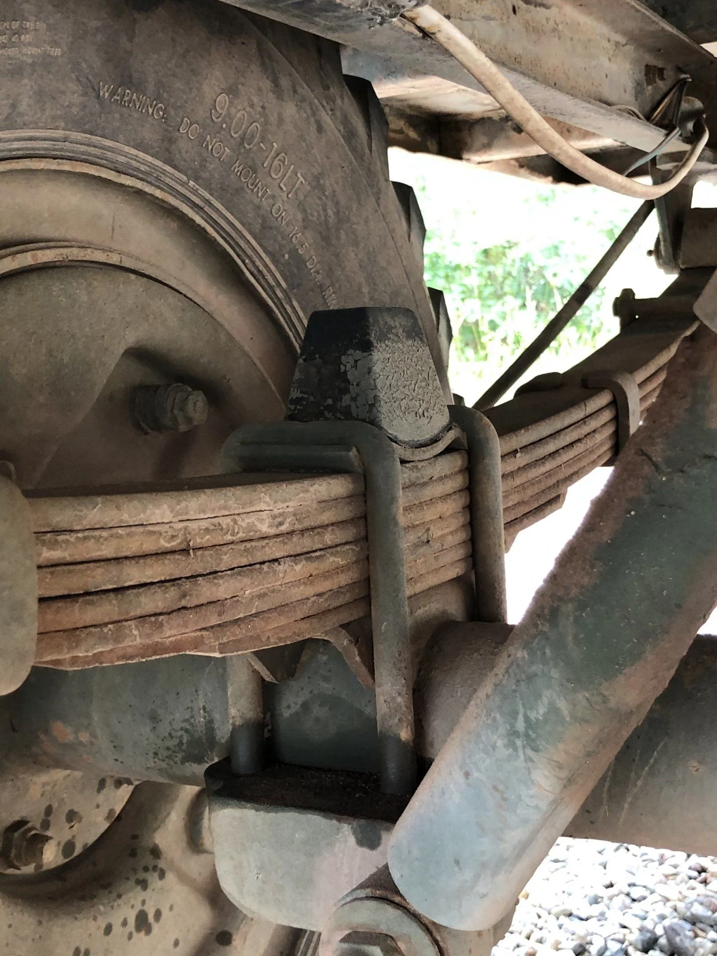

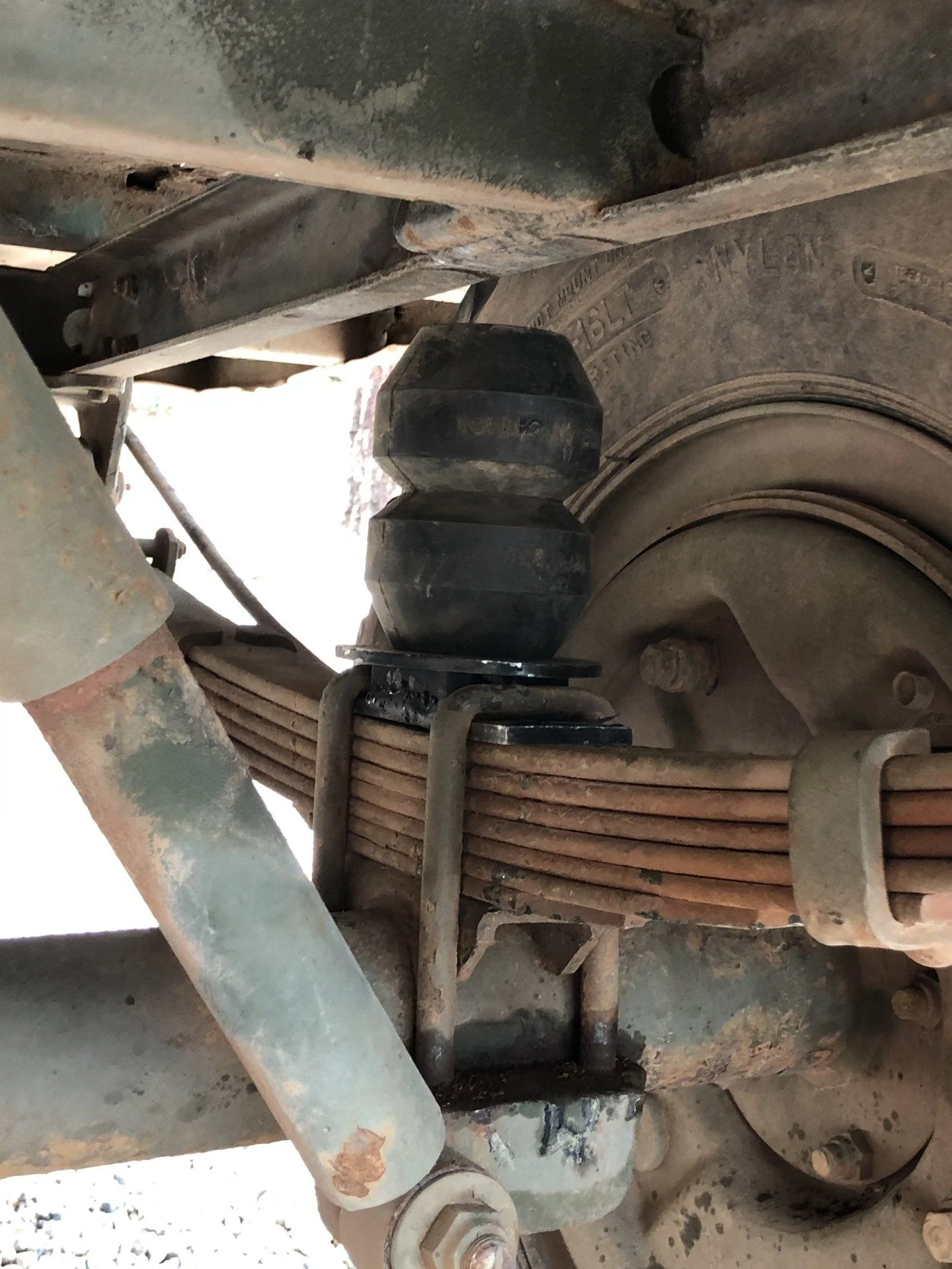

With fire wood season fast approaching its time to make sure the M101a is ready. At some point I lost my right side axle bump stop and I’ve been inverting my spring pack. With a set of overload Timbren’s laying around it’s time to modify and install. Cutting down the mounts is pretty easy. Removing nearly 70 year old u-bolts sucks. Happy to have this done. When the springs unloaded last year off camber it was a little unnerving to say the least.
Left side up next.

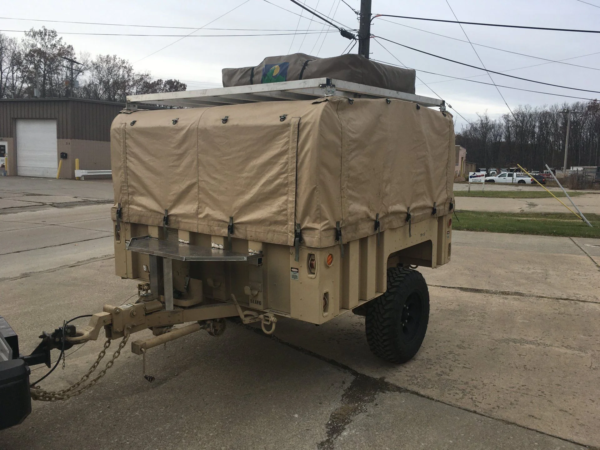

I put in my military trailer a Rtt. I’m contemplating a Truck bed slide.... Then A Extra Roof Rack I have.
So the result will be a Slide out Roof top tent that’s about 4’ off ground, Can be dropped off if want to- then another up top, Plus room Inside for Cargo.....

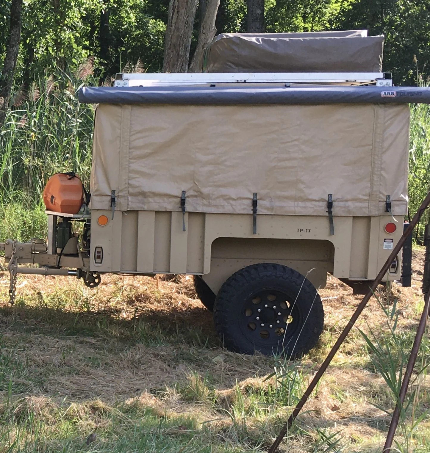

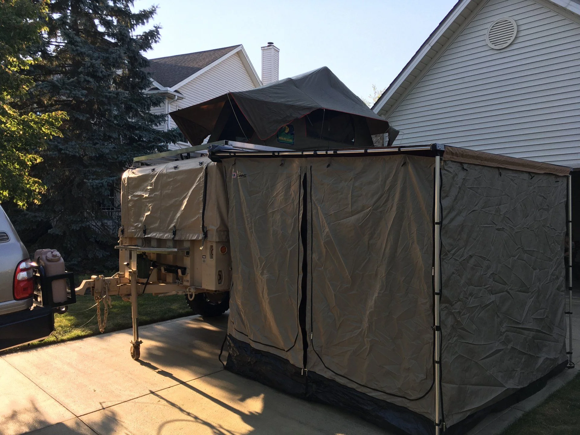

I was pondering sellin it. Yet now I’m in the middle of building it to be a camper trailer. 2 rtts, a annex, a awning w/ deluxe room enclosure and then water & electric.

First load of 2020 firewood is in the books. Timbren mod worked excellent. Trailer was more stable coming down the mountain for sure.
That’s awesome- these trailers are so well built and just the rite size for most chores, or should I say “Cords”
