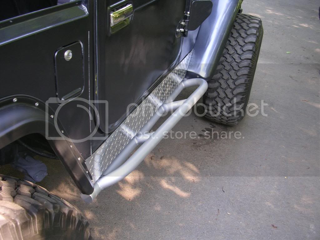

I got my new sliders installed on the rig. We are ready to roll. Minus a legit NC tag...........
