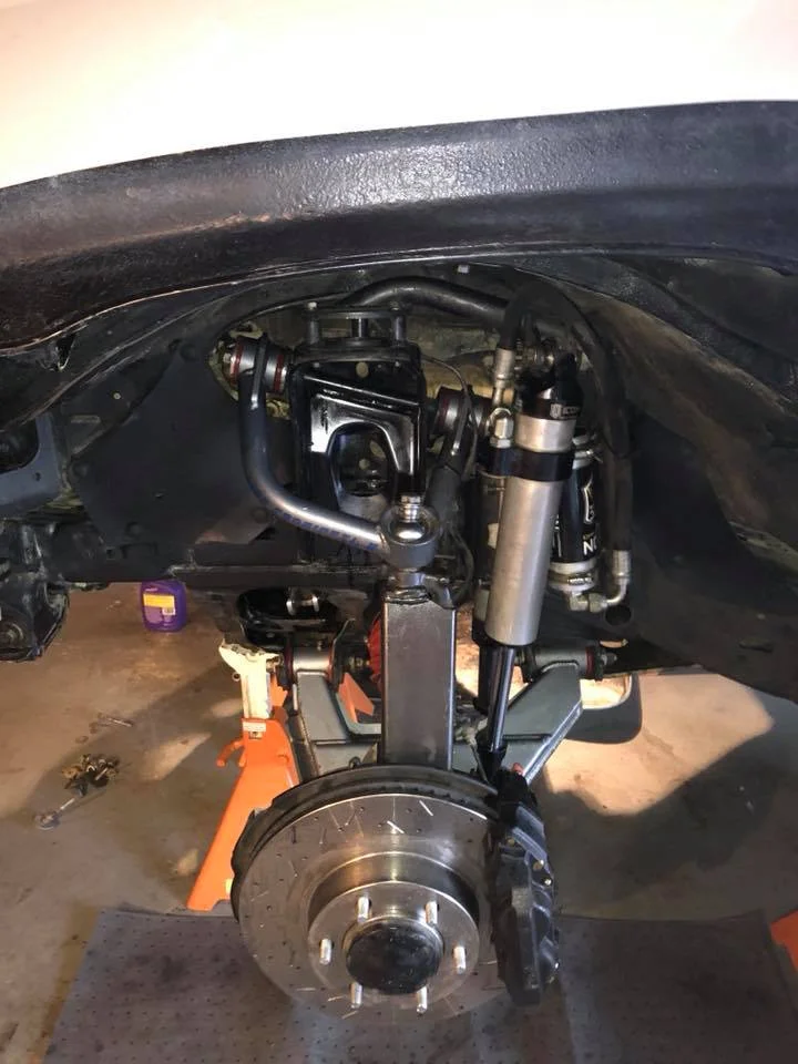

I cleaned my underbits in prep for new tie rods and new coilovers (getting old rebuilt, bought a second set to rotate).

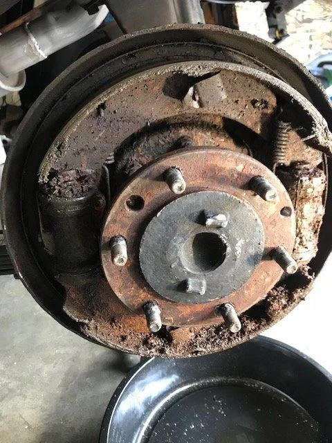

I have been tackling some maintenance on the 40 over the past few weeks. Last week, I decided to replace a rear brake wheel cylinder that had a small leak. Of course, as with all old stuff, I opened it up and pretty much had to do a full replacement. Feels good once done but man it was ugly, dirty when I first got the drum off.
Leaking brake fluid makes for dirt sticking on everything pretty well

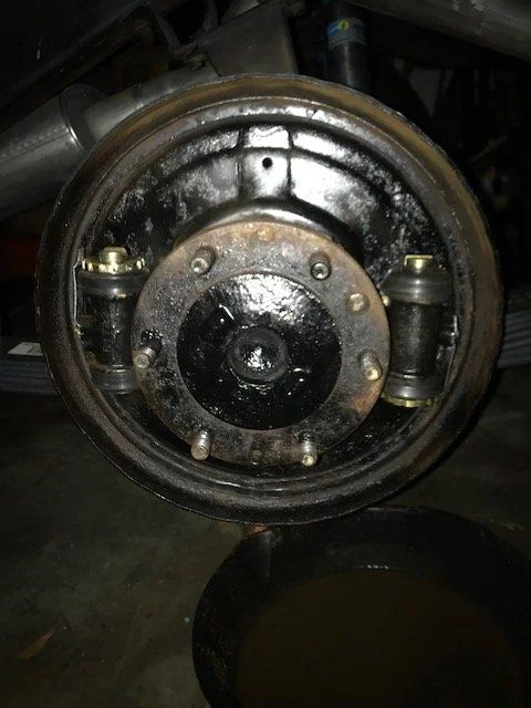

Much better. No pic of the new shoes installed but after bleeding everything last night, it is all buttoned back up.

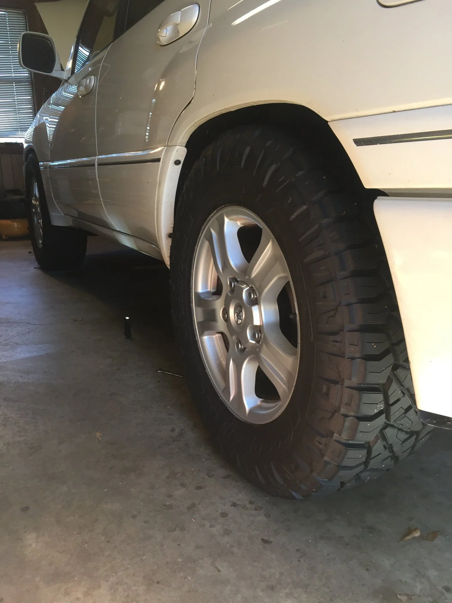

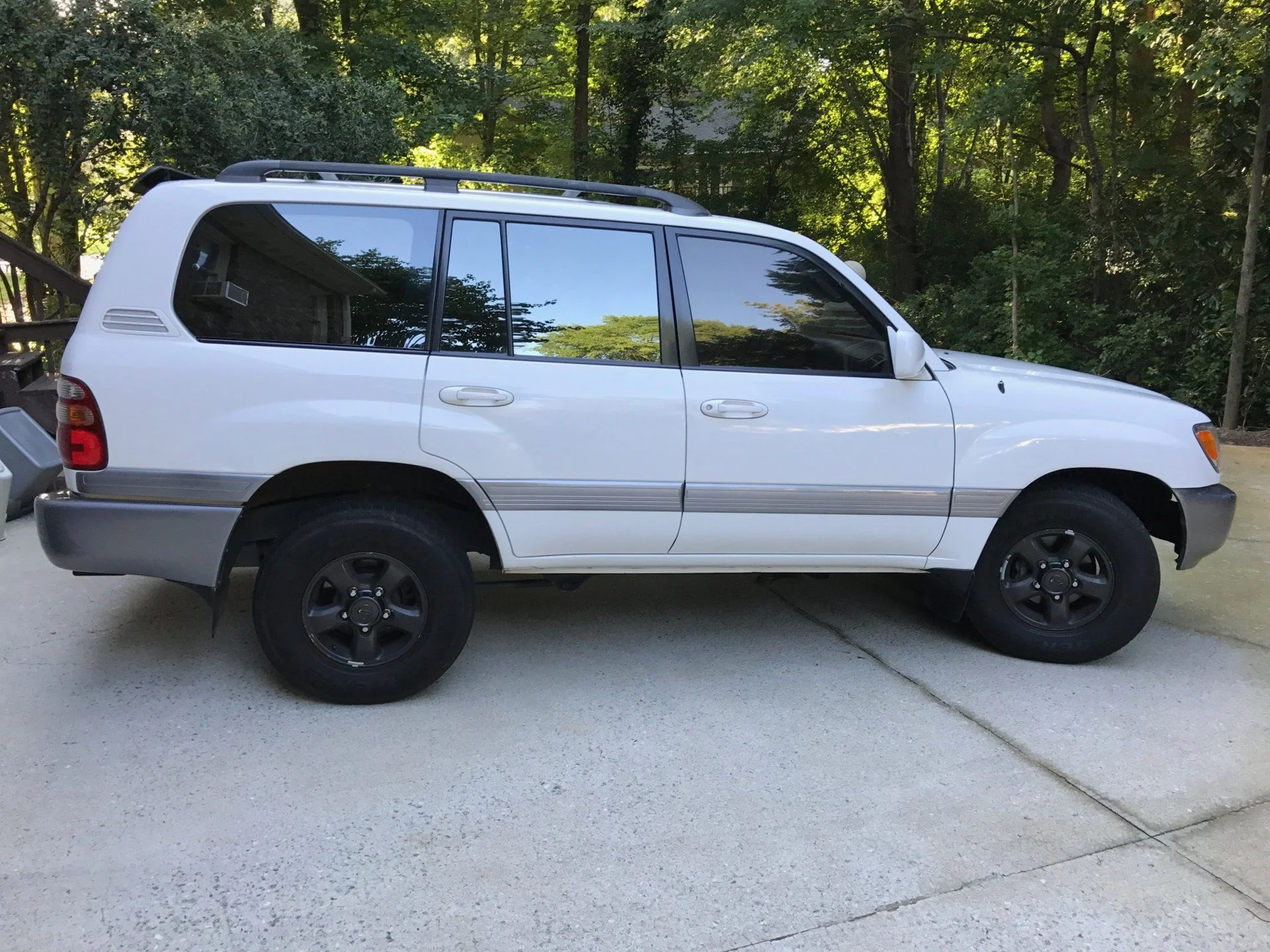

Swapped out tires & rims on the daugther's 100 series with some from a 200 series I found on Craigs List in Atlanta and very pleased with the result! Scored an ARB from a member of ONSC and hope to get that installed while the princess is on Spring Break in 3 weeks!
Also had to take the pressure washer to the underside as she had done a little off-roading in some clay.....
Before:
Today:

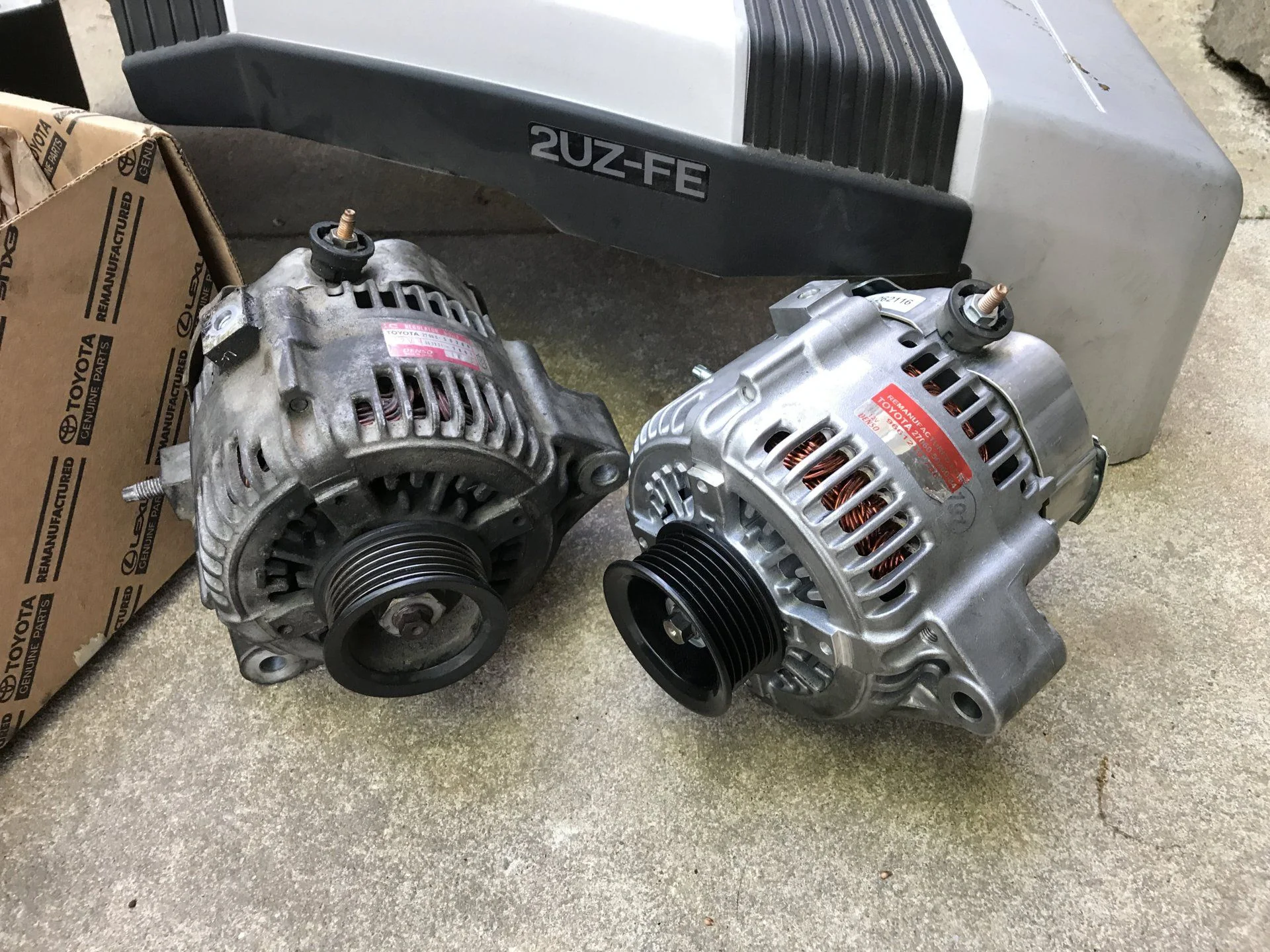

Maybe this thread should be called "What did you fix on your truck this week?". We did a round trip to Charlotte on Saturday in the LX470 with no trouble. Then on Sunday morning after that torrential downpour I noticed the "Discharge warning light" come on.
At first I figured that I had left a light on somehow and drained the battery. But after driving around for awhile it didn't go away. The voltage gauge wasn't plummeting but it didn't look where it should be. A quick stop at O'Reilly confirmed that the alternator wasn't putting out what it should be.
I was impressed with Toyota engineering and/or my newish Interstate battery for getting us 20 miles home without a hitch. On Monday I sourced a new reman Denso alternator from the local dealer (didn't want to wait days for online). Our Upstate Cruisers discount is still in full effect at Ralph Hayes but they did not have one in stock. Toyota of Greenville did and helped me out on price when I asked about UC discount too.

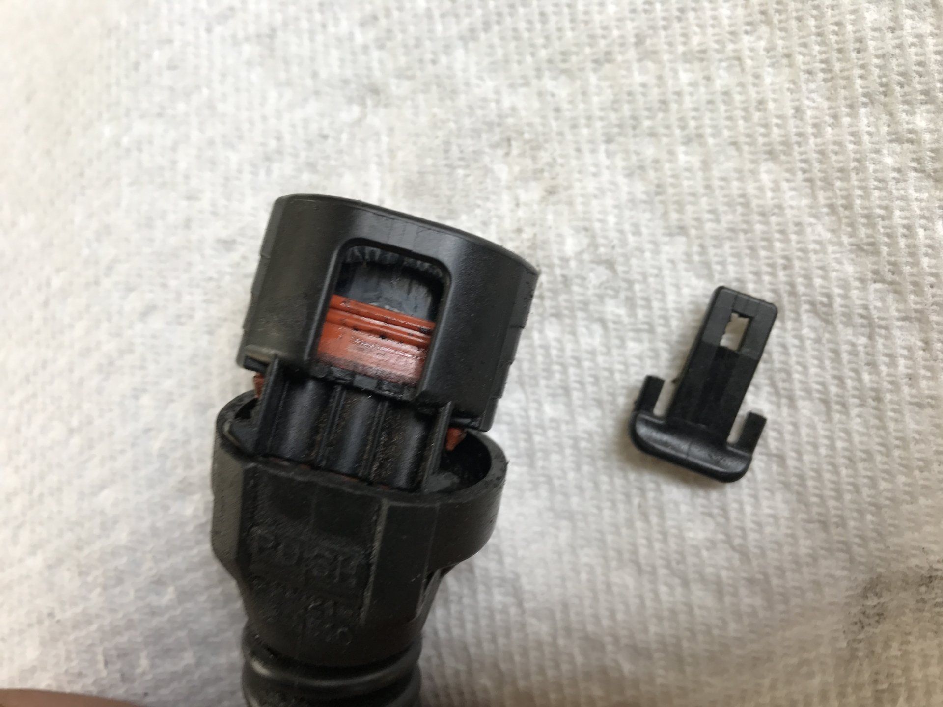

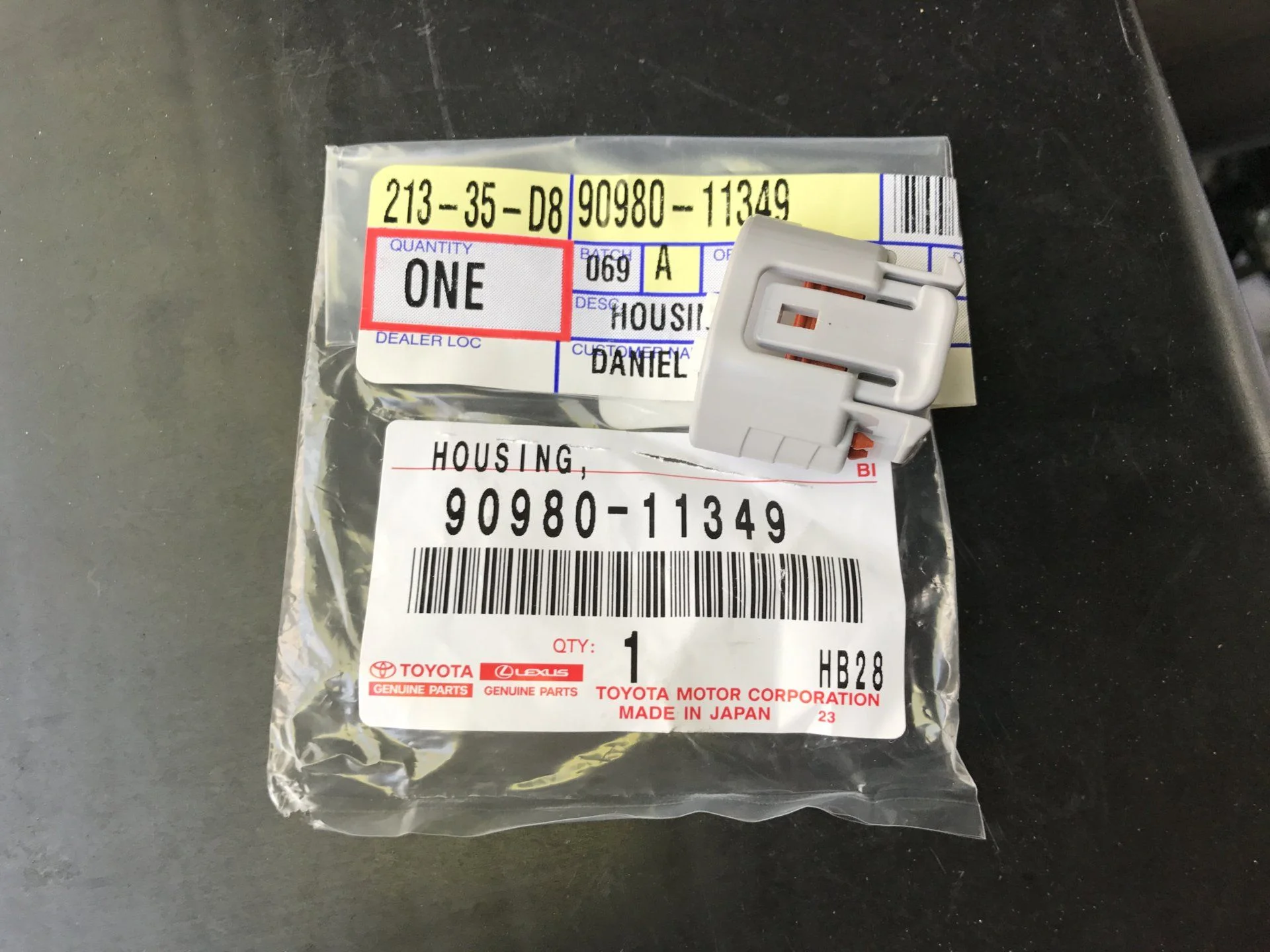

The new alternator went in without a hitch, but when I went to plug in the sensor wires, I realized the plug tab was broken. In fact the whole plug was a brittle mess which made it easy to dissect it and install a new clip. But I had to wait another day while the local dealer ordered one. Part number 90980-11349 if it happens to you. I guess 16 years of heat dried out the old one.

Glad you didn't get stranded. Have you looked into replacing the alternator brush? I know that is a thing in the 80's, not sure if it is a serviceable part on the 100's.
Yes I thought about trying that. I believe they can be replaced on the 100 too. But I kinda wanted new bearings and regulator too.
I also thought about taking it to Dean's Alternator (near Trollhole's) to have them rebuild it.
But I was stuck ferrying the family around and just wanted to get the LX back on the road quickly, so I just decided to put a whole unit in.
I picked the Toyota OEM (Denso reman) hoping I'll get another 185K out of it. As opposed to the aftermarket alternators the auto part stores are selling.

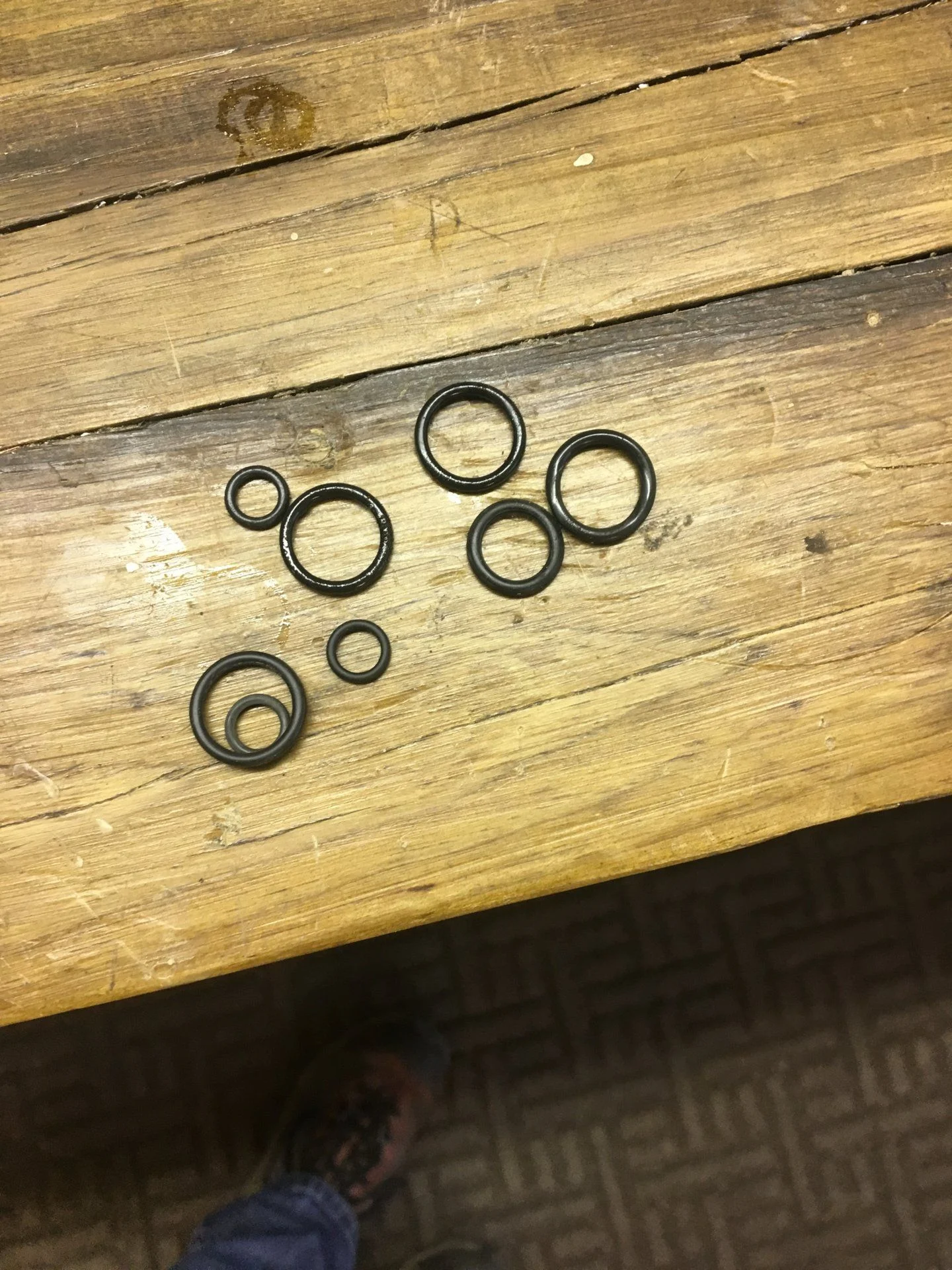

I failed to mention that I also changed out my AHC fluid over Easter weekend after fortuitously stopping by Trollhole's that Friday just in time as he was about to start doing it to his LX470. So got to be a helper and see firsthand how it went. All went smoothly until I had to drain the actuator and just couldn't get the 10mm to loosen the nut....ended up using the ratchet which resulted in probably half a liter of AHC fluid spraying all over me and the vehicle/floor......past that it went flawlessly!

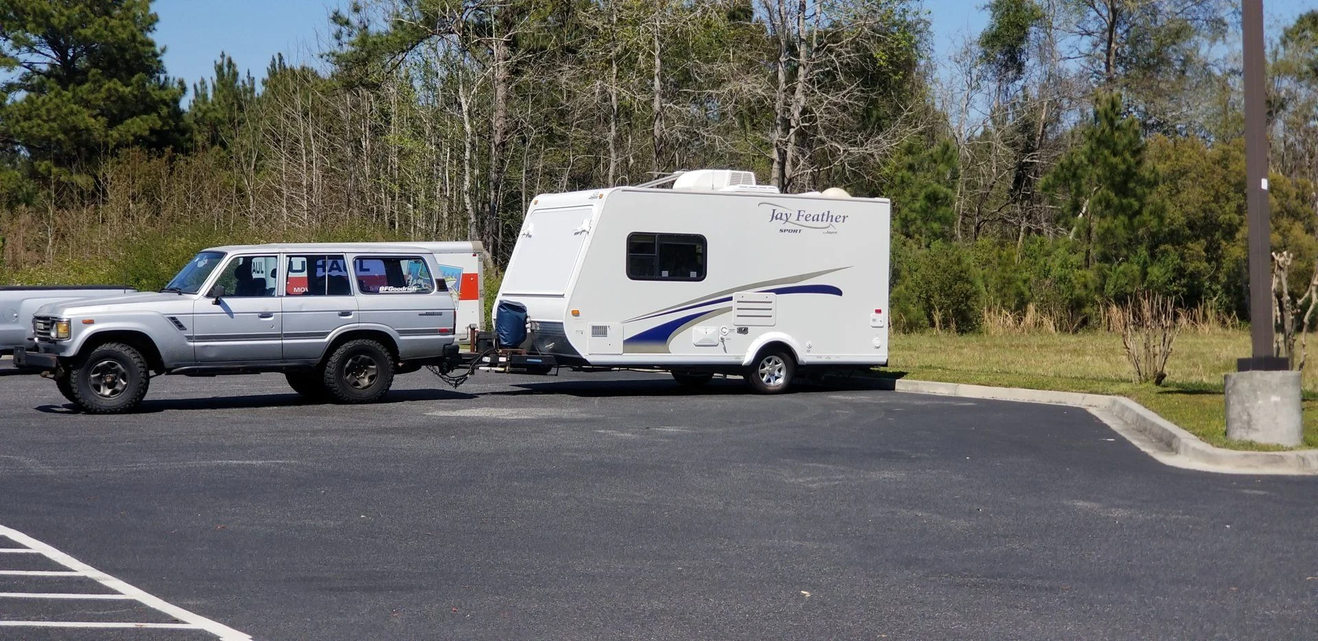

Installed a trailer brake controller, wired it up, and drove 3 hours to pick up a new to us hybrid travel trailer. The old 2F pulled the trailer home steadily at around 60mph until we saw an incline, them, slower going. But good temps and no hiccups all the way home. Trailer weighs about 3100lbs as is.
Posted this in the 60 section, but thought some of you might like to see.
Installed a trailer brake controller, wired it up, and drove 3 hours to pick up a new to us hybrid travel trailer. The old 2F pulled the trailer home steadily at around 60mph until we saw an incline, them, slower going. But good temps and no hiccups all the way home. Trailer weighs about 3100lbs as is.View attachment 1938211
