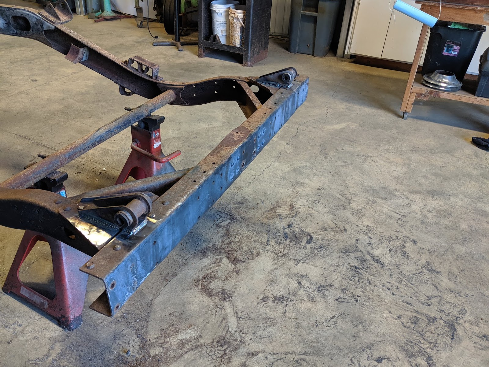

The Build Phase has Officially Begun!

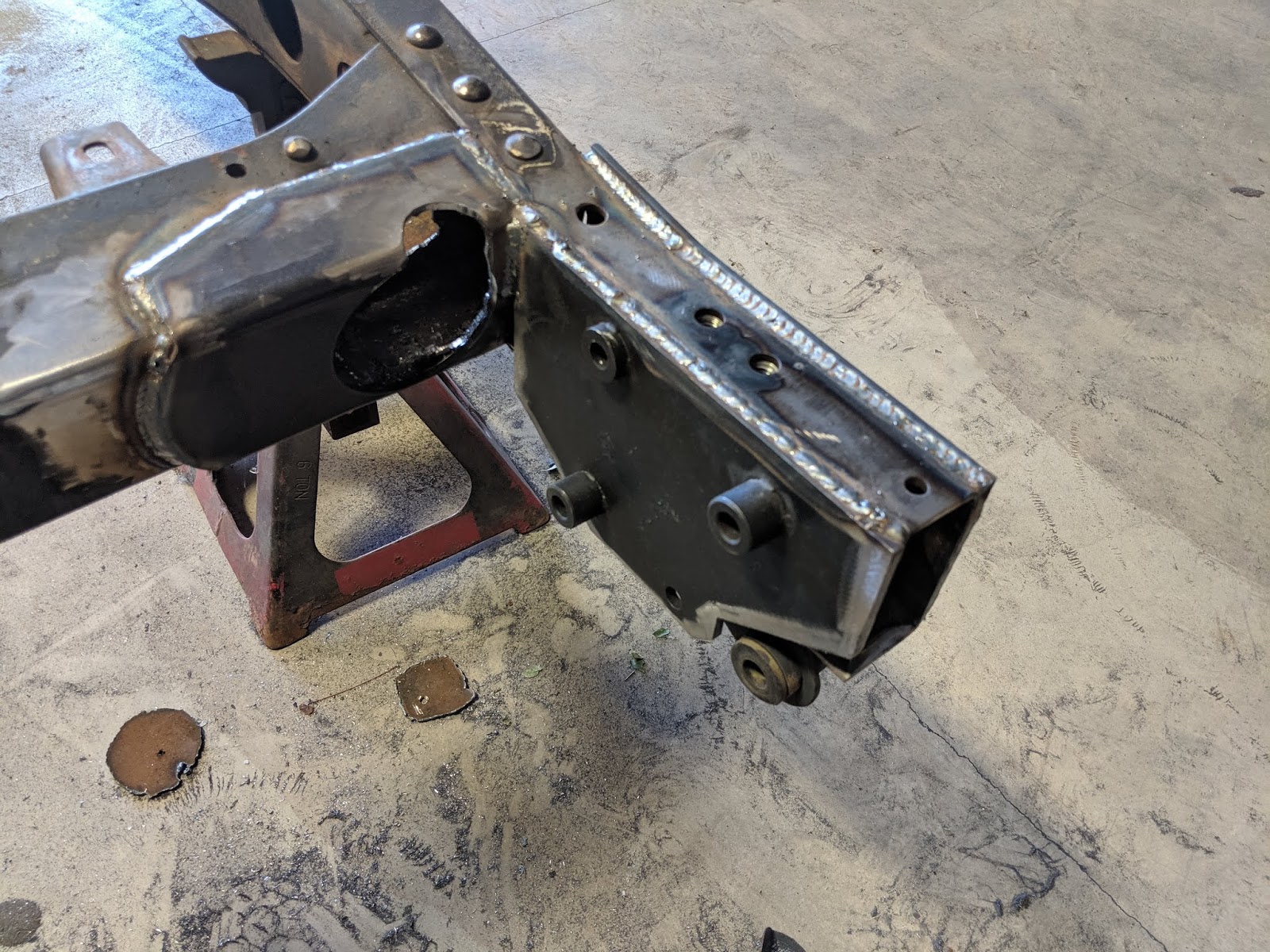

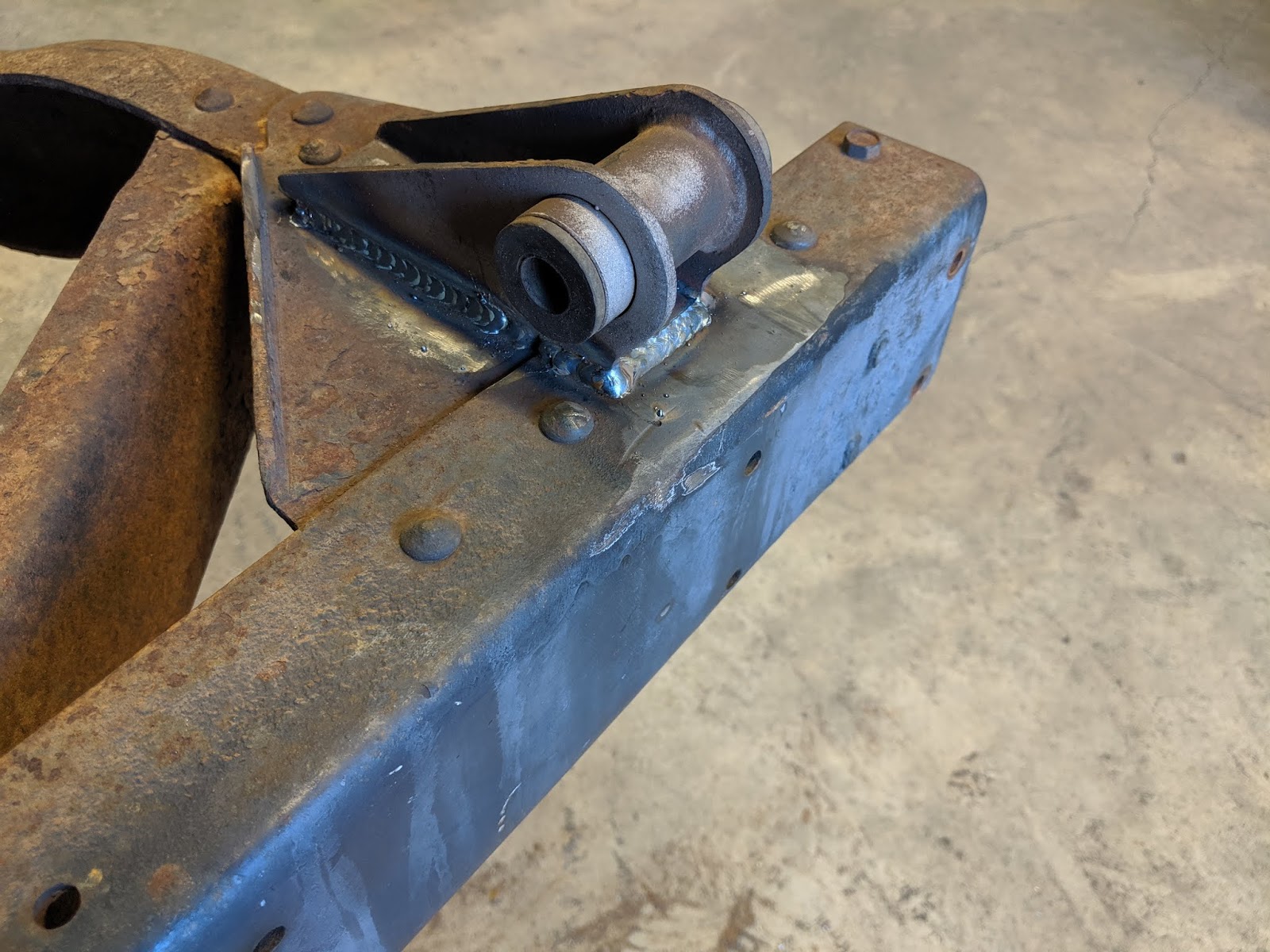

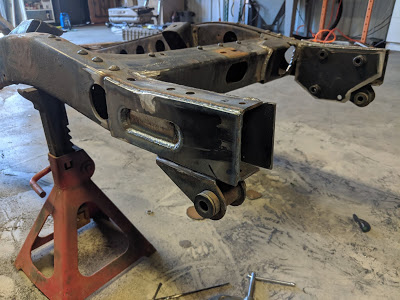

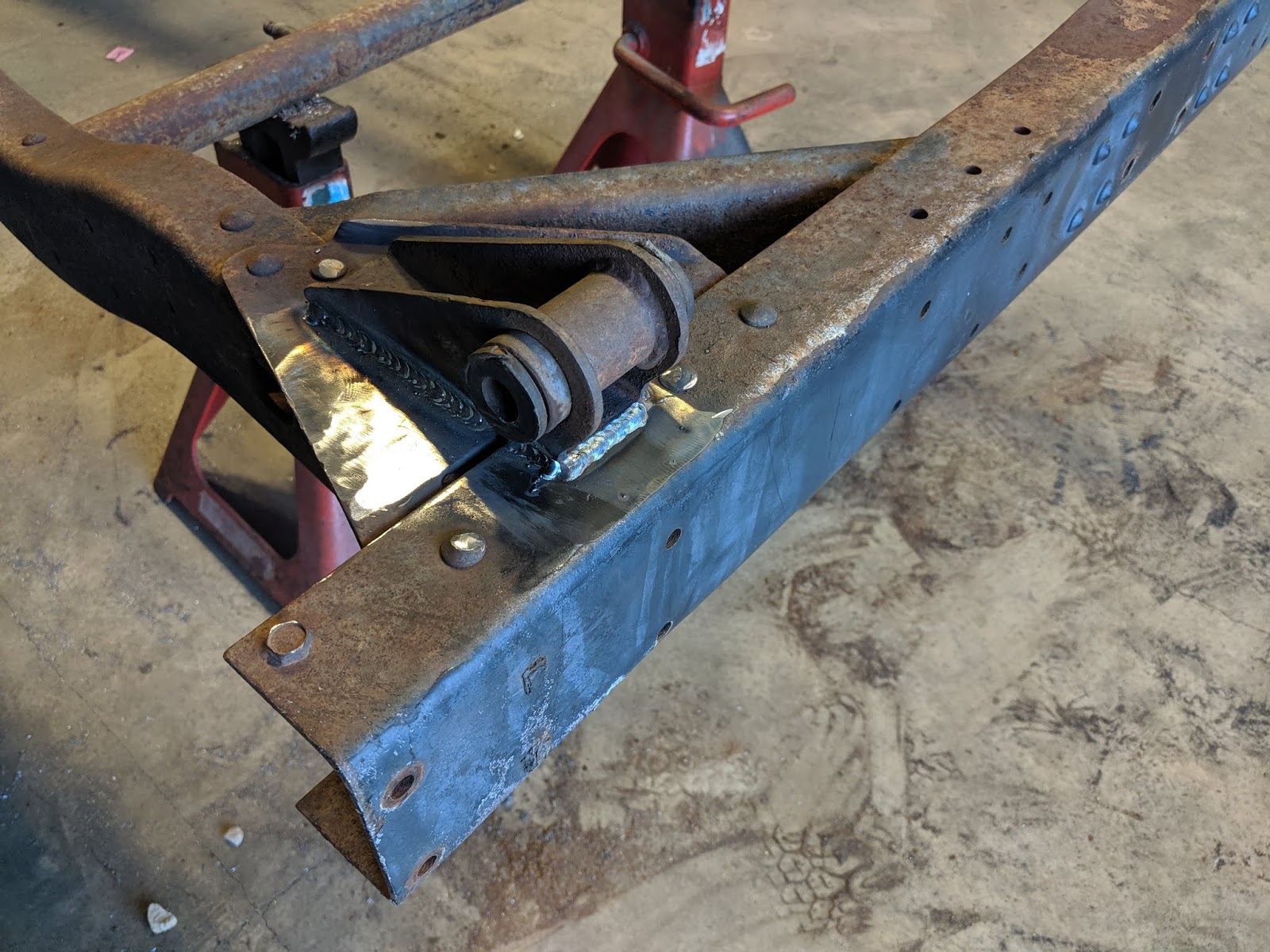

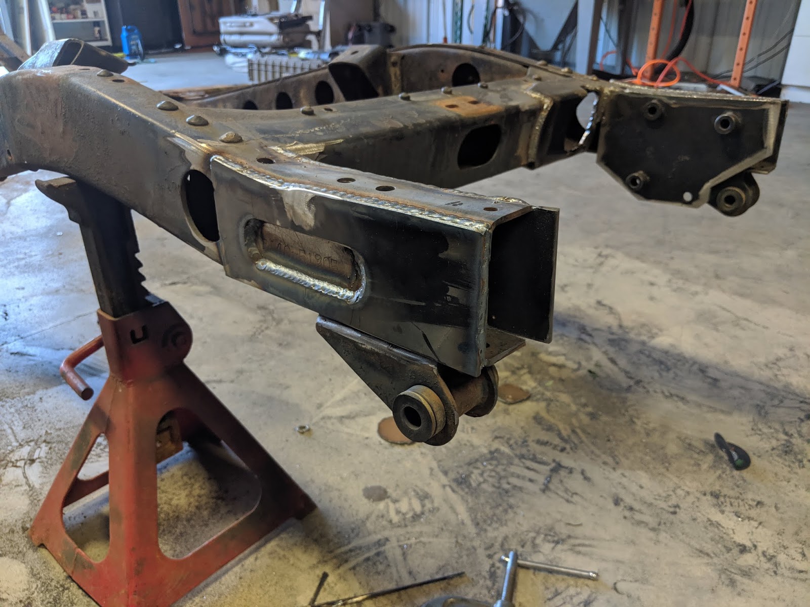

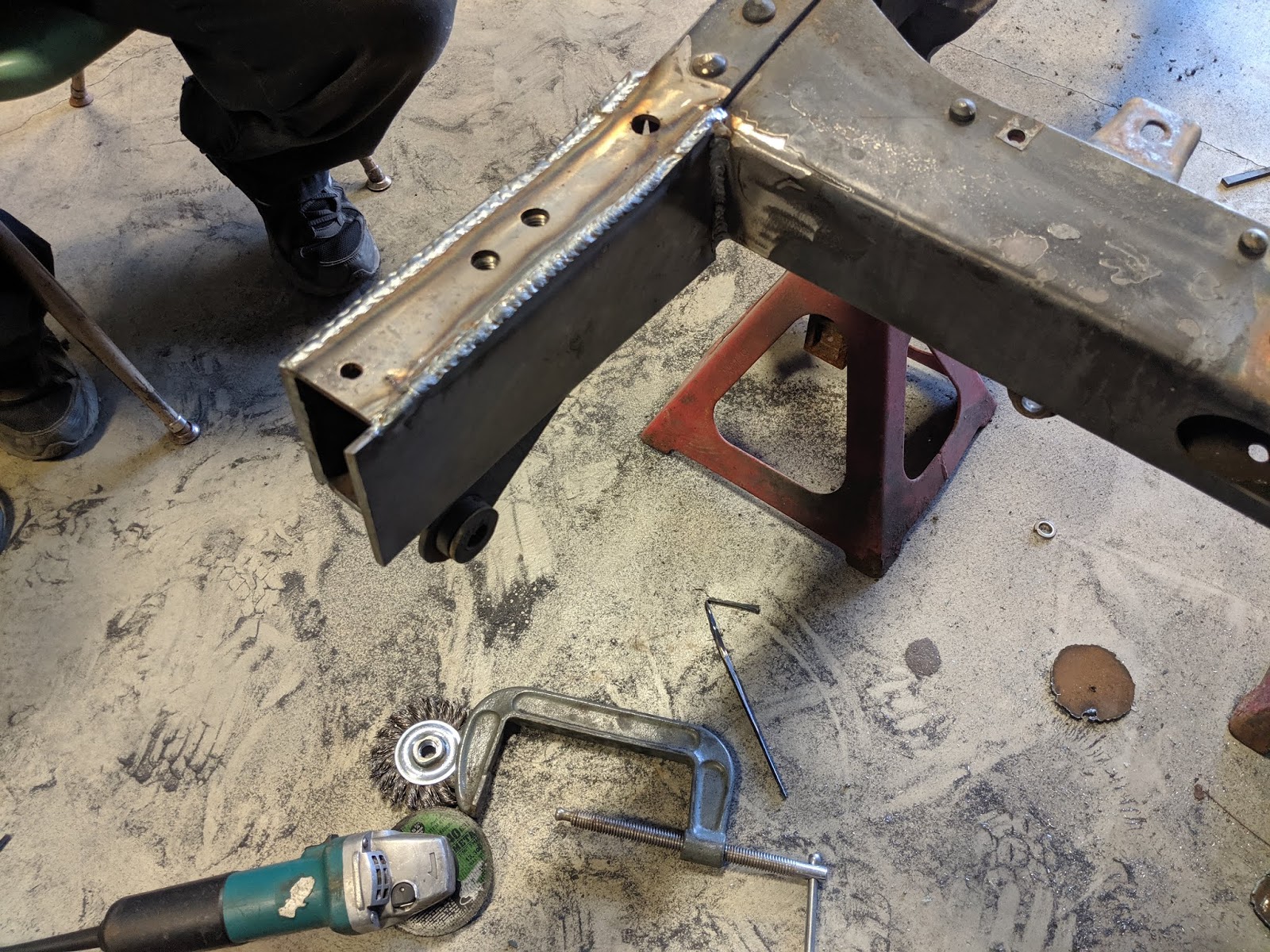

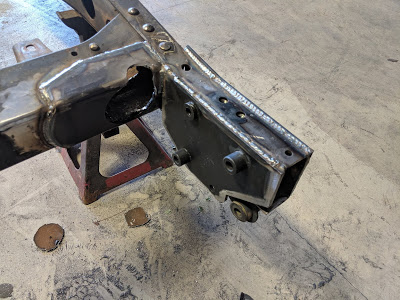

Chassis Mods are Done!
Well with more than a little help from my friend @hairy_apple, the frame modifications are complete and I just have 12 bolts and four bushings to pull before I can drop this thing off for powder coating.
Ryan does some outstanding fabrication and welding. He was able to salvage the ridiculously poor quality Saginaw power steering "kit" into something usable. My rear shackle mounts are reversed and the front chassis forks are fully boxed.
