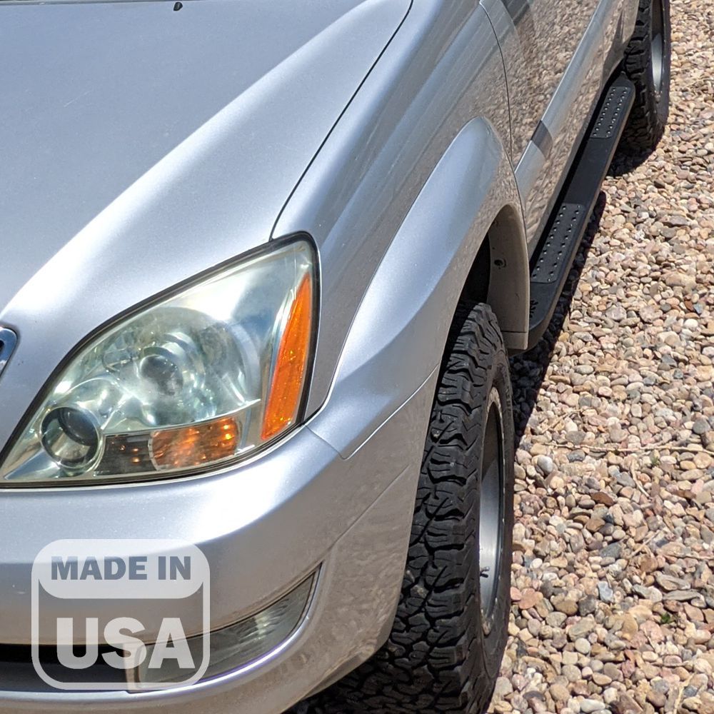

I really like how high and tight those sliders are. You happy with them? Can you link them up please and thank you.
DIY 70 inch Marlin Crawler Rock Sliders. We welded them in very tight to the doors. The bottom seals slightly touch them when opening/closing but no clearance issues at all.
They are great quality but if your running a 34” tire or bigger, you’ll most likely need to cut them back some depending on wheel offset.
I'm only on 285/70/17 so no worries. But they're not even close to the tires.
The Slee’s putrude further forward than the body mount. It was a PITA turning, especially turning and reversing. When I first put them on the would rub even on 285/70r17 but that was mostly because of the SCS wheels (-38 offset) the previous owner had.
Here is a pic with a 285/70r17 on stock 4 runner wheels, you can see how close it was even with those that had a bunch of positive offset.
Not sure how you set yours up but mine are nowhere near the tires. I don't think I'd have a problem with 34 or 35s
