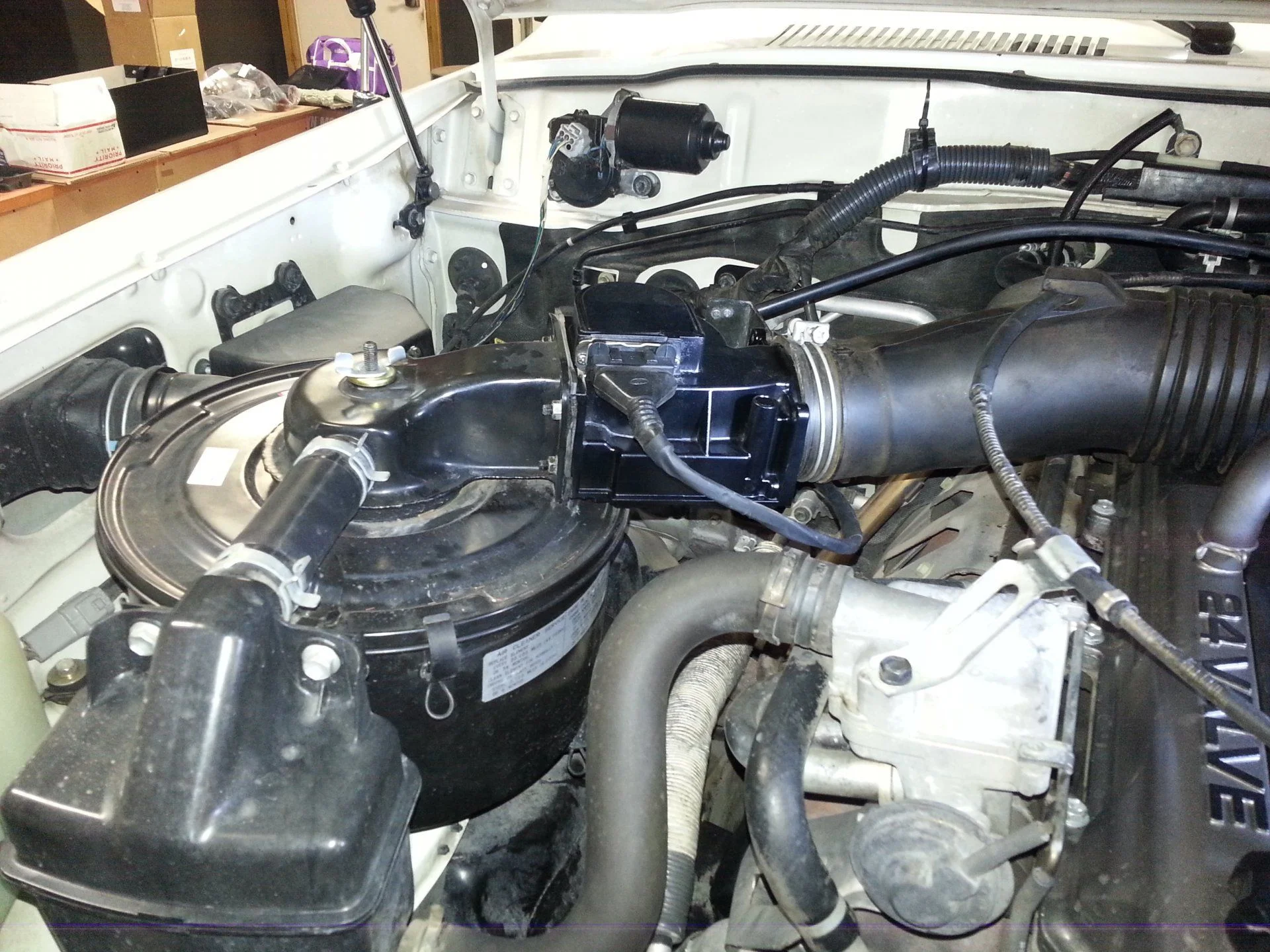

Never got around to pulling the VAFM to meter it though I am pretty certain it is the cause of my intake air temp code so I need to find a good working replacement that ISN'T $700 from Mr. T.

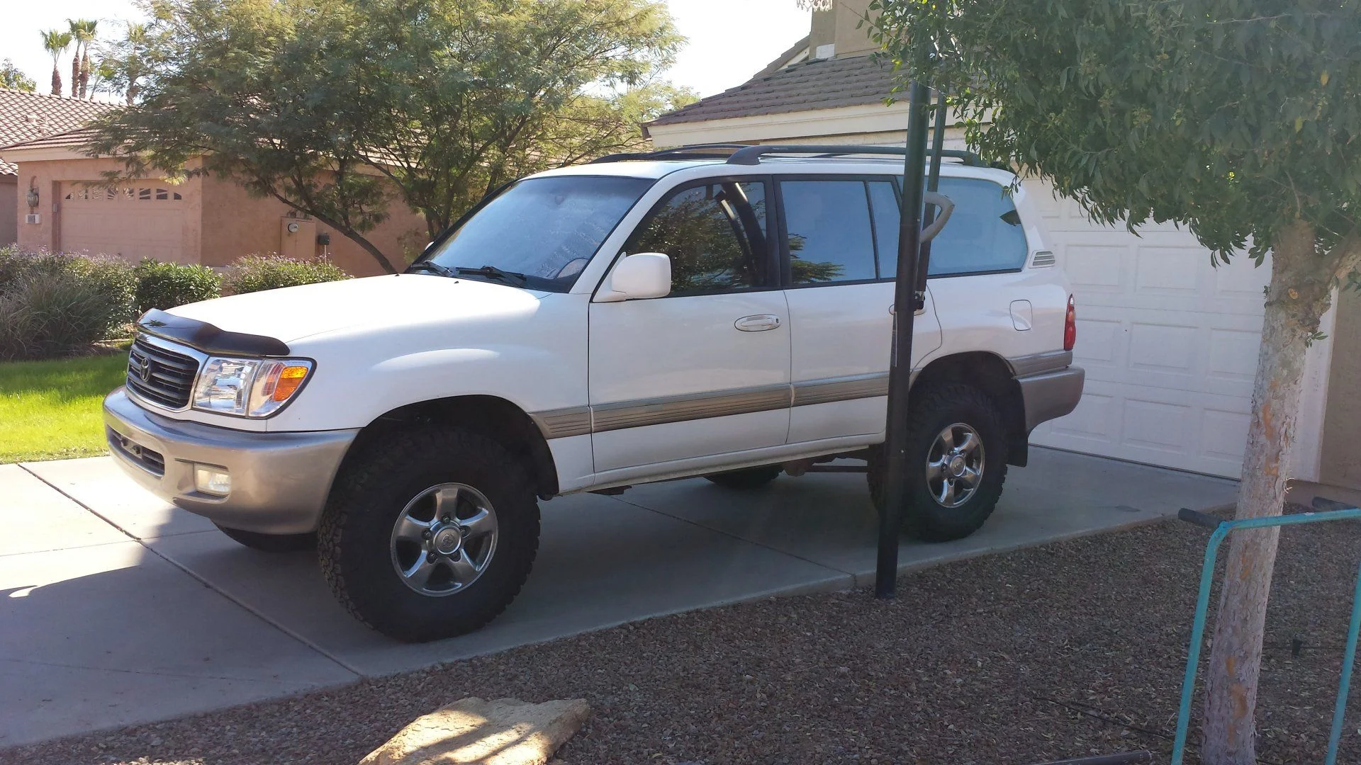

Went to the Italian trap yesterday. It was a perfect day for wheeling and soaking up the sun!

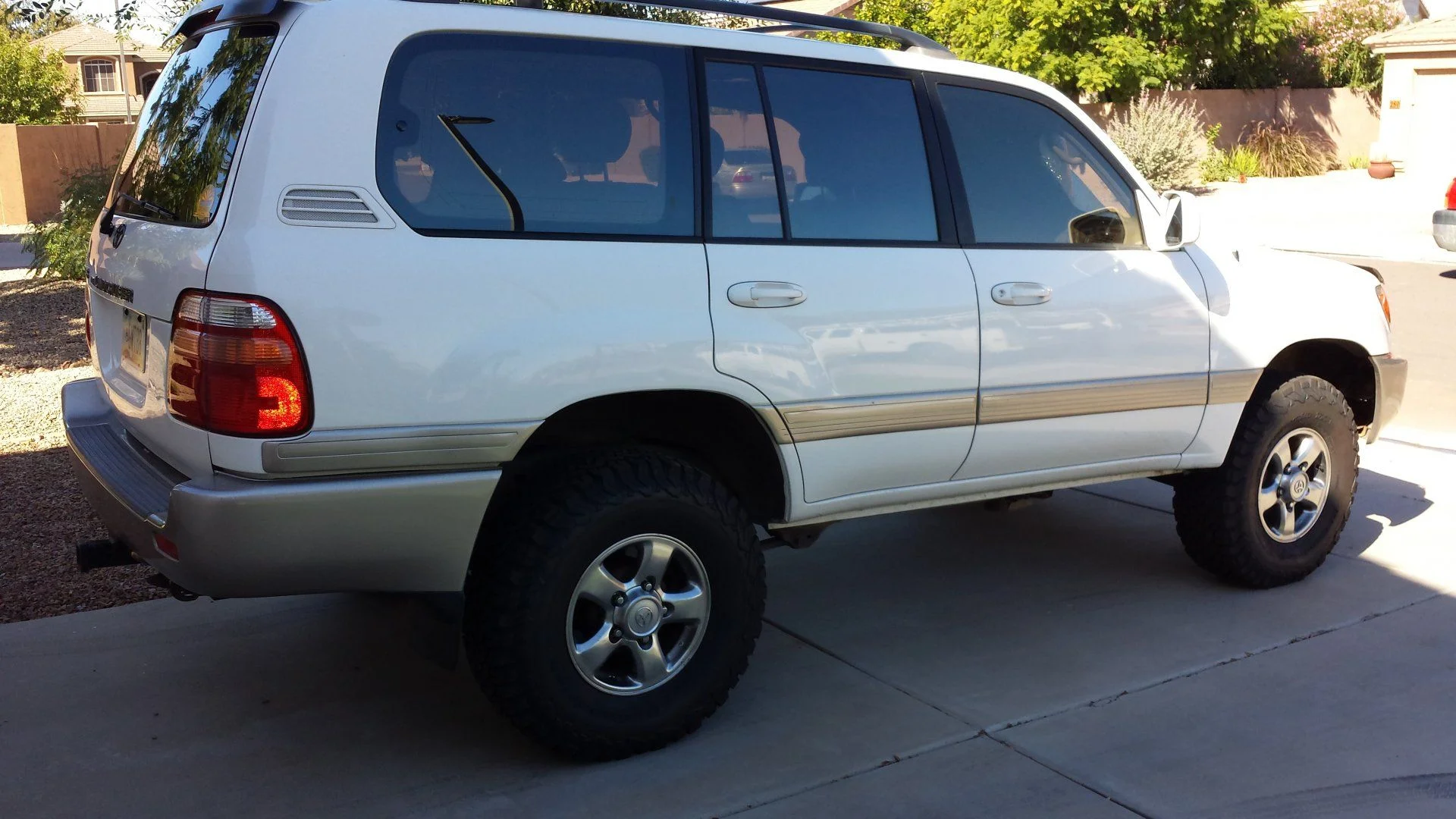

OME medium front heavy rear with slee 30mm spring spacers front and rear. It looks very proportionate with the 35s and rides great.
It looks great. What did you do for caster correction if any?

Finally got the wheels completed on OSO and the replacement for the VAFM arrived as well. Thanks slow95z. No more engine codes...:D

Lets see...replaced the EGR and the vacuum modulator and the vacuum lines trying to eliminate the CEL code 71 and whala...FAIL. CEL back on the return trip from CBT yesterday. Still throwing a 71...Scratching my head where to look next.

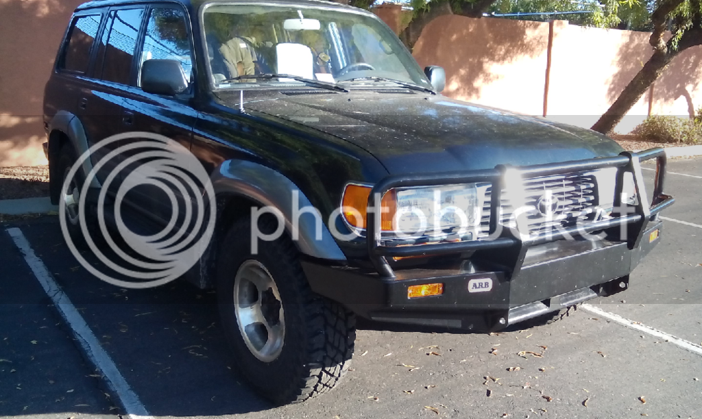

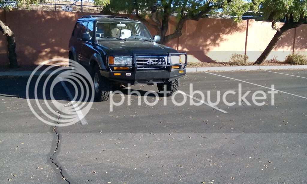

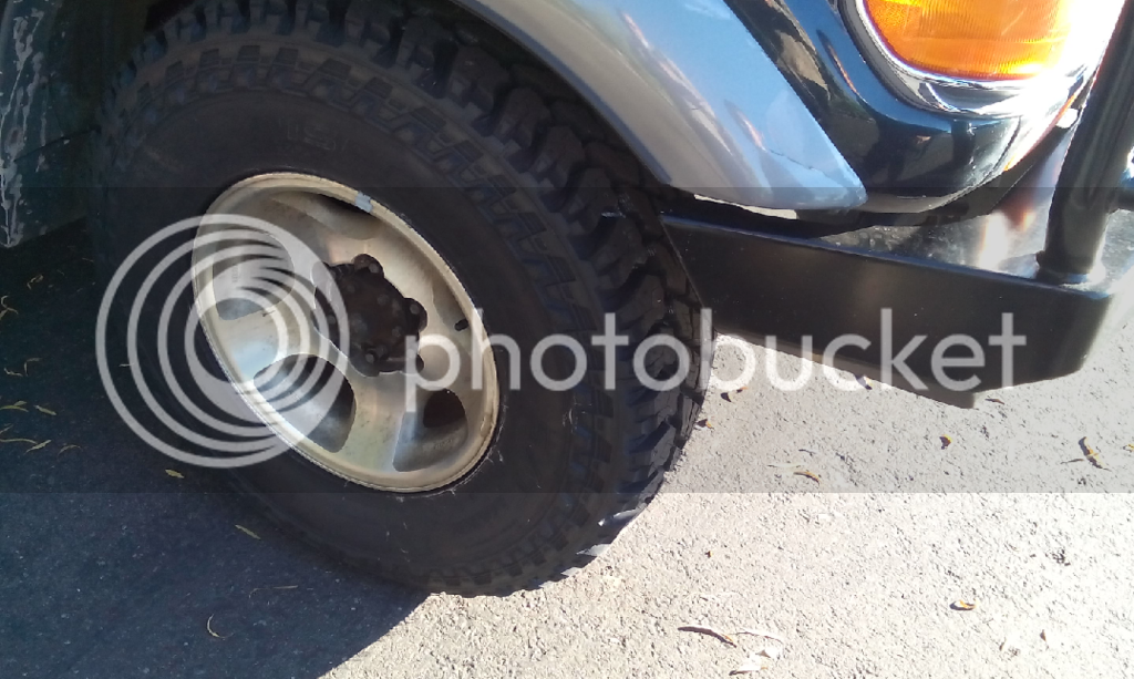

New ARB up front; courtesy of thx138, and a new set of 255/85/16 Cooper Discoverer S/T Maxxs.
Wheee!!! :D
Now, I'll agree that from a ways off, the S/T Maxx's don't look all that beefy and aggressive.
In fact, I specifically went with them instead of the Toyo MT's, because I thought they'd probably be better for the majority of pavement travel vs the terrain the MT's would excel in.
However, I was pleasantly surprised by just how deep the lugs are!
