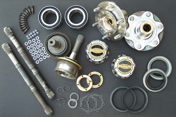

Swapped out the transfer case today, everything fit and bolted up because that was the way it was designed.
Next is the manual hub swap.
Next step is ordering the parts to convert the front diff to manual locking hubs. Not cheep, but once done, I will have a worry
free (air conditioned) wheeler till the kids take the keys away. :clap:
Probably not this vender, but what is needed.
Great job 👏
Did you find the right wiring print to install a manual switch for the ADD or are you going to just leave it engaged until you put manual hubs on it?
Great job 👏
I have not been able to locate the wiring diagram for the ADD. Right now it is unlocked. Somewhere in my notes I have two pins on that puppy that you can reverse polarity to lock/unlock it. I will lock it up after the manual hubs are installed.

First box of goodies showed up yesterday, second is due today. Parts are way fun, installation is another story, but look forward to banging this one out.
And gone will be the plastic hubcap...
And we have axles! Shout out to Yotamasters for providing the complete parts package to make this happen.
I highly recommend for a Taco 4runner source.
