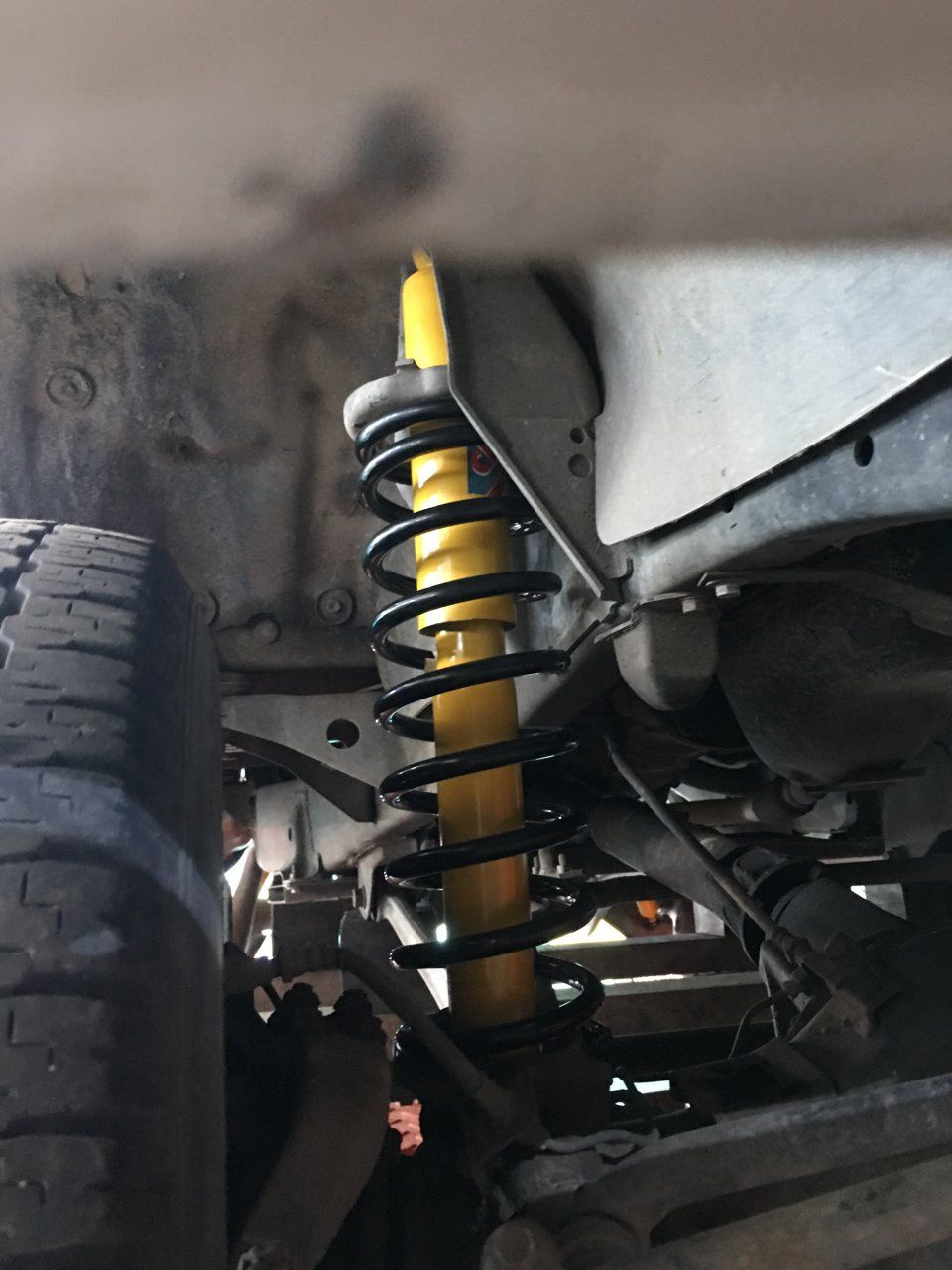

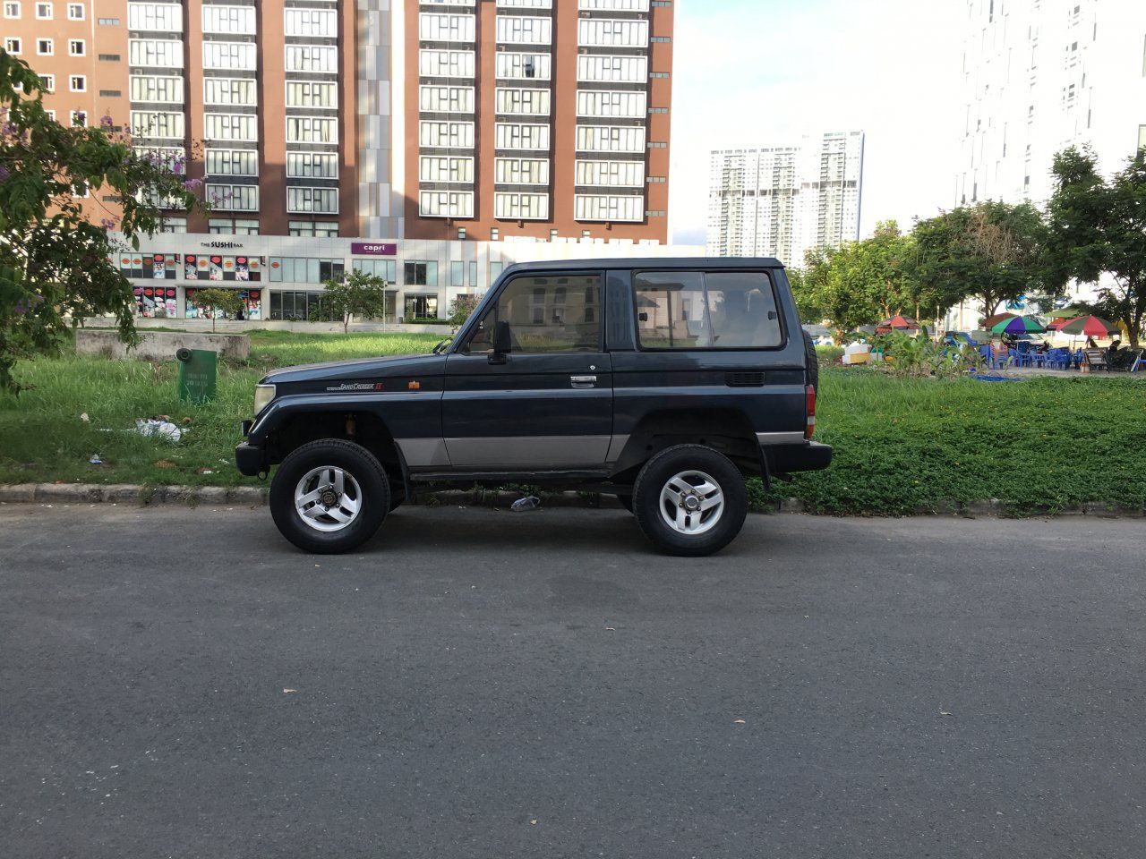

Hello from Vietnam, today I just installed OME front and rear suspension. I don't know if I got the right kit for my Land Cruiser or not, This is the OME N77 front and N79 on the back, it goes with 2872 and 2873 springs. The ride is significantly better but since it lifted the LC about 2 inches it a bit wobble on an uneven road.

Looks good. If you have a wobble now, it may be the front knuckles now need a rebuild cause you have
shifted them from there wear spots, usually when something new goes on the old worn shows up. With the
coils I don't know about whether castor angle has changed, I only know leaf springs and with the OME
kit in my 60 I had to add a 2.5 deg shim. You need a set of mud tires and you are good to go!

@bachquang. You will need a caster sweep to determine how much caster correction is needed.
For every 1" of lift, you will need approx. 1.7* of positive caster correction. Did you measure the heights before/after the lift?
it was 27.2" tall up front and 29" rear, now it is 30.6" Front and 32" rear, quite a noticeable lift which give it such a weird looking with those tiny 31 inch tires
If you allow 1" of sag for the old springs, these new ones gave a solid 2" lift, meaning that your caster angle will be out 3.4* +/-. 3* positive caster is a good number to aim for. Also bigger tires tend to like a little more caster. I think 33s would be great on your rig. Good luck.

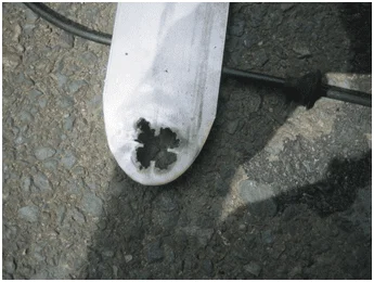

Installed a new antenna while the inner fender is off. Not too difficult but a little fiddly.
Crude antenna locking nut tool: 4 tangs.
Old antenna out
New antenna in place inside fender
Thank FJ
Thanks FJ
