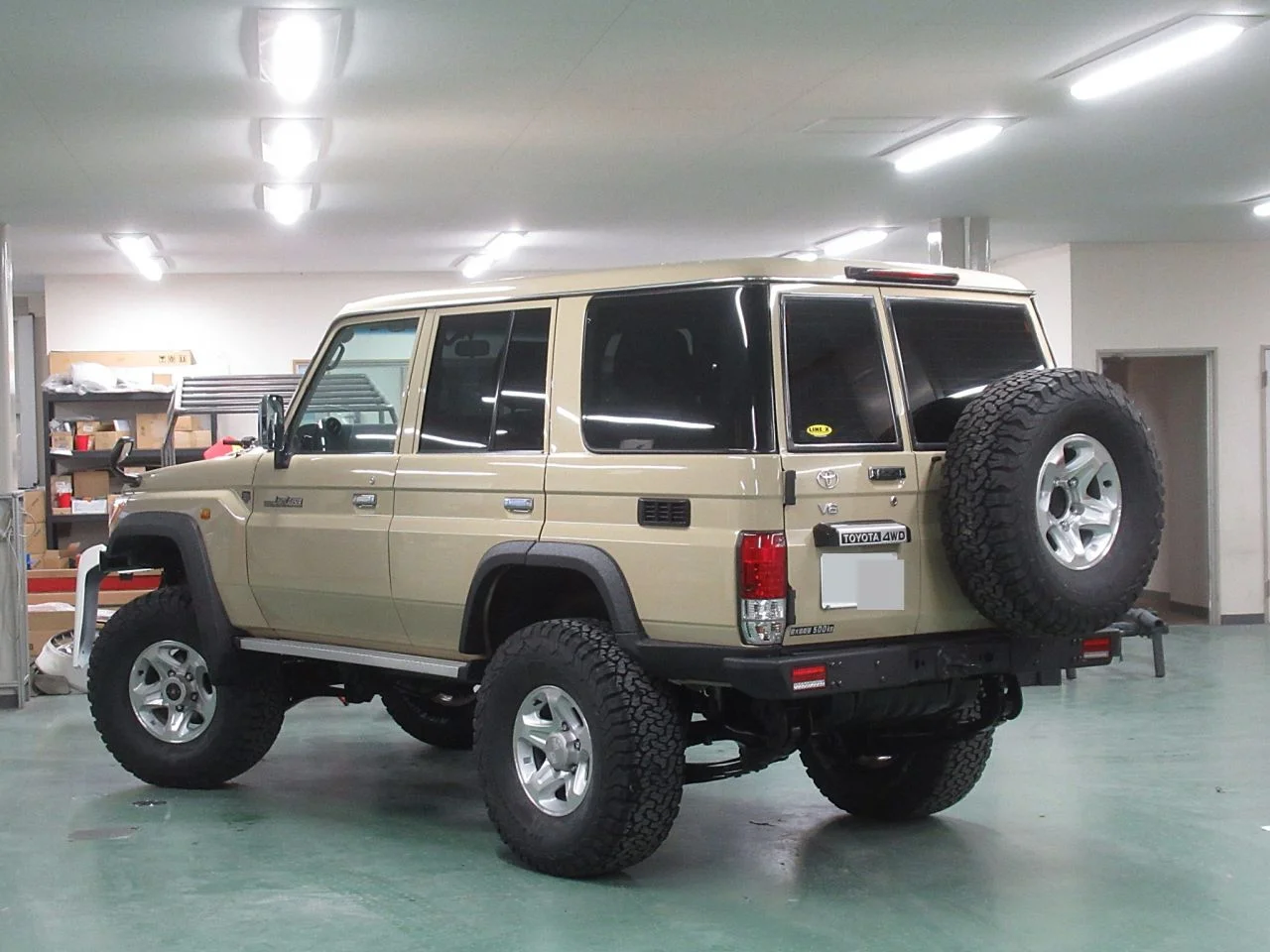

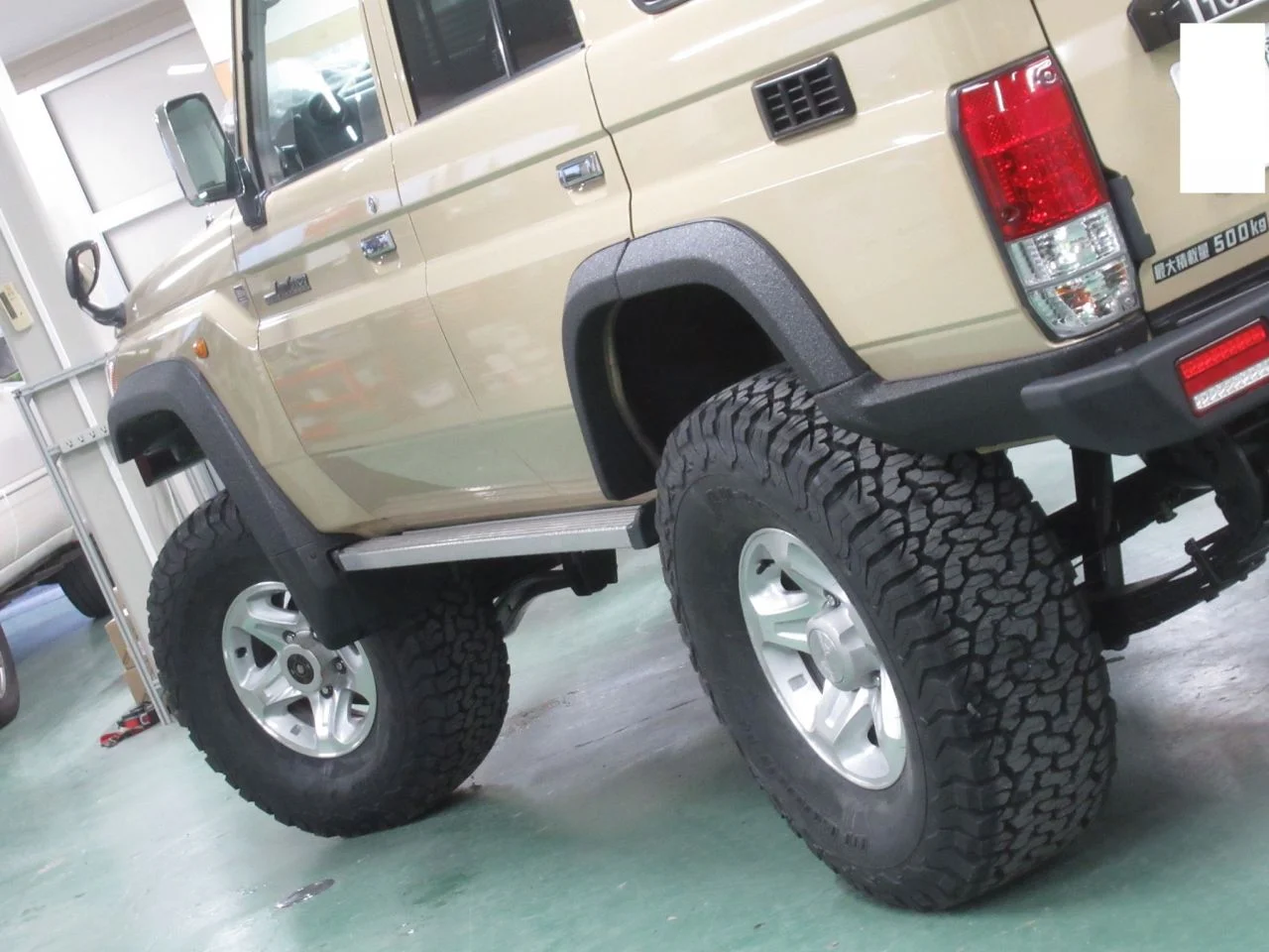

I guess I've never seen factory ones on the wide nose. The rear ends don't look factory??
I think some of the Australian upper trim models 76 series have OEM flares. The VDJ76 GXL model?
Maybe they are from the same company I got the bumper from. They also sell aftermarket flares. Their site that I linked to is in Japanese but you can see the photos of the flares they offer.
factory flares ..
