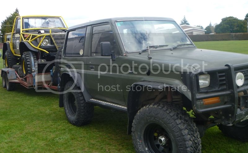

I'd only actually fitted one tyre yesterday :oops: but I finished the rest of them today, the rims have had the centres cut out and flipped to give a bigger offset, the backspace is about 34mm and the offset comes in at around -68. They were my first set of beadlocks I had made up about 8 years ago but somehow my mates daughter seems to have had them longer than I have :crybaby:
