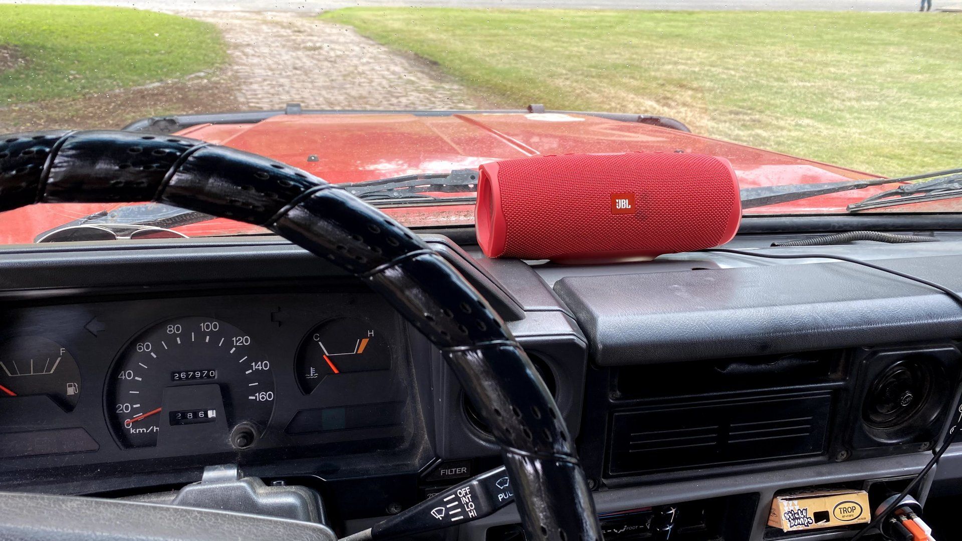

I meannnn this JBL Charge 4 does the job amazingly. $120 for Bluetooth and plenty of loud sound, even to the back of a Troopy with all the windows down. AND it matches the paint 😄
Your troopy must be MUCH quieter than mine, or your JBL is much louder than my UE blue tooth speaker. I went with grey to match the interior.

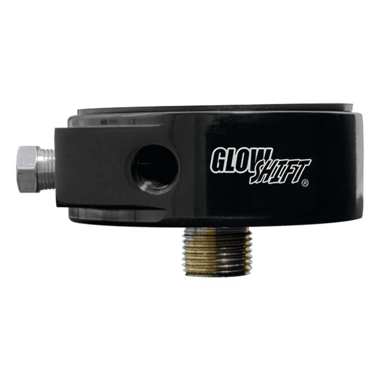

Took care of some engine oil oddities this week on my '89 BJ73: The 3BII motor came to me with the oil sending unit installed into a glowshift sandwich plate (between filter housing and filter). In place of the sender on the engine block was an old analog gauge. Meanwhile, the pressure indicator in the cabin always read low and I never trusted either instrument.
.... wtf
This weekend I got around to replacing the analog gauge with a new 24V sending unit - made in Japan by Sankei. The sandwich plate, old sender, and filter were removed and replaced with Toyota filter 15600-41010 (original big guy, made in Japan).
After the replacements, the pressure indication in the cluster came back to middle positions (between two middle lines) and tracked much better to engine speed. What a relief to know the pressure loss wasn't real and that I now have a dependable indication in the cabin!
