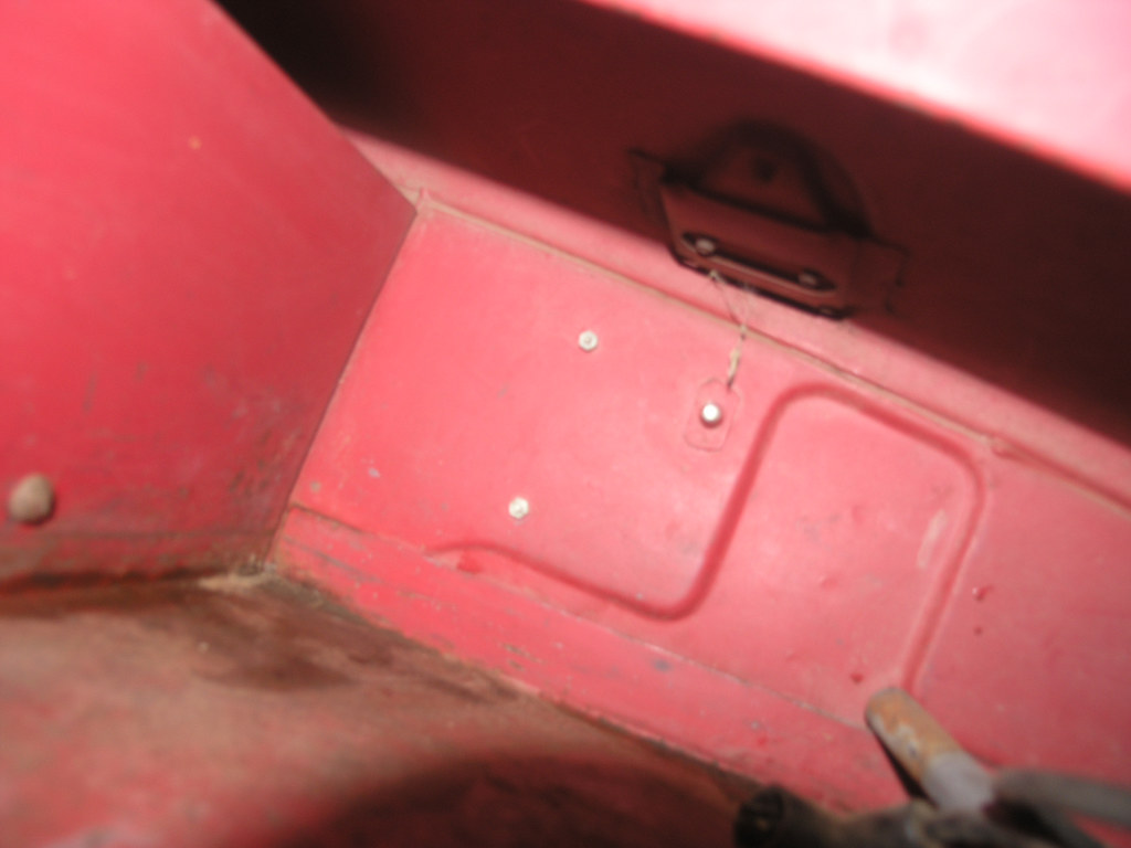

here is the inside of the glove box/
Wiped it down with a wet rag, using a camera with a flash...
kinda looks like solar red, but i do not know what T-332 Seminole red looks like :)

I would feel pretty confident in T-332

yeah i can take a chip of paint from the inner glove box, or a part that was hidden form the sun etc and get it scanned...
Is that method pretty reliable?
I had some paint mixed at a local Dupont store, they used their color camera on a sample I brought in. It was not what I would even call a close match. It was a real disappointment and I'll never do it again. This place is a large volume Dupont dealer and they know what they're doing, the guy who did it wasn't really confident that it would match, I don't think they have had very good results with the color cameras. I would use it as a last resort only.

This lit isn't 100% either but coupled with the other lit it's another piece of the puzzle. I think it's seminole but it could be solar or carnival. I would mix the seminole first though. The hard thing is all these colors are cororna, crown, cruiser and stout but you don't know what is what with the old old stuff.
Hey Destin, if you want to get a scan closer to your original try to pull a kick vent or something and buff the hell out of the paint (on the inside surface) before getting it scanned. Buffing will take off the oxidized/faded paint and expose a more "true" color.
I did this with a kick vent on my 69 to get paint scanned at ace for my floors. Turned out real good I think on the color match...not sure I like the paint though.
