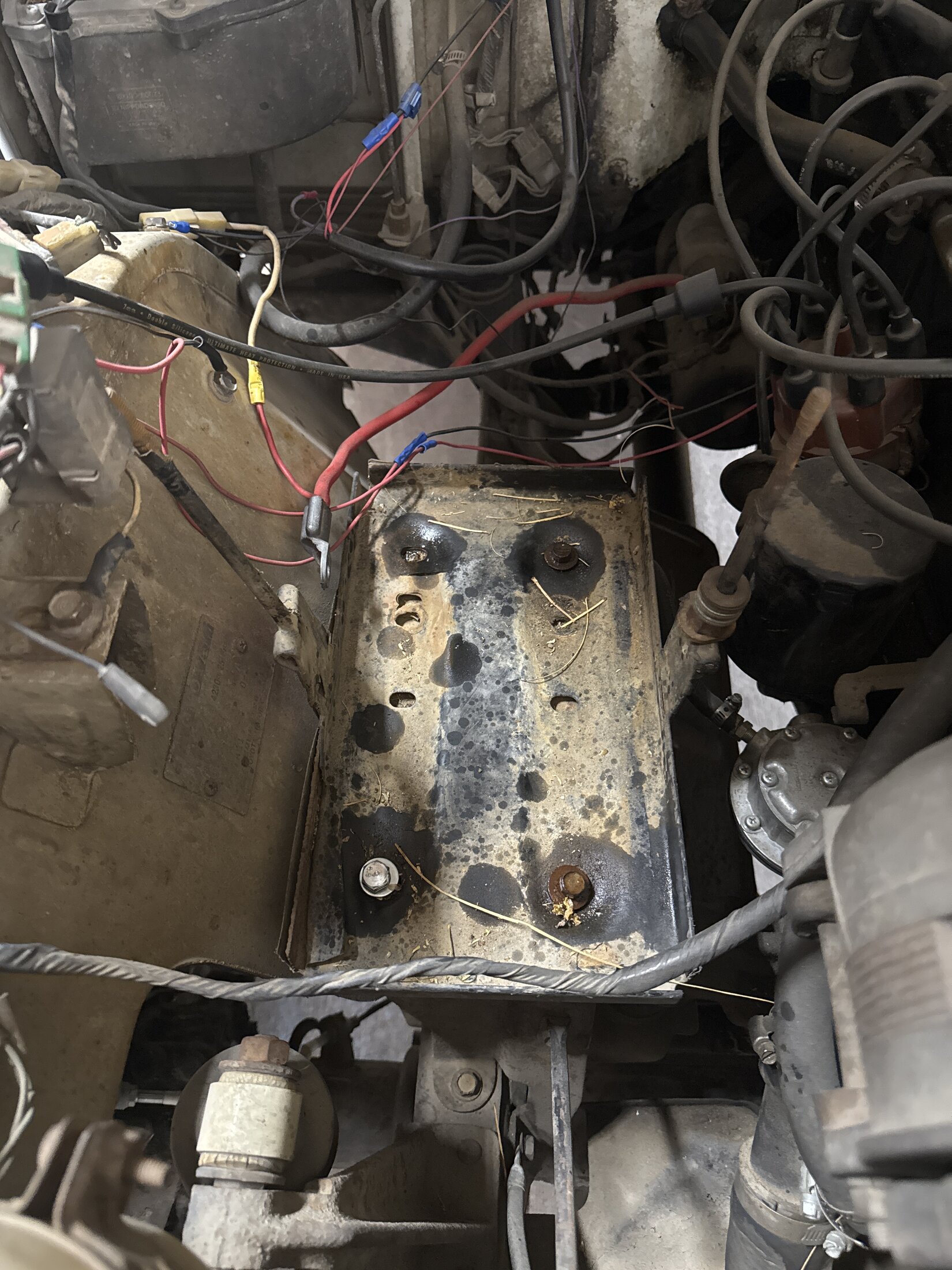

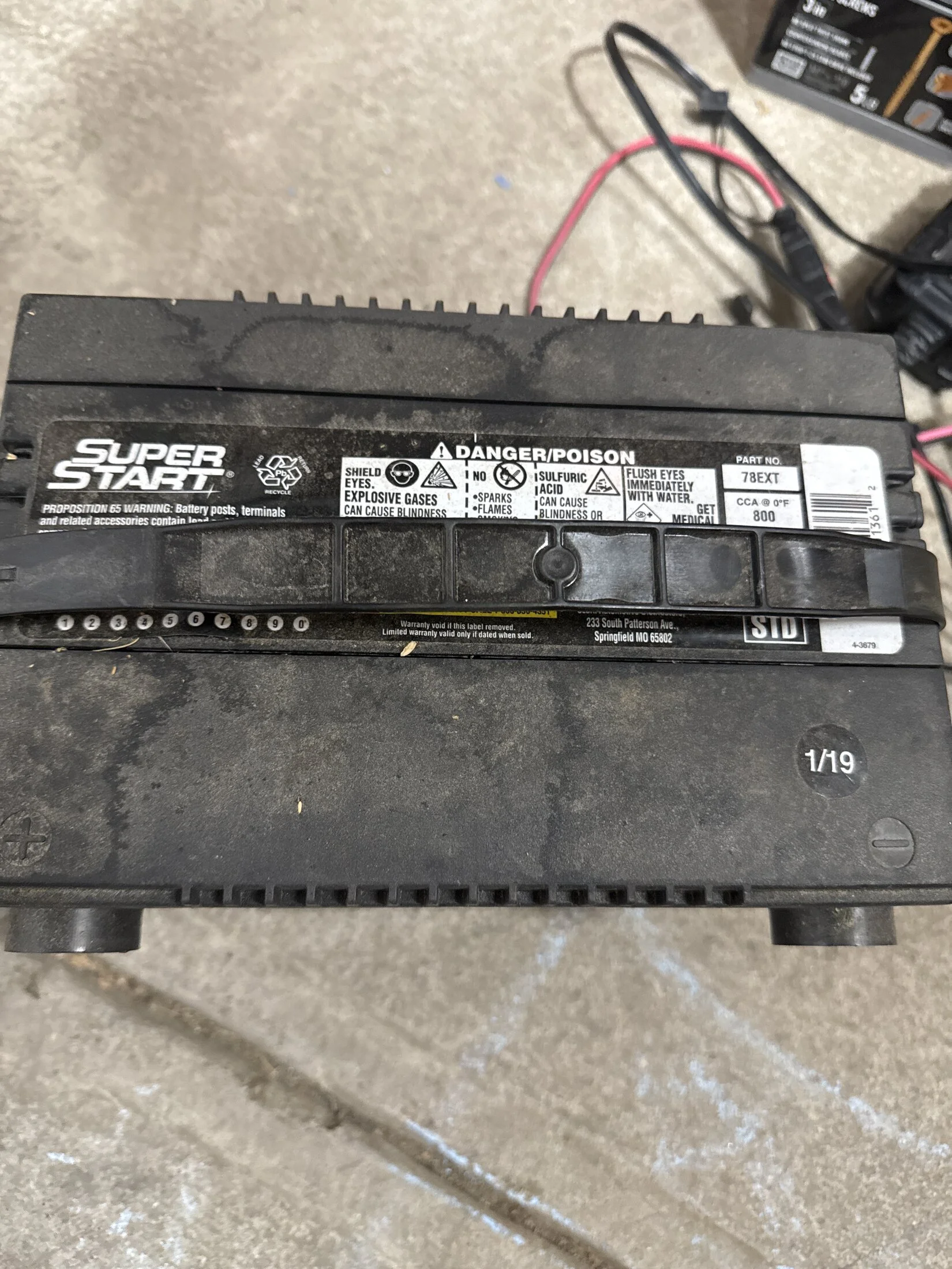

Trying searching these and read nothing definitive. I have a stock 75 fj40 and need a battery. Group 24/24f? Maybe? Thanks in advance. The current battery is too small for the tray and 6 years old. Won’t take a charge at all. New to me cruiser and want to start troubleshooting. Purchased some new terminals also and will make some new cables. Thanks Wes

I’m going with an interstate, just need to know what the group is for the factory battery tray?
You need a board or rubber matt to shield the battery from those bolt heads. Buy the biggest battery that will fit.
Yah thinking about ordering a new tray, maybe the cruiser corps plastic tray or the manafre tray. Haven’t dived deep yet on what’s good.
The Toyota tray and hold down are still available new. I'd go that route unless you want to upgrade battery to a bigger one, which it sounds like you don't.

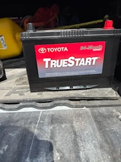

The last (lead acid) battery they sold me at O'Reilley came with a spacer under it? It was a Group 34, if I am reading the receipt correct.

5 months between activity here but bought a new battery for my ‘75 FJ40 and it is a 12 1/4” tray …stock
Group 27 is slightly bigger and more capable than a Group 24, and still fits the FJ40 tray. Interstate at Costco - about $115.
