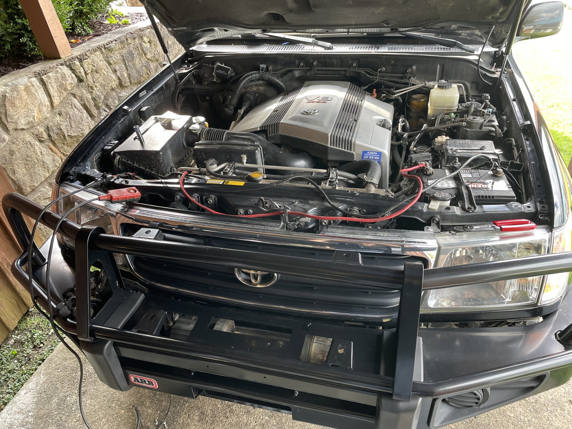

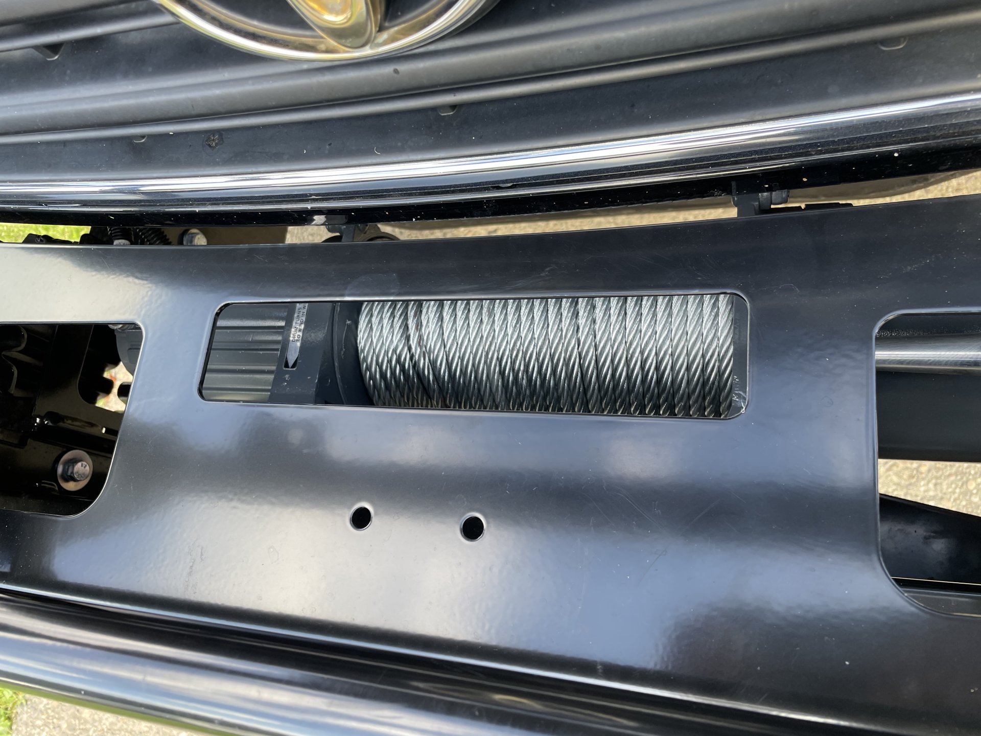

I put an 03+ ARB on my 01 LC. There is a slight gap between the top of the bumper and the fascia under the grill and headlights. It is not visible unless you are looking down on the bumper. Very minor and doesn't look bad at all. I personally prefer the look of 03+ to the 98-02 and would rather have the gap and the new design than no gap and the old design.
Edit: Here's a couple pics I could find from when I mounted my winch.
I installed both before, also swapped fenders between an 03 and pre-03 no difference between the two but then again I do post more basic questions so idk if I am a trustworthy source😂
