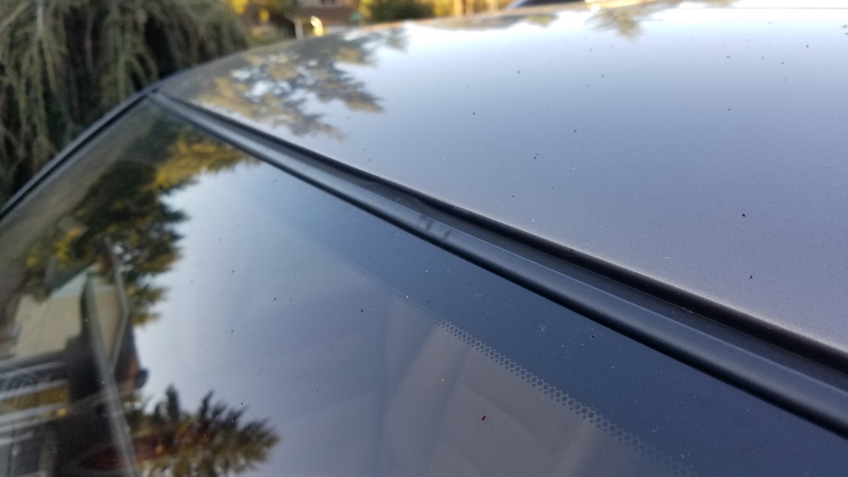

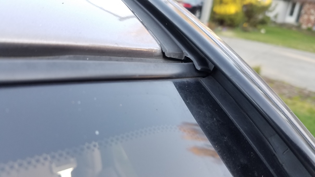

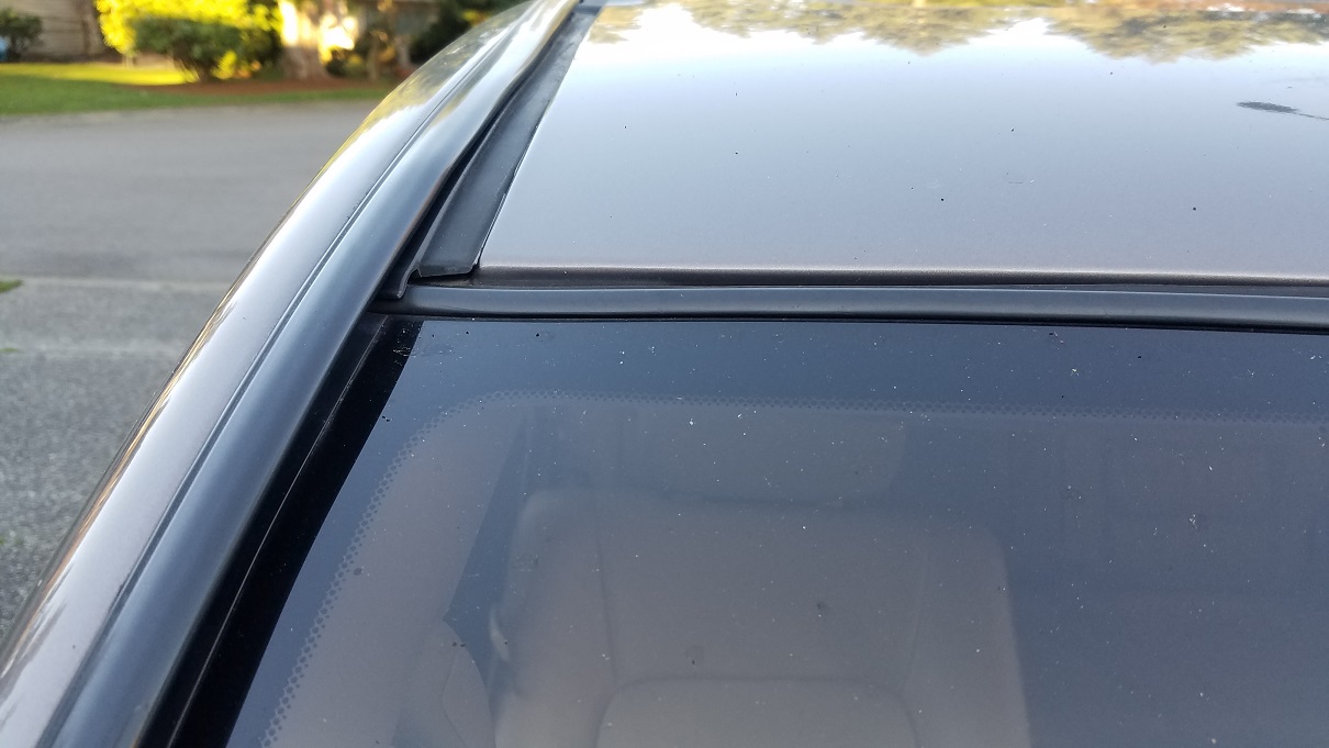

But, with all of the windshield horror stories here, I'm now worried that may be an issue. Mine is definitely aftermarket and I can feel screws under the side molding instead of the OEM rivets. Can the forum gurus take a look at my trim installation and let me know how it looks? It appears I at least have an OEM style upper trim piece rather than the wide molding, and I can't see any signs of paint bubbling anywhere around the edges. But, wondering whether I should call my insurance company and get on to a replacement before there is a larger issue.
It looks like the lip on the rubber roof seal is bent up in a few places where it shouldn't be. I'll bet that's where the water is coming in.
I wondered about those areas too. I'm still a bit confused on how all of the trim actually works, is this top trim actually the waterproofing on that edge. I'd assume the glass is bonded into the frame with sealant underneath?
Following up with more info. I peeled back the side moldings around the windshield and to my surprise, it looks properly installed with rivets, not the screws I was afraid it had. Those moldings are a bit deformed, and I see they are the less expensive ones, so I might replace those just as a matter of course if nothing else. I also used a wooden chopstick to carefully fold back the windshield top trim where it was sticking up in a few places to see if there was any rust or obvious issues showing under them, and it all looked good.

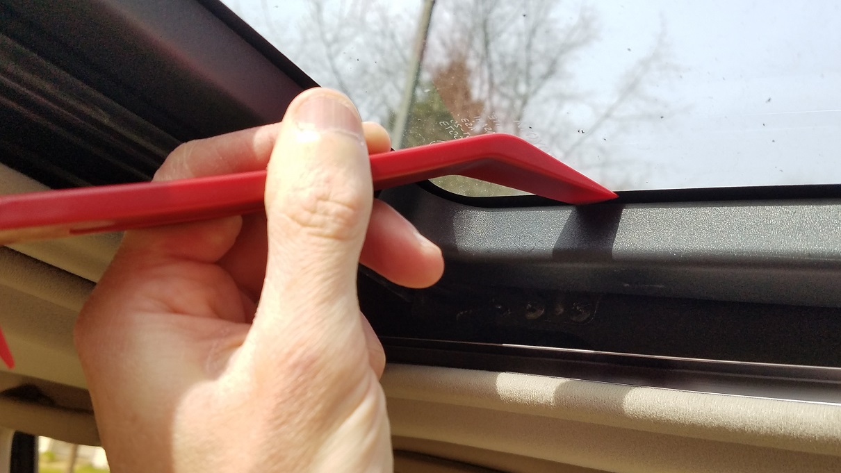

For those who need to clear sunroof drains, especially if your roof is stuck closed like mine is, here is the procedure.

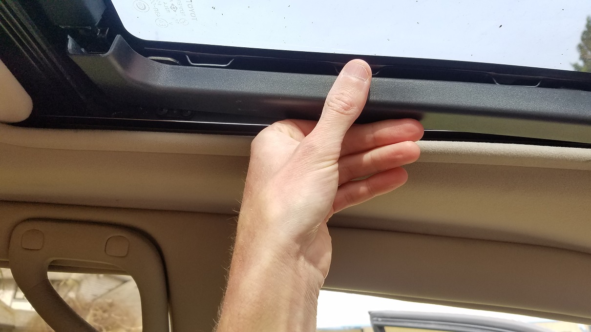

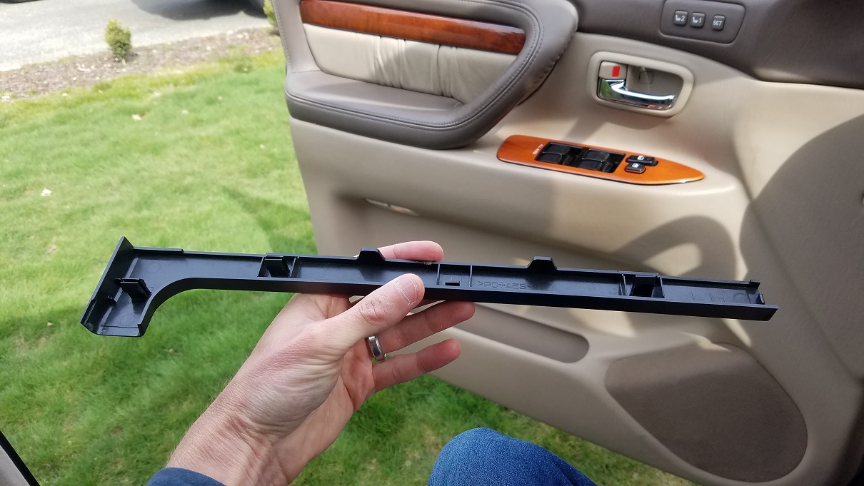

1. Use a pry tool to pry between the glass panel and black plastic side trim on the sunroof. The trim piece pries down toward the floor of the car and pops off easily.
Here is the top side of that trim piece, you can see the location of the 3 clips you are releasing as you pry down.
2. Remove the 4 nuts that attach the glass panel to the track, 2 on each side.
3. Lift the glass panel straight up and off the truck. I was able to easily do this by myself while standing on the running board, but it would be helpful to have someone else standing by to help hand it down to you on the ground.
