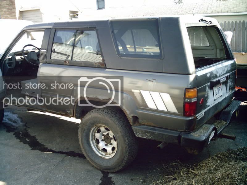

Here are pics of my last 2 runners
Small pic of two things I don't have anymore but loved and have replaced :D
